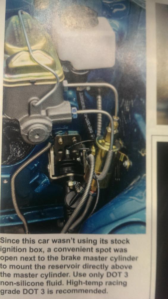

Have you decided if you're happy with the 13/16" MC yet? Just saw this in a mopar muscle issue that showed up today and instantly thought of you, "american powertrain's hydraulic throwout kit" look familiar? Haha

I forgot to mention how the MC worked out didn't I? This is my first V8 standard so I can't make a good comparison but it's definitely not buttery easy like my Dakato but seams about as I would expect out of a performance car but maybe easier. The pedal movement is what's nice, 1"- 1 1/2" of pedal is all it takes to disengage the clutch. I've even shifted without even using the clutch without so much as a hint of any problems although I won't make a habbit of it.
