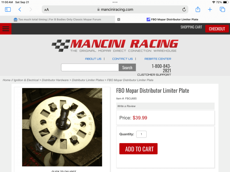

But if your engine can handle 36 degrees OK finding 2 or 3 degrees more centrifugal advance and backing down the initial timing slightly would give your starter a bit of relief. Have you looked inside the distributor? It might have one of these in it.
