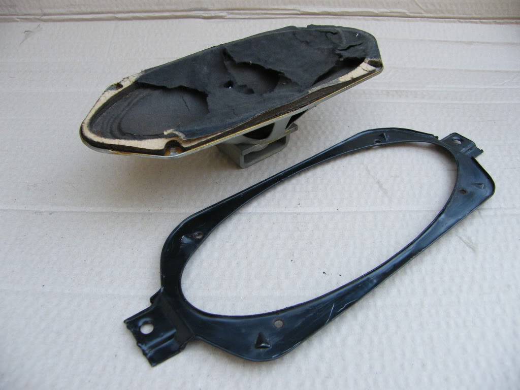

Once we'd realised the old speaker, as removed from the dash, was fitted to a separate mounting plate that we could remove and fit to the new speaker, the installation immediately became easier as we wouldnt have to modify the speaker or the dash
Old speaker with mounting plate
with mounting plate removed

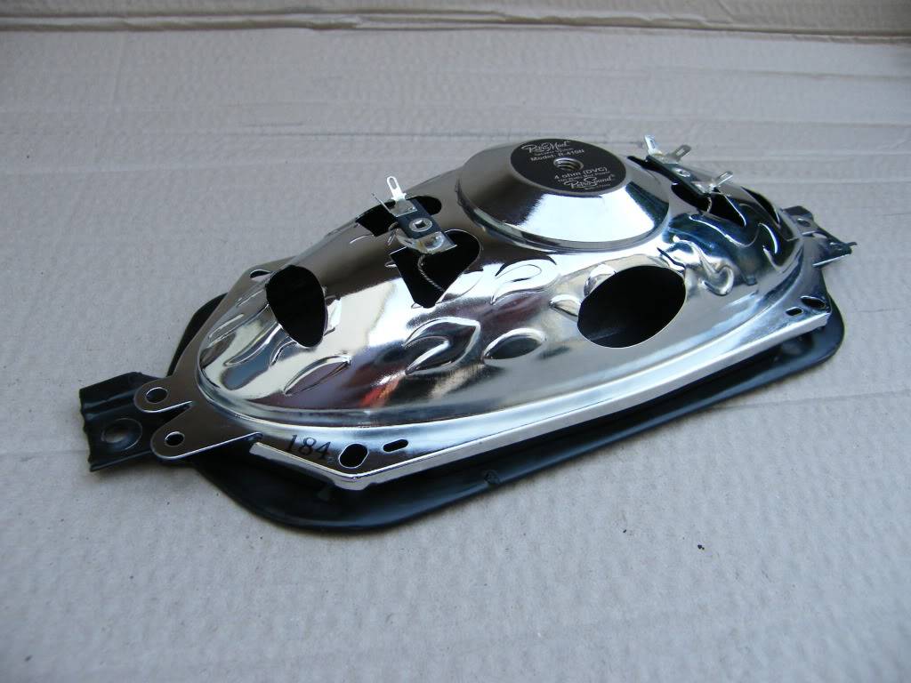

New speaker & old mtg plate

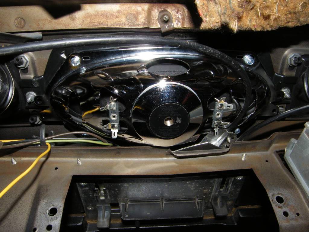

But when it came to fitting it, what should have been a 1/2hr job ended up taking about 3 hours cos there wasnt quite as much room as we though there would be up under the dash. Surprise surprise.
Under dash with old speaker removed
On the face of it, the new speaker looked to be a near-as-dammit straight-swap for the old one, but just where the new one is a bit fatter, it interfered with the little bracket that holds the heater/fan control cable. So after a bit of careful trimming of the nice, shiny, speaker body, we eventually managed to get it to fit.
With extra trimmage. Tho we actually removed quite a bit more, by the time it fitted ok.
Hey presto

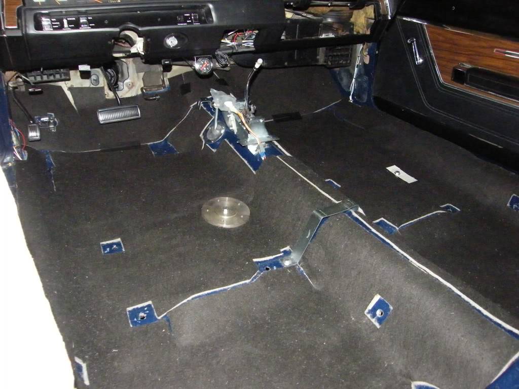

With the speaker & console wiring in place, it was time to look into fitting the carpet. After some thought about whether to use Dynamat or similar we decided to go with a thinish 'underfelt' as a means of adding extra sound proofing.
This was decided after thinking about how the heat that comes up thru the floor on the Polara, causing condensation under its rubber mats, and what would happen to the floor if condensation formed under something like Dynamat.
I know it's supposed to be well stuck down to the floor but with all the contours on these floor pans we figured it would be safer to use something breatheable like an extra layer of underfelt, rather than going with the more fashionable (& heavier & more expensive) Dynamat in case there were any air pockets left under it.

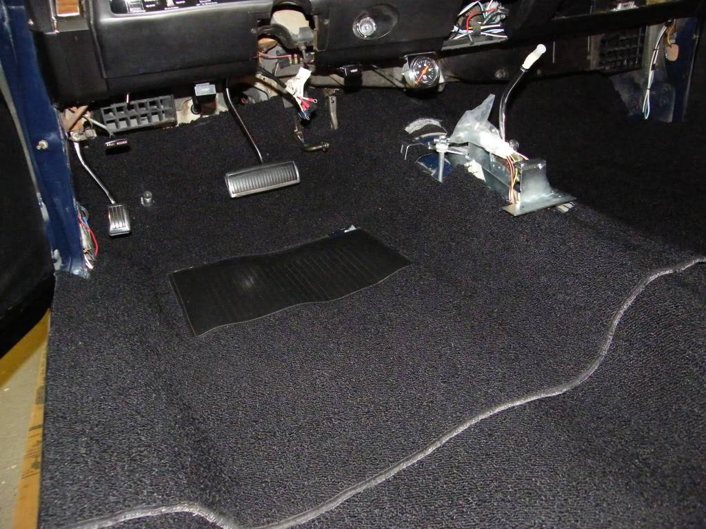

Anyhoo, correct decision or not, we got on & cut the felt as best we could to fit the undulating floorpan. To add a bit of extra sound-proofing under the back seat, we used some of the old carpet that we took out. We've also applied a bit of that felt to the trunk divider while we were at it!
After trawling the Mopar forums to see what was best, we settled on a carpet from Motor Parts South, as they had a reputation for fitting best, having the most generous cut in the sill & firewall areas and if you wanted to pay extra for shipping you could have it shipped flat, so as not to disturb the pre-formed shape.
We didnt have it shipped flat but it was loosely rolled, and came with separate jute backing.
First impressions are yes there's plenty of material (unlike other makes I've read about like ACC) but it is a bit baggy in places, esp over the tunnel, so we may add a bit more felt under there.

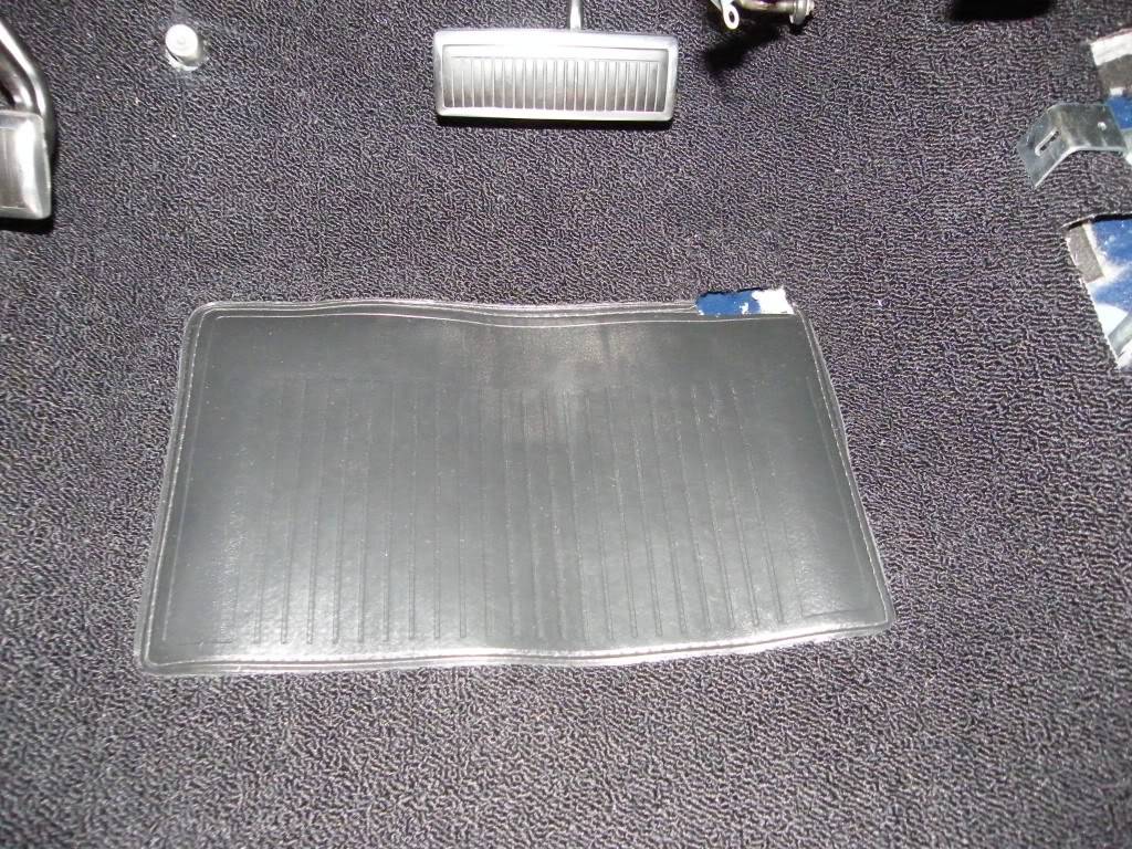

As there's no pre-cut holes for anything, it's a bit of a fiddle trying to get the heel pad position correct in relation to the pedal and the dimmer switch but after checking as best we could to find its correct position and also making sure the humps & bumps in the floor fitted the shape of the carpet, we took the plunge and got at it with the utility knife.
Havent cut any seat or seatbelt holes yet, but as soon as we get the front seats in I'm sure the loose areas will be be held a bit flatter and tighter. Then we can cut the carpet for the sill plates.

NB - the odd bits of metal bolted to the floor (1 round & 1 rectangular) were just used to hold the felt in position while we fiddled with the carpet.

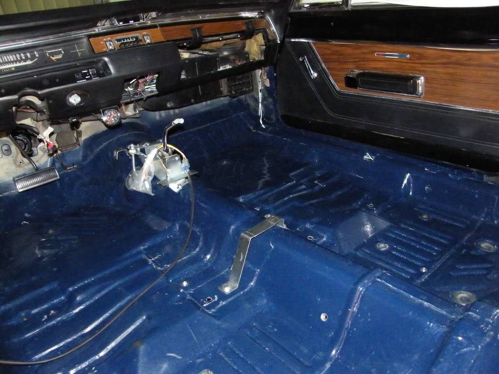

Floor cleaned....
Trial-fit of jute backing...
Underfelt....
With jute backing in position.....

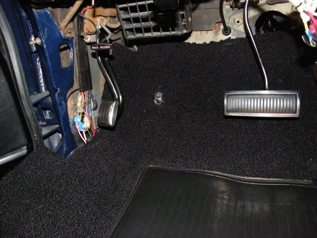

Our attempt to make the switch work without getting caught up with the carpet. Not supposed to use the grommet, apparently, as they werent fitted originally.
Checked out as best we could where the hole should be for the pedal and saw pics of original carpets with the hole completely within the heel pad, completely in front of, and half-on / half-off. This is where ours ended up, having tried to match the bumps in the carpet with those in the floor.
Not something we thought was going to be complicated or important before we started, but as you start to look into how something should be, you get a bit caught up in trying to do it the proper way.. or at least we seem to.
Reinforced the cut-out with some thin rubber stuck to the back...
Also stuck a bit on the back of the switch hole...

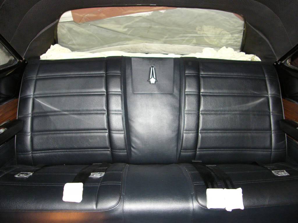

Having struggled a week earlier to get the rear seat in, it must have been that extra carpet we tried to use as insulation under the seat base that was stopping it going in, cos once we'd removed the jammed-in seat base (one side was stuck, the other wouldnt go in at all), then took the extra carpet out, we got the seat base in relatively easy.
So with the arm rest fitted, that's the rear of the interior finished.
Seat fits nice & snug over the tunnel now

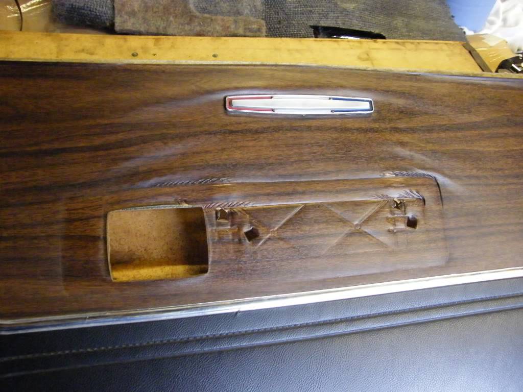

Next obstacle is to transfer the emblem that's on our original panels to the new ones. Quite a common theme with these resto panels & seat covers; having to reuse some existing hardware, so no great surprise, but these badges are riveted!
Stu's emailed Legendary so we'll see what advice the have.... if any... before we start grinding the old rivets off
Driver's side cleaned up, lubed & ready for new panel.... but not until we've refitted the old emblem:
pre-punched holes just about visible, but way out of position (too low)
