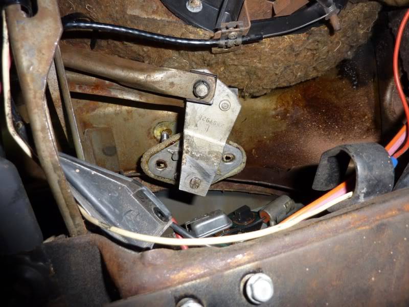

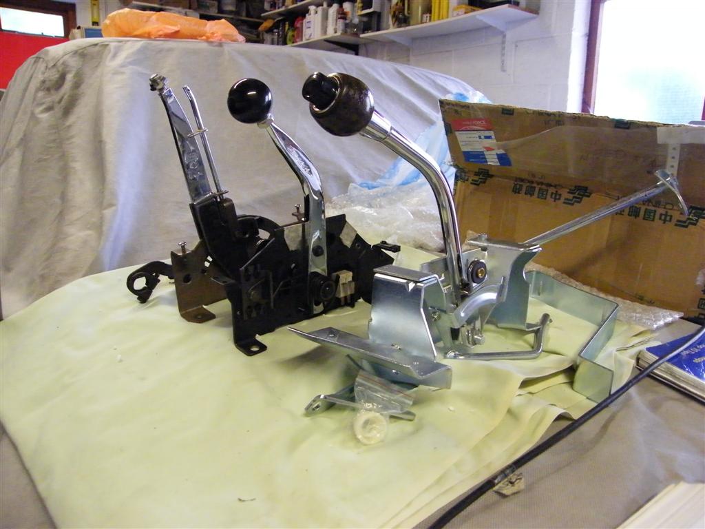

Having decided to remove the engine & trans for a rebuild, and also to fit a centre console, we needed to establish a position for the shifter & console mounting brackets while the trans was in place. Dunno if the car ever had a console but we'd fancied having one for quite some time, so gathered up some new & some used parts to make one up.
We did think of using an aftermarket shifter, and bought a Hurst thingumy (sorry, cant remember which model!) that we thought would fit with the stock console. Then got a chance to buy an unused stock shifter from a friend, so decided to go with that initially. If we find it's too hit'n'miss (compared to 'slap-stick' or ratchet type shifters), we'll modify it or try the Hurst.
Steering box needed a rebuild too (leaking) so got the column disconnected from the box so it could be removed.
Although we left the engine & trans in place while we mocked up the shifter bracket positions, we got all the engine ancillaries removed so it was ready for yanking once we were happy with those bracket positions.
Bit of a mess... :eek:

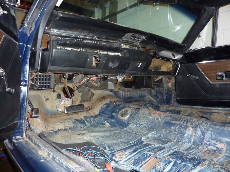

Floor shows signs of water damage from years of leaky wiper pivot seals. Bought the seals a while ago from Laysons :icon_blackeye: so bit the bullet and set about fitting them. Much easier without the seats in!
Wiper pivot before removal
New seal fitted to pivot
Floor stripped.... well, loose bits removed!

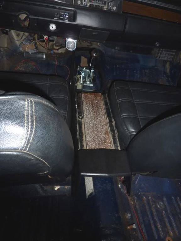

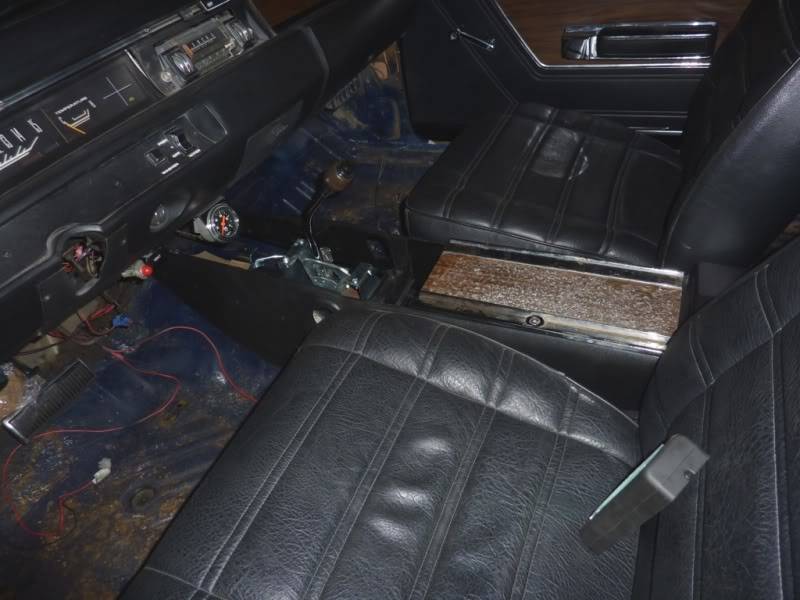

Refitted the seats temporarily to get a position for the console & shifter brackets. We realised we were a bracket short too; the one that bolts to the tailshaft and supports the linkages, so fabricated one at work as we couldnt find the right one new or used. Hope it works :icon_eek:

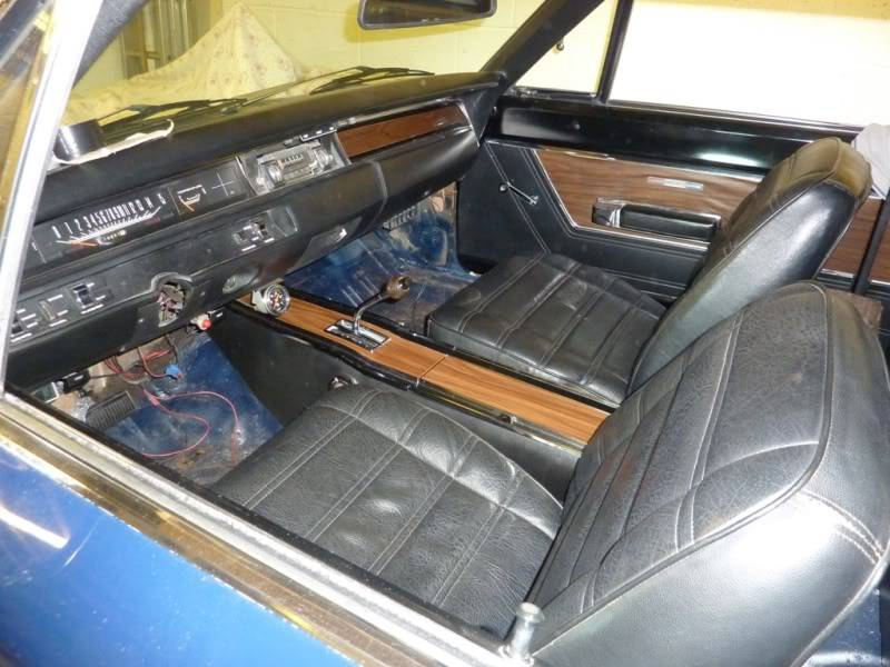

Quick word about the console. We got a new console body from BE&A Parts and a bunch of scruffy used parts for nothing from a friend who bought them off ebay but was happy to let us have them for nothing as he later found a better set :icon_thumleft:
The shiny bits polished up quite well and the painted areas responded well to a new lick of paint. Dunno if you have 'Fablon' over there (it may well be a US product for all I know?) - woodgrain on a vinyl roll? A few £ for a couple of yards of the stuff, and that's the console restored for next to nothing.

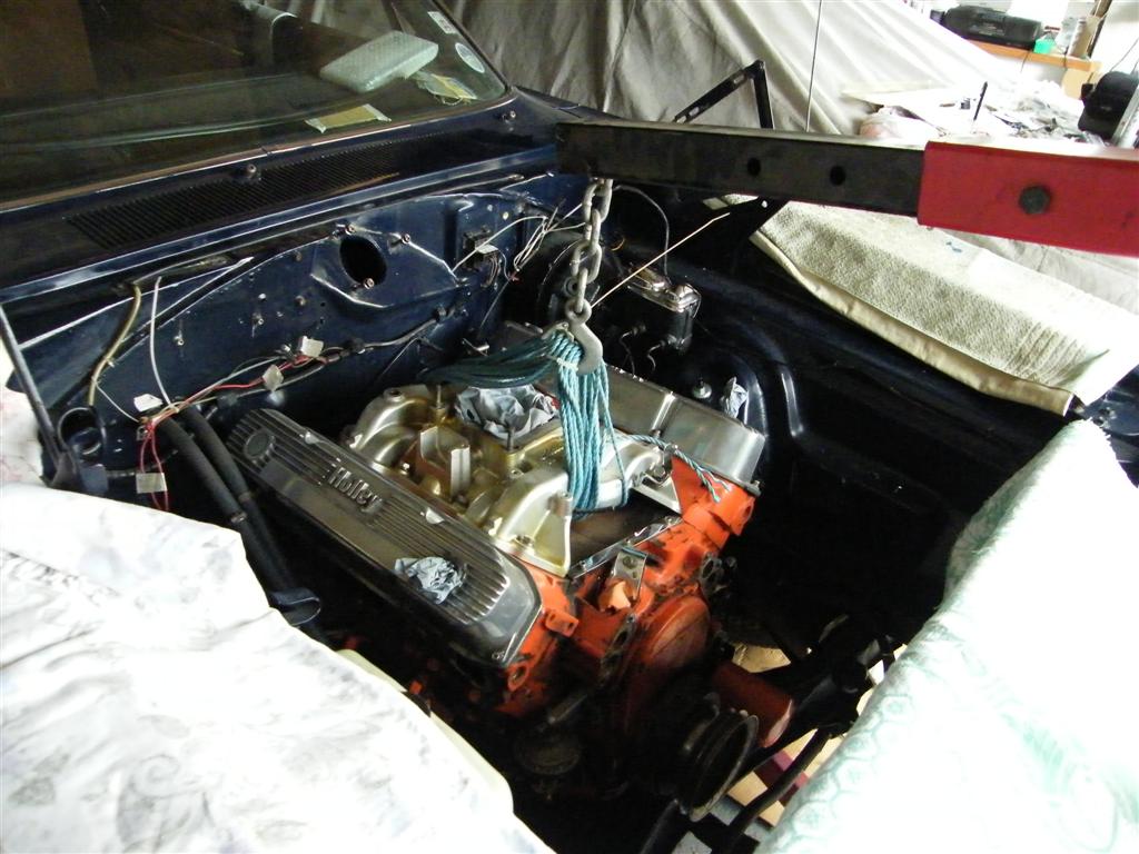

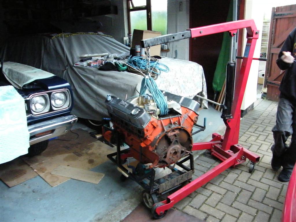

Next came the big day, once we'd scrounged a hoist from a friend, we were all set to get the engine out!
Couldn't find the right kind of lifting hook/eye, so made do with a strong nylon rope wound around the hoist's hook. Happy that it was strong enough, just a bit touch & go with the length as we were a bit tight on headroom under the garage door :eusa_eh:

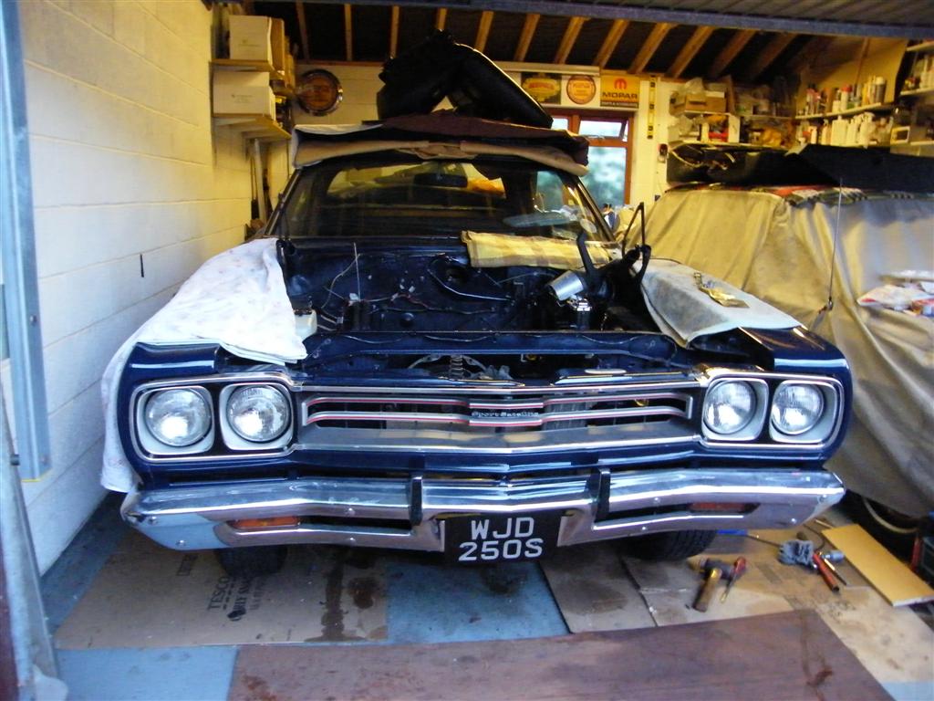

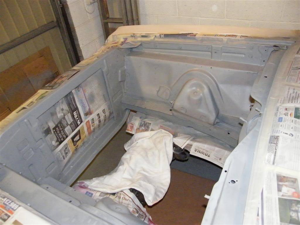

Getting bang up to date, we've now rubbed down & primered the engine bay, almost ready for a fresh coat or three of blue.
Not having access to any proper spraying equipment (or technique! :icon_sad:) we found someone who's set up for mobile spraying and is willing to come to the garage and spray the engine bay without moving the car (front suspension is still disconnected). All we need to do is all the prep....
No real nasty areas in there, the main reason for the rub-down & repaint was to remove the hammer-finish paint ('Hammerite') that had been on the car for the last 30 years or so!
Bumper off to reduce amount of masking needed prior to spraying...
After 1 coat of (aerosol) primer
Feels like we're getting somewhere now!! :grin:

you guys have done alot of work. i like how that console turned out,it almost looks like you cut out a piece of wood ,polished it and then installed.
Thanks guys!
Yes, we're pretty pleased how the console has worked out ok so far, we've still a few odds'n'ends to get for it to make it complete (wiring for the lights, & carpet trim mainly) so we'll have to wait & see how it looks when the interior's back together.
We figured the vinyl woodgrain may be a little different to the original pattern but as we're getting new door panels, and theyre unlikely to match the original woodgrain on the dash, it wont matter too much if we introduce another slightly different shade/pattern on the console!
Not ideal, I know! We borrowed the hoist and only realised it didnt have a chain or any kind of lifting eye to attach to the manifold on the day we'd planned to remove the engine, so had to make do with what we could get hold of :head_smack:
Tho I'll bet the strength of that nylon rope folded that many times is more than a match for a piece of old chain....
We'll get the right kit for the install tho :cool:

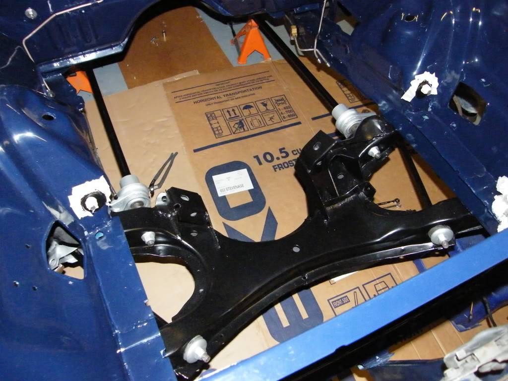

Engine bay's all painted now and have started putting a few bits back on!! :eek:ccasion18:

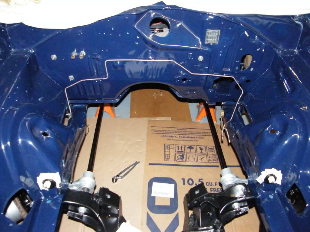

We ordered a few new brake parts from Inlinetubes but thought we'd take the plunge and make up the long part that goes across the bulkhead, rather than paying silly money on shipping for a part that weighs next to nothing but would have to be packed in a 5ft x 2ft (ish) box
This was our (well, my brother's :icon_winkle:) 1st ever attempt at making brake lines so I think it's come out pretty good all things considered! Used a few pics off the 'net to get what we thought was the correct route, but modified it slightly so it's routed around, and not across the access holes in the inner wings (sorry, fenders)
I'm sure there are areas that arent correct for a proper resto (paint & plating finishes etc) but were happy to get it as near as we can with what's easily available and we can use (.... so as long at it comes in a paint tin or can be plated by contacts thru our work places) we'll go with that option!
Plus, we havent dismantled all the front suspension parts so have chosen to paint the LCA's, for example, rather than having the plated.

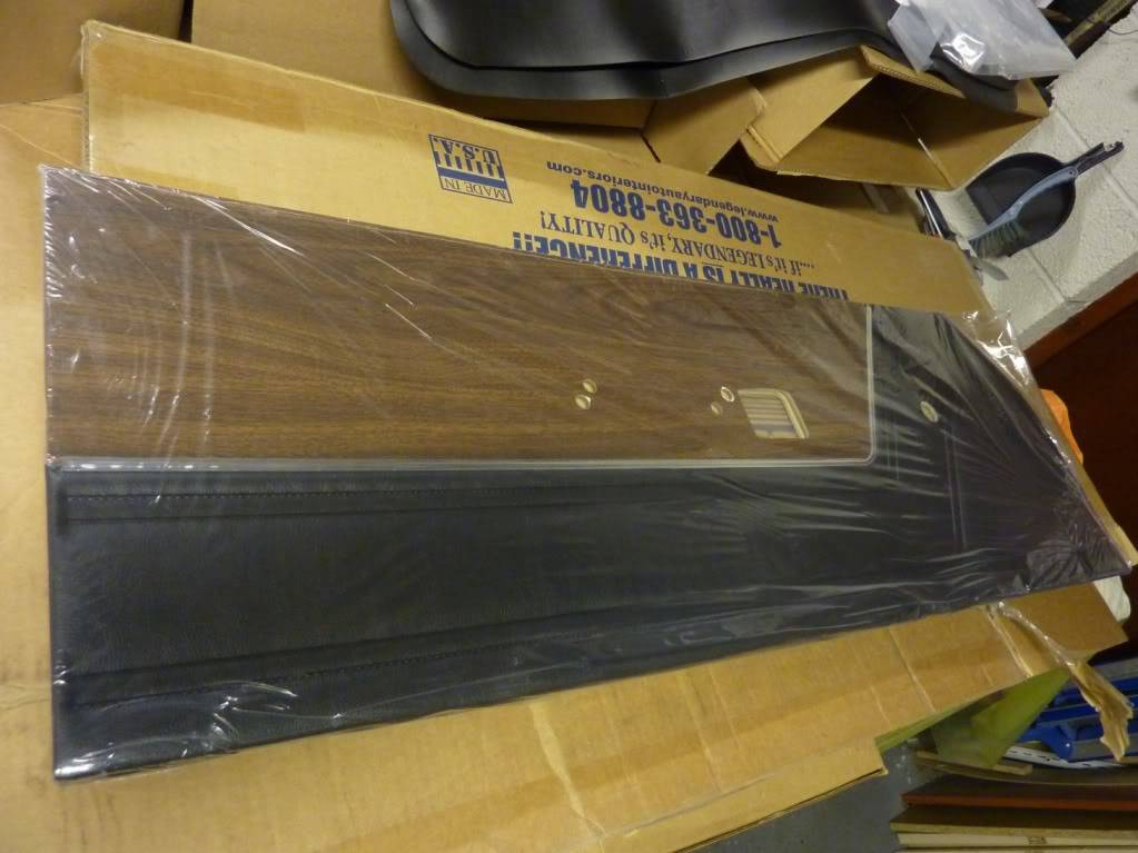

We also received some new parts just before christmas, from 440source, Bouchillon, Legendary & Mancini, and a carpet from Motor Parts South.

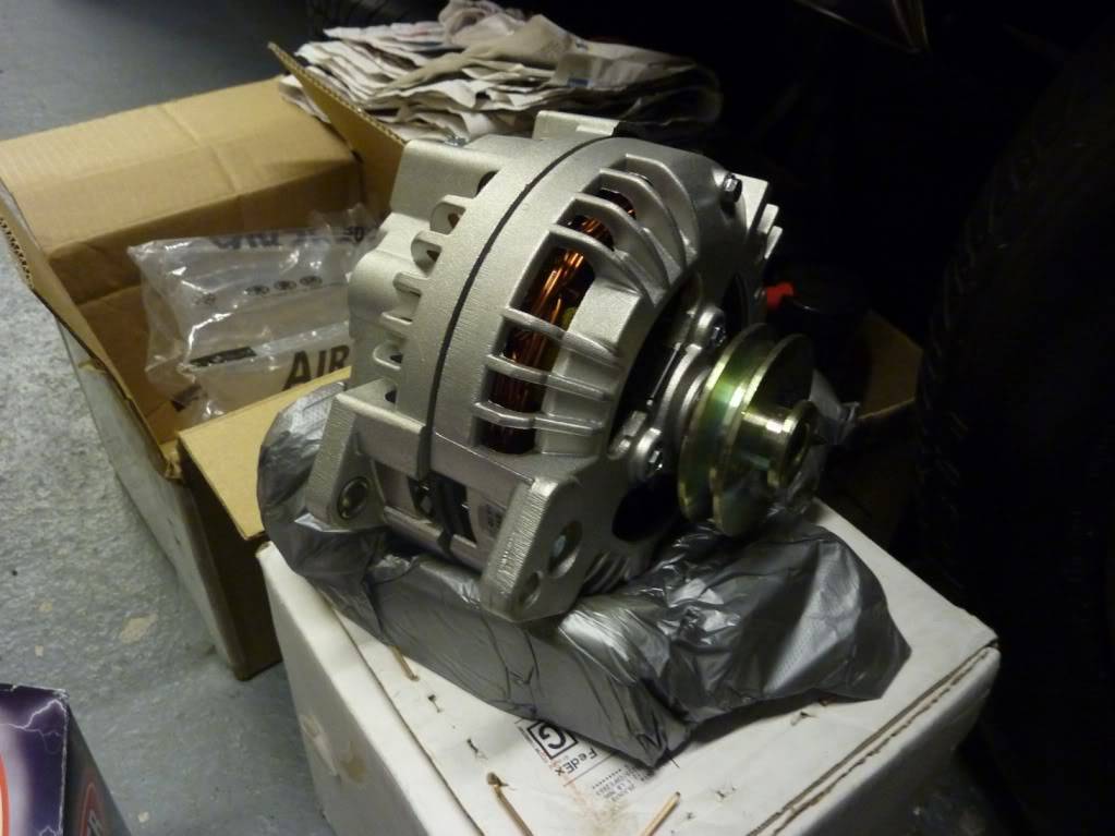

New alternator from Bouchillon - not as original looking as we were led to believe from their website, but as the car's never going to be 100% original or original looking, we'll manage with this one for now, thanks!

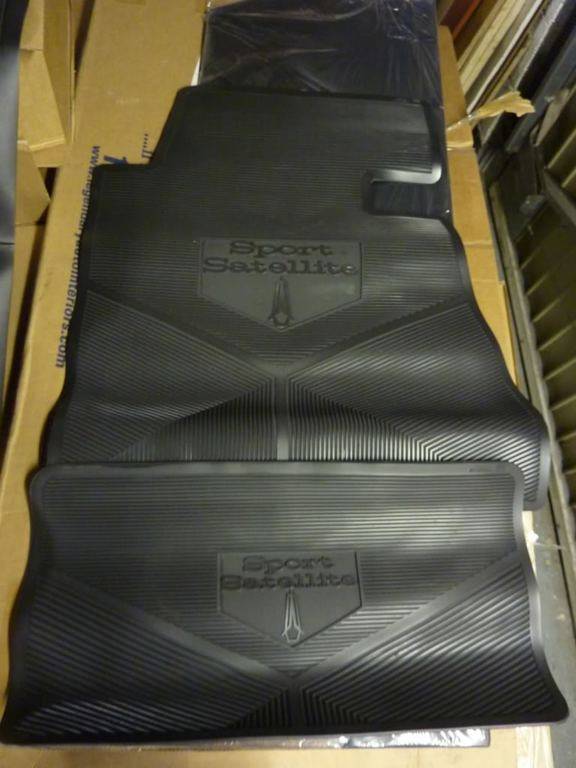

Plus these mats - the only ones we could find with the correct 69 Sport Satellite logo, as opposed to the trendier 68 logo :icon_cool:

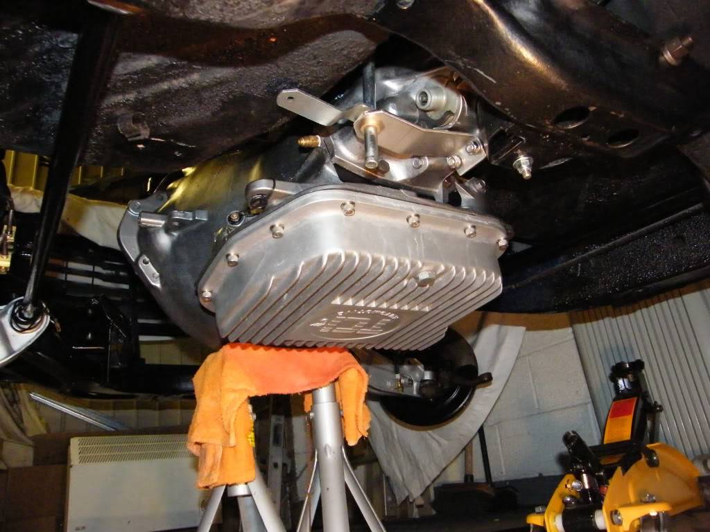

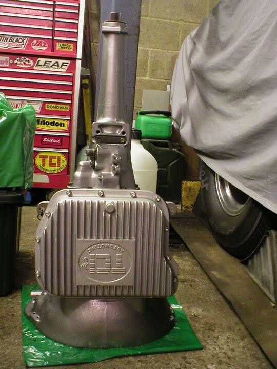

rebuilt trans, with TCI sump, as an attempt to curb the leaks once & for all!
Trans in situ, temporarily....
