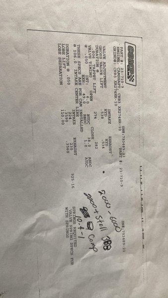

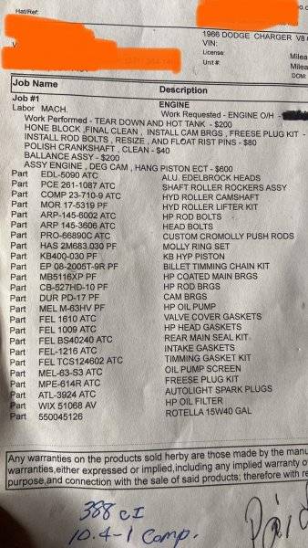

I have a mopar 383 with edelbrock e street heads with springs changed and thicker push rods were installed I have a cam and it’s a roller not flat. I will include my cam card and build sheet. Just would like some opinions on we’re a safe limit will be. Our if anyone has a similar build were is yours at? I do also have the complete Holley sniper setup Thanks in advance
6500 would be fine. Doesn't mean you have to go there if you don't want to.
Thanks, ya I’m definitely not trying to hurt her I only have 1300 miles on it so far. Maybe I will just put it at 6000. I just didn’t wanna over rev it when I do a burn out at or leaving a car show.
I would set your rev limiter at 6500, and plan to shift at 6000-6200, and experiment from there. (My solid lifter 440 will happily rev to 6500, but it runs just as quick shifted at 5900 as 6200)
And I would try very hard NOT to hit the rev limiter in the burnout box.
And there's nothing wrong with setting it lower for safety reasons.
