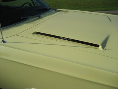

Hey guys I am looking at the same thing, finishing up putting the 2087 top end kit on and I don't think I will be able to use the mopar performance air cleaner I bought to sit on top of the 750 holley. I was looking at fiiberglass hoods but not sure I want to do that. Where does one find the low drop bases? my hood offers a maybe a little room on the 68 GTX but not much
