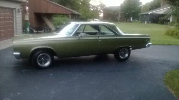

3800 lb. SS springs, 65 Belvedere. Pretty sure these were made in Mexico. Sits level. Car has the spare tire and jack in the trunk, battery in the stock location.
View attachment 575585 View attachment 575586

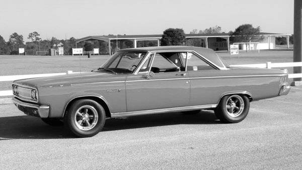

Good looking ride. I think you maybe about 1 to 1 1/2 inches higher than my car in rear. I am also looking for height and not for racing. What's your thought on 3600 lb springs and both being right side springs so car sets level.

View attachment 576344 View attachment 576345
Mine measures about 25 inches from the bottom of the lip to the ground with the 3800 lb springs. Left-P3690455 Right-P3690454 Sits level. I would assume that the ride height would be slightly lower with a spring rated less at 3600 lb. Mine always goes straight when you hammer it, don’t know what it would do with 2 right side springs, just something I was considering for my 64. I like the way my 65 sits, probably a lot of people don’t.
