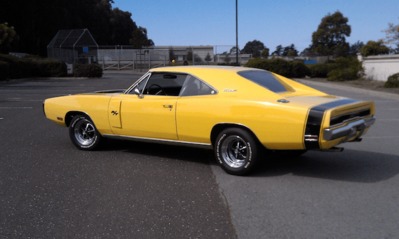

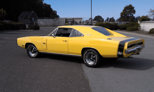

Ok I have my dumb hat on. If you use two rights not good for track but ok for street. So to have good ss springs for the street you need a 3800 on one and 3200 on the other (example only) just trying to figure it all out. My car suppose to have as springs on it but it sets level and I'm not finding any type of id on them.
The right side in a set (456 / 457 as an example) has 2 extra half leafs so the right sits higher. If you want to keep it level, order two of the left side springs. Personally I like the canted stance plus it is designed to work that way.
