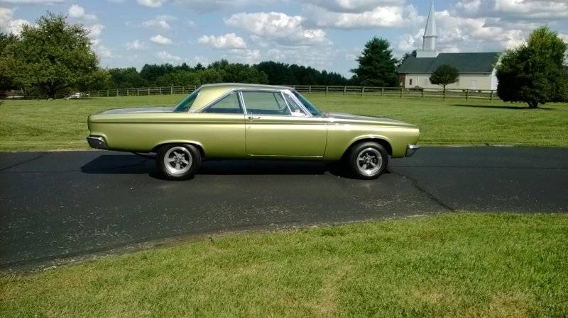

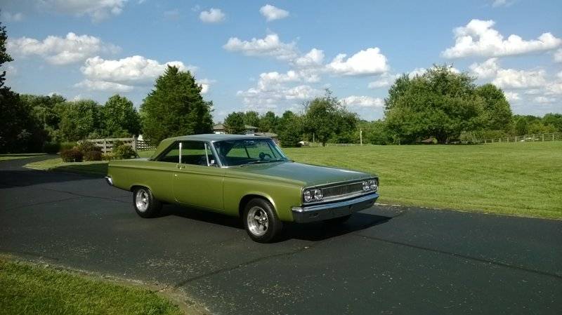

Haven't been on site all summer .Finally made decision on rear leaf springs. Discussed with Bob Mosher. Mopar guy on west coast. He told me about 2 companies. First one he said the springs were more for drag racing. The other company called ESPO Springs and n Things. I contacted ESPO and had a set of springs made for the Coronet specifically . Every thing fits in stock position same hangers ect. I had springs arched 2 inches over stock. Very pleased. Rides good.

More pics please what a sweet stance. Great job on your ride.
