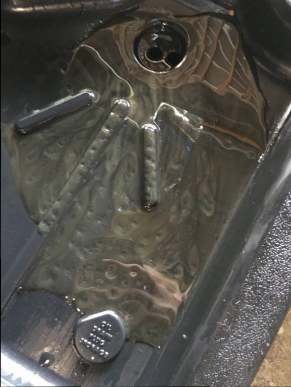

I'm, getting tons of chatter from my 3.55 Sure Grip rear end. I sucked out the old oil, put in new LSD Additive and replaced the oil. Took it for a spin, did my figure 8's and no change in the chatter.
Any other suggestions before I take it up to Randy's Ring and Pinion to get it rebuilt?
Here is the oil that came out of it.

Metal's there. It's not worth driving. It's going bad & needs mechanical repair. If it's a clutch type - just replace it.

Probably already know this, but...be sure to do a good cleaning inside the axle housing, to get that powdered metal out.
