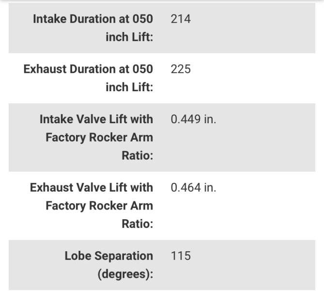

#5 I wrote in post 13 that my heads order was canceled.
So choice of heads are up again on the table. :thumbsup:
Cam selection specs are still a maze to me but the replies here are awesome.
Learning a lot.

I really like the Summit 6401cam in my 440. Just under 10.1 compression. I've ran 89 octane with no problems. Normally run 92 octane. Does require a stiffer spring and looser converter. I'm running a stock converter with 3.23 gears and it responds great. There's also the milder 6400.
Summit 6401
Basic Operating RPM Range:
2,000-5,500
Intake Duration at 050 inch Lift:
224
Exhaust Duration at 050 inch Lift:
234
224 int./234 exh.
Advertised Intake Duration:
298
Advertised Exhaust Duration:
303
Advertised Duration:
298 int./303 exh.
Intake Valve Lift with Factory Rocker Arm Ratio:
0.466 in.
Exhaust Valve Lift with Factory Rocker Arm Ratio:
0.488 in.
0.466 int./0.488 exh.
Lobe Separation (degrees):
114
Summit Racing SUM-6401 Summit Racing™ Classic Camshafts | Summit Racing
