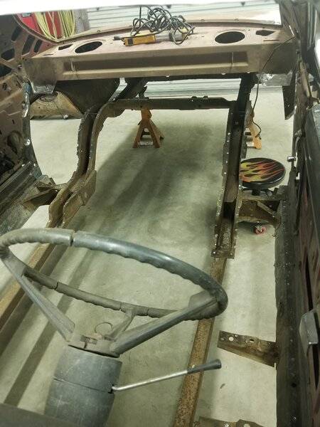

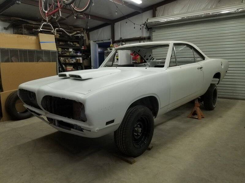

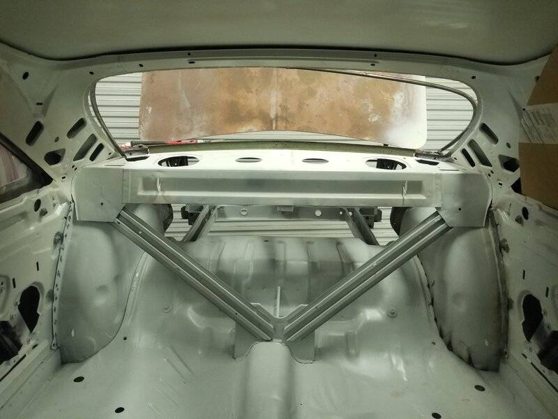

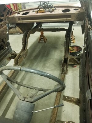

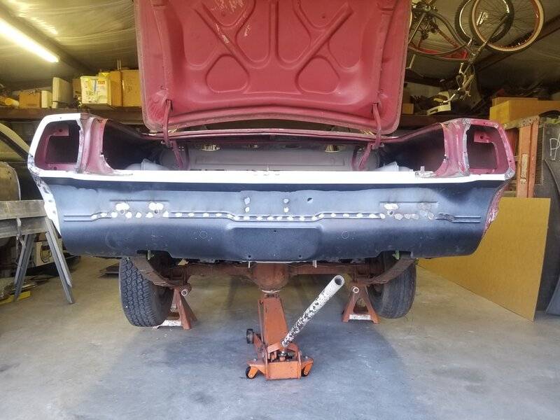

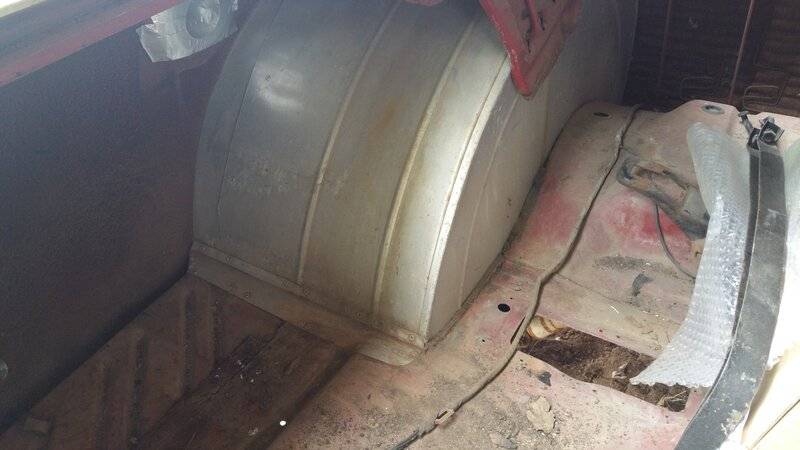

I payed $300 for this as a stripped roller. Not a XP29 rather a BH23 but it was crudely hack minitubbed with pop rivets, aluminum, and silicone. Booger **** welded relocators, and required everything sheetmetalwise from the firewall pinchweld, back to and including the rear valance had to be replaced because of butchery, and rust, or just missing like the seat braces, and wheel houses that were mercilessly cut out.
Also had to convert a slant sux K frame that was under there to a V8 K frame since it's what I had. Had to find a 69 only non butchered rallye dash frame, a drivetrain, decent front brakes, rims, decent rear axle, driveshaft, all the seats, roof bows, all the wiring, gages, console and brackets, bumper brackets, grilles, front and rear window trim, taillights, hood, header, hood hinges, fenders, front valance, and on and on. Plus all the repop stuff. MoPars are not cheap to restore. Not even A bodies. Needed New wheel houses, LH inner fender apron, lower radiator support, the whole nose sheetmetal and on and on.
Still have to hang quarter skins and trunk drops on it Thank God I have a shop I work out of in my back yard, and the know how to fabricate, weld, modify whatever I need, otherwise it would be junk. This charger having the *** end hacked off it, there is no frame of reference to measure from to put it back together again. Unless you have another of the same car to take accurate measurements from to make sure all the pieces are lined up before you start welding.
Pix below are of the same car currently shown in my avatar. Nothing special really. A 318 auto on the floor, A01 light package. It's a blank canvas for how my son and I want it to be. There was a lot of work in between those strip down pix. I am about 2 years in on this one, and estimate several more years on it as I can get to it a few hours at a time a few days a week .

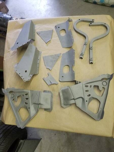

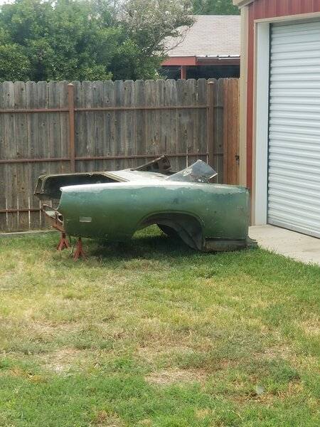

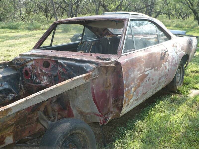

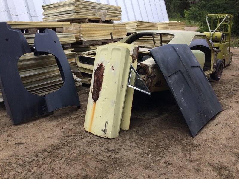

Note the green turd I bought to drill apart to get replacement structural pieces out of to replace the ones on mine that were crudely hacked out with a torch for minitubs. These are some of the pieces that you cant buy new, since nobody repops them. You reuse off your project, or if butchered or missing like mine were, you get a hacked up donor and get to drilling.
Work and family slow things down a lot. With things this far off in bad condition, you have to have a plan, the madd skillz, the equipment and a dedicated place to utilize the skillz, and the cash to do it. Or at the very least the cash to take it to the AMD service center and pay to have them re skin it. I bet they have all the measurements archived. And at the very least the mental fortitude to stick with it. I say this because people give up on projects like this because they get overwhelmed.

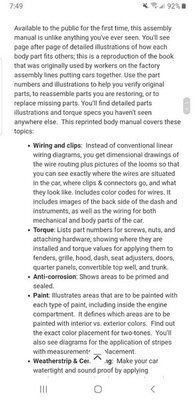

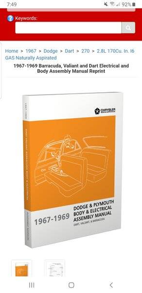

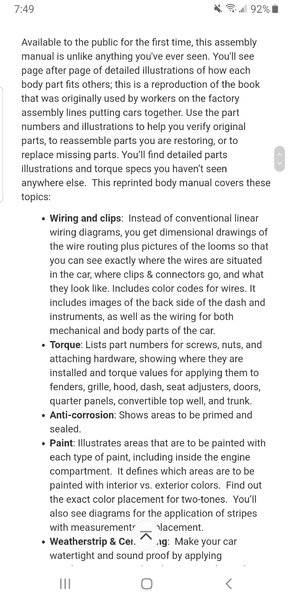

Better have a photographic memory, and take pix. Take lots of pix. Buy a reprint of the factory assembly manual from Faxon. Not the service manuals. The "assembly manual" these were used on the assembly lines when these were built. This car was junk, it wasnt an H or M code car, so it's not particularly valuable. However I dont count my labor because this is enjoyable for me, kinda like people who's hobby is model ship building with individual pieces of wood, and taking years to build one.
I work in the aviation industry as a sheetmetal structural mechanic, so I have access to metal brakes, hydraulic shears, and english wheels. Believe me, its all precision measuring, precision holes and rivets. After dealing with that 10 hours a day, I find automotive sheetmetal work to be crude yet oddly satisfying, and very relaxing for me to do.

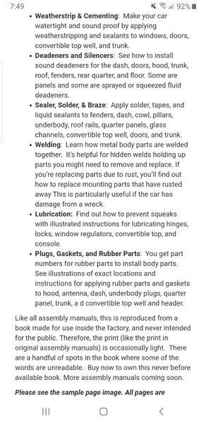

Manual in these pix is 67-69 A body from Faxon auto literature as a reprint. This is the type of book to have, but in your case you will need to find one for B body cars. Price is cheap for all the information it will offer you.

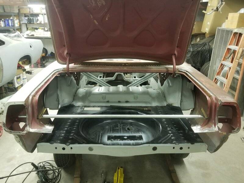

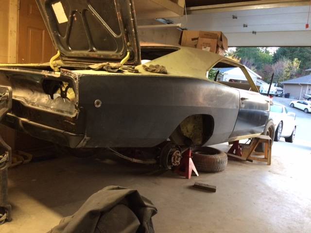

My son paid $15k for this one including $10k worth of AMD tin. I sewed it altogether for him. If you've done it before, Chargers are still really tricky to put the back end together. If you haven't done one before I'm not sure I would recommend it. That aside, financially expect to spend $10k on sheetmetal, then either you have to weld it together or pay someone a lot of $$$ to do it for you. That is just the start, then the expensive part begins, interior, running gear etc. It still may be worth it depending on your skill level.
