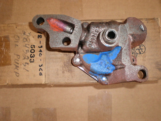

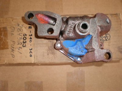

I can fix you up with a N.O.S. Mopar and a Mopar HV spring for $50 + shipping !
