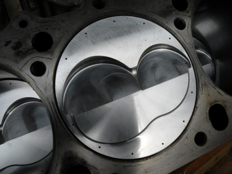

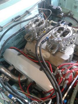

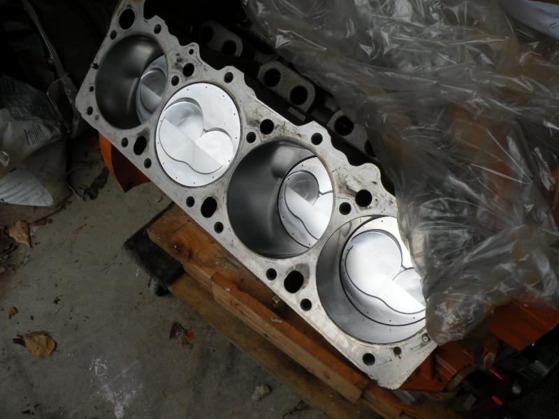

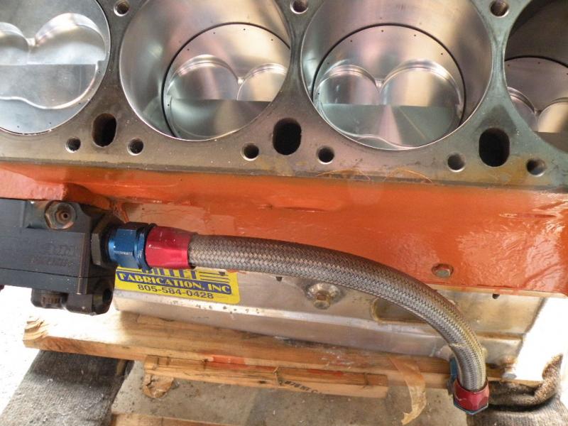

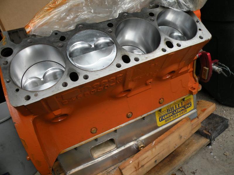

Sneak peek of 15.5 compression all ready to go
:icon_thumright::icon_thumright::icon_thumright::icon_thumright::icon_thumright::icon_thumright::icon_thumright::icon_thumright::icon_thumright::icon_thumright::icon_thumright::icon_thumright::icon_thumright::icon_thumright:
it fired right up and i swear it gave me goosebumps. it never felt this crisp.the crackling sound was insane.

Nice pistons... hope you don't have any flame travel problems, hot spots &/or detonation problems, with all the sharp edges on them slugs, not saying you will either, but I have always seen & had them knocked down/radius-ed all the sharp edges, better for flow too... nice gas ported dome pistons thou....

those pistons are as smooth as a babies behind. for what they cost they better be perfect.
Are those Diamond brand pistons? Who gas vented them for you? Where are the gas ports venting too "straight through or to the ring groove" ?

those are CP pistons, lightened,gas ported took 6 weeks to get them CP are very high quality pistons but tough to do business with.CP did everything on them.lightening program and gas ported them.

Do they perform any of the cryo stuff when there machined? Or coat the tops with ceramics?
I had mine lightened too. We took the lightest one and reduced it a bit, then matched the others to that piston...
What are the dome heights?
Crimeny - that does sound incredible. I don't think the vid does the sound justice for sure. Let us know how it goes!

The sound of this engine sounds completely different from any of the other motors at the track. Even the engine builder knew it was me when i started it up and was in the burnout box and he was over 200 feet away.
Nothing like cam and compression.
