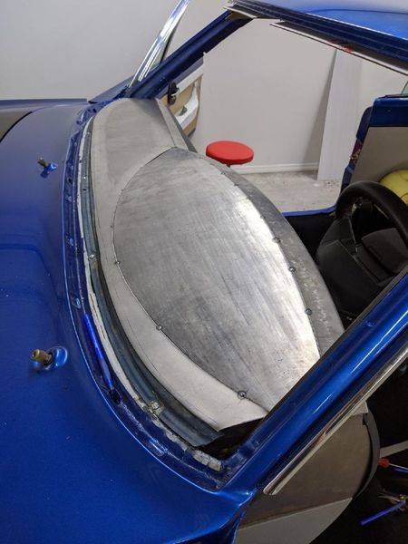

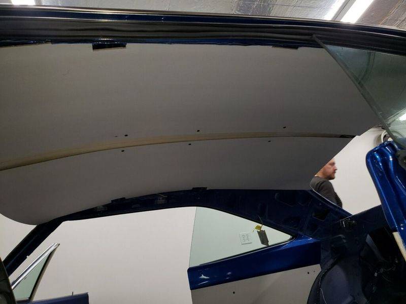

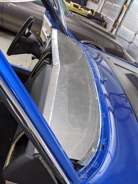

Car is at upholstery. Trying to get some current pics, but a few from layouts for the one piece fiberglass headliner and door panels.
Fiberglass headliner and panels....are these something you are creating yourself or an after market purchase?

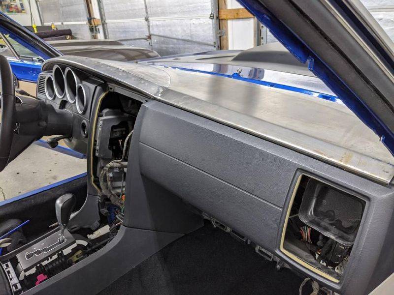

The upholstery guy is custom making all of this. He will foam and shape out everything. The dash also gets leather covered, so he is changing the shape a little as well. I am pretty anxious to see how this will all come together. The goal is to make the interior look classic/timeless, without looking dated already or in a few years. That's a tall order based on using the LX dash, but that's the plan!

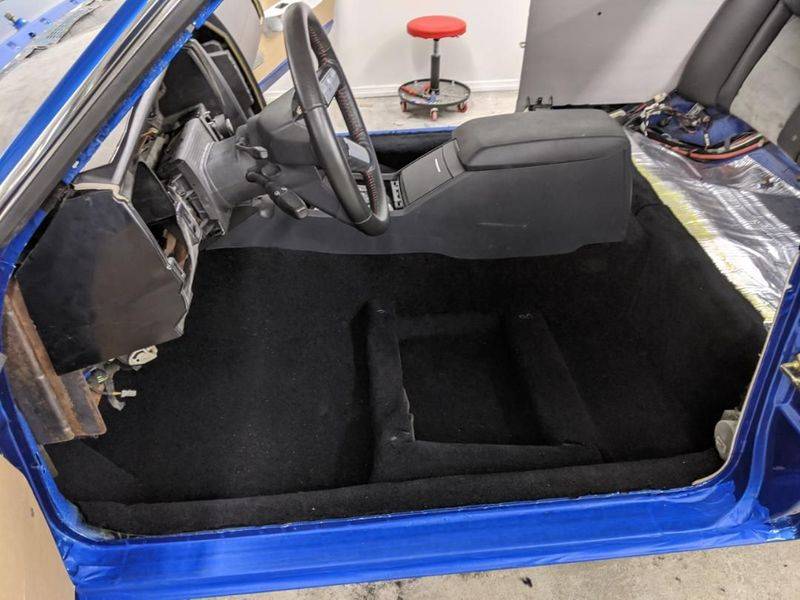

Interior is progressing. Took a little longer to get to it than he had planned, but in full swing now.
