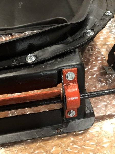

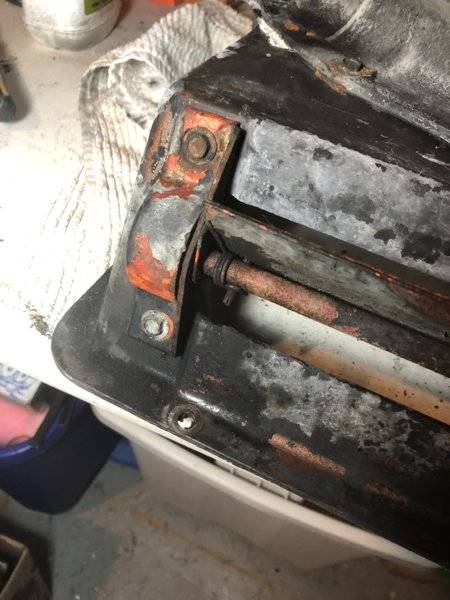

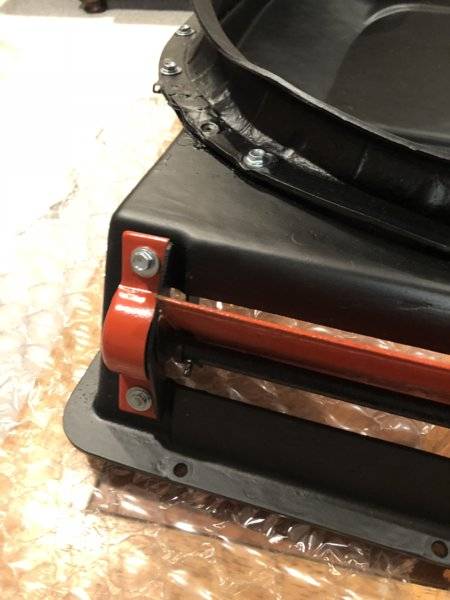

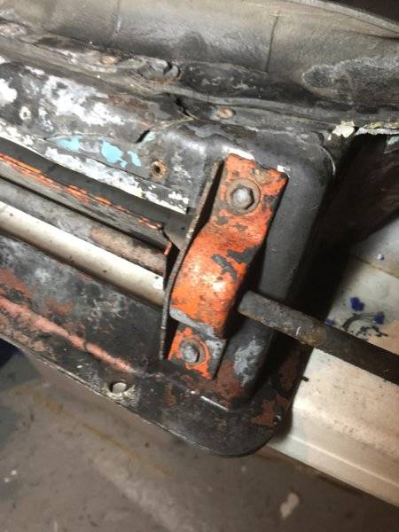

restored the air grabber today
before and after pictures.
-is this the amount the flap is open when not using the airgrabber?
When activating the air grabber, this flap closes and the only air going in is through the hood
opening right?

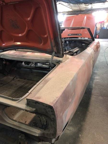

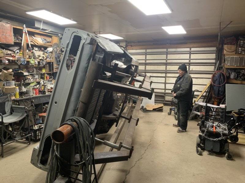

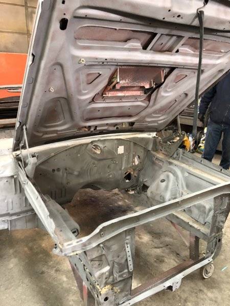

we've been continuing the work..floor is out, fenders off and sandblasted whats left.

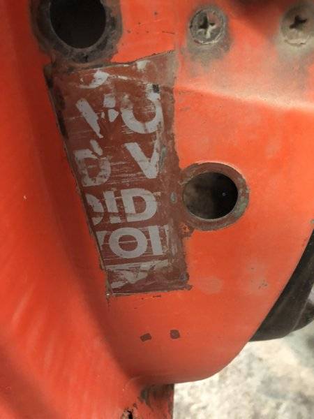

I removed the door jam decal with the vin number and date of manufacture and
there it is; the VOID message underneath.

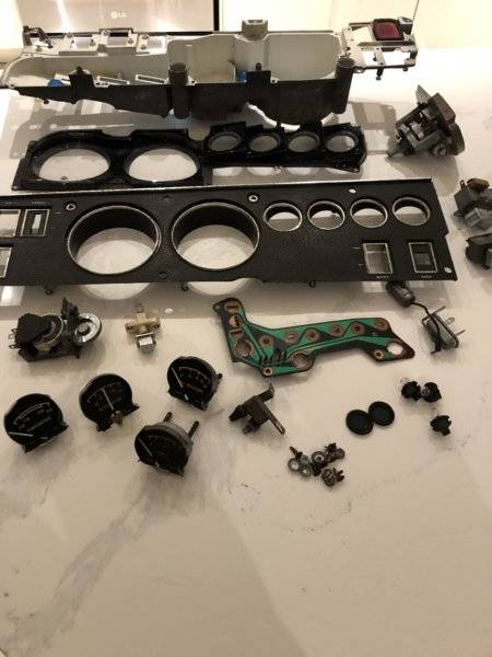

I've got the dash apart and I'm sending the clock/tach out to be refurbished.
I didn't realize when changing to electronic ignition, the clock/tach has to be reworked.

I've got 2 complete rear quarters from AMD but after sandblasting, we're thinking the drivers side 1/4 is good enough that we won't replace. -just a little rust on the bottom.

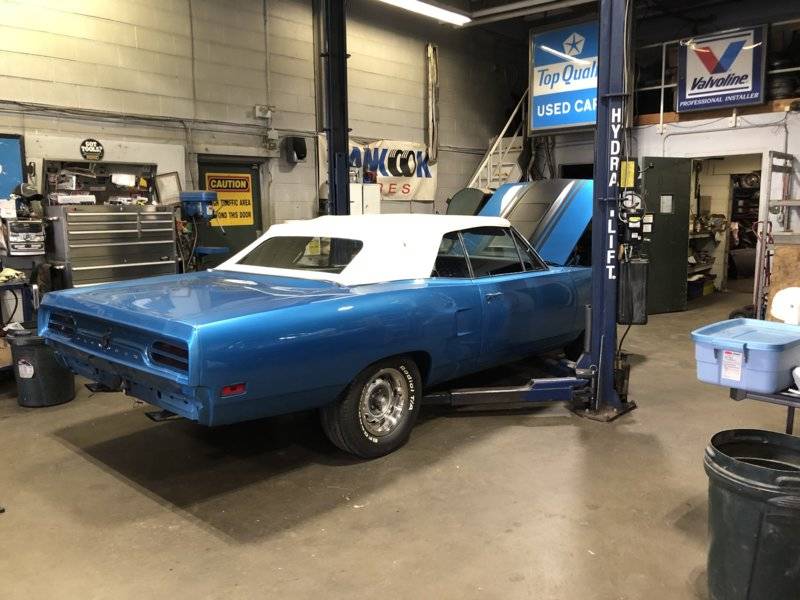

Here's another '70 Convertible being finished at the shop doing mine. 383 4 speed car.

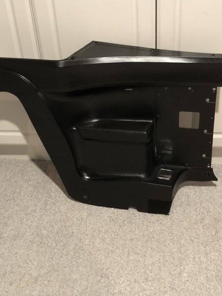

My rear seat side panels had round speaker holes crudely cut out 40 years ago below the arm rest.
The panels themselves were beat up pretty good with wear marks as well and a rusty ashtray.
I cleaned and painted the panels, ordered new inserts from Legendary, and found at Michaels craft store a sheet of black 'vinyl' they sell (3$) with a removable backing already with a sticky surface. I was able to mold it over the shape of the panel and then I sprayed one coat of trim paint. It's not Pebble Beach concours level but it looks a lot better than a gaping speaker hole.

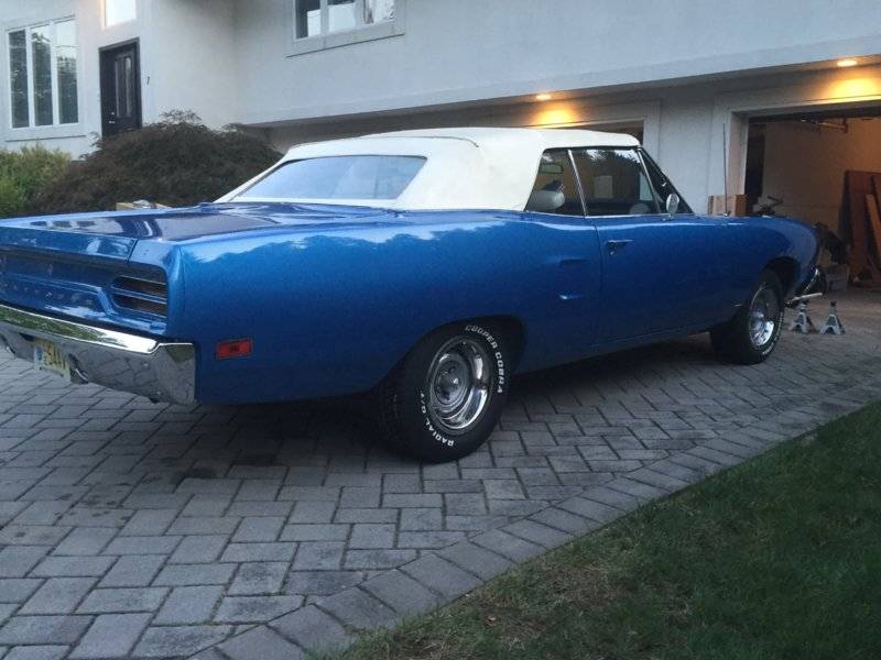

I’ve owned it since ‘78. Had a fire with it in ‘85. It’s been apart in the garage ever since. My goal was to have it ready for MCACN this November but I kinda doubt that is achievable. Here’s a pic from a few months before I bought it. Brilliant yellow metalflake, flares, spoilers, rabbit fur. How ‘70’s.

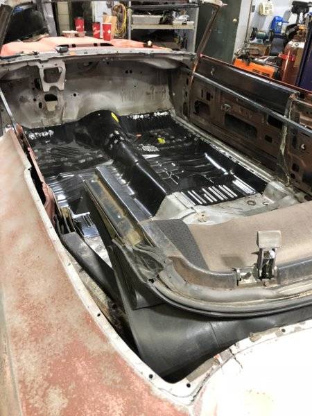

the floor went in today. trunk floor is next.

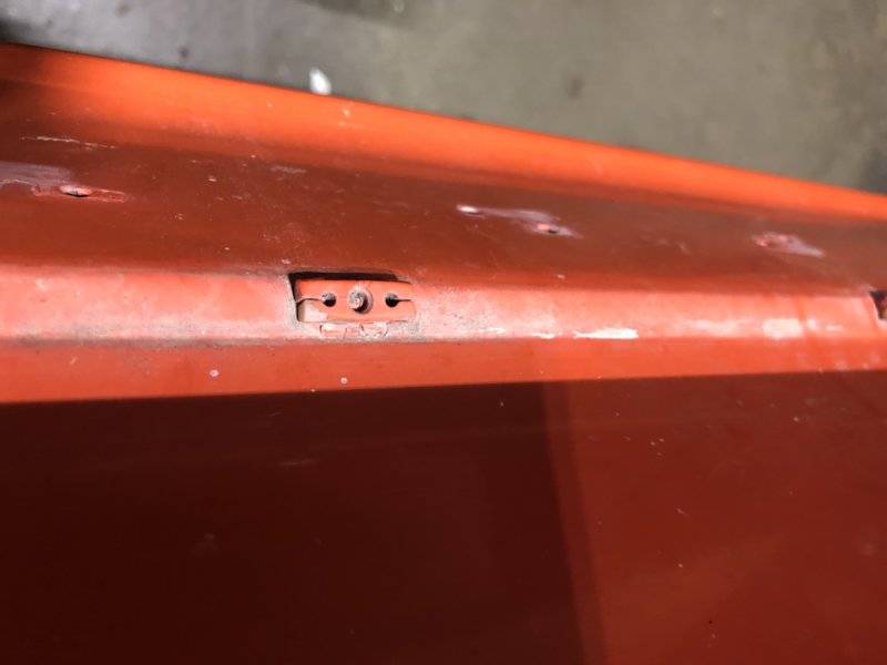

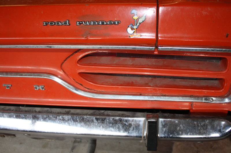

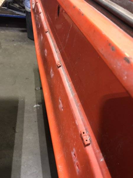

I've got a decision to make about a rear trim piece on my car. My cousin bought this car in 1972 and it had this rear trim piece around the taillights like a GTX when he bought it. Some people say it's impossible because no roadrunners came with this trim. This car was built on the first day of production 1969 and was apparently shipped to Canada as a show car for Chrysler Canada. I tracked down the original owner of the car (he's 82) and he says he never added it. I have to decide if I should take off the clips and go without the trim piece or put it back on after paint.View attachment 907734
A guy helping with the restoration has done almost a hundred mopars and says he believes these clips are factory installed. I'm leaning towards leaving the clips and putting the trim pieces back on after paint and just put up with mopar experts saying the trim is not original. Has anyone seen these on a Road runner before? It's not a huge deal, but I don't know if I should add it back on or not.
View attachment 907735 View attachment 907736
When the previous owner repainted my 70 Satty droptop he removed all the side molding, wheel well trim and rear trunk molding to give it the RR look.
He replaced the tail lights with body color ones and welded up all the trim clip holes on the body EXCEPT for the rear trunk molding. I guess he had thought of replacing it but he never did and now I have holes on the rear tail light panel where the clips go. I was thinking of finding the chrome trim and installing it but not sure how it would look as the only chrome trim on the car besides the front grill trim. Your car is giving me the idea though. My alternate temporary solution is getting 1/8" plastic plugs, spray painting them B5, and plugging the holes, for now. If you decide not to reinstall your trim and want to sell it, I would be interested.

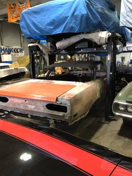

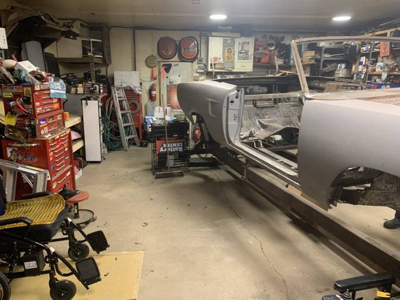

The restoration has been delayed a little with the covid virus.
The car (seen below) will hopefully go to the body shop in a week or 2.
Floor pans are all installed as are the frame rails.

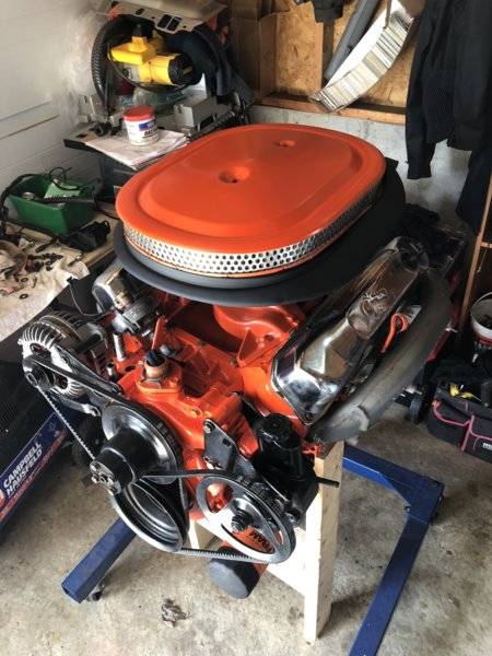

While waiting for the body work and paint, the engine is completed, new K member assembled,
transmission done, rear end done, dash is done.
The wiper motor was sent to quebec and the tach/clock sent out.
The bumpers are out getting re-chromed, so now we just wait....
I'll post pictures from the body shop as they progress.
