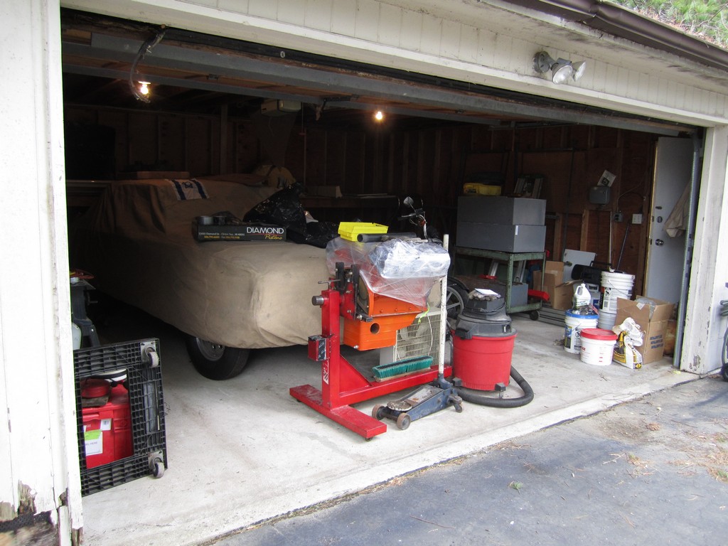

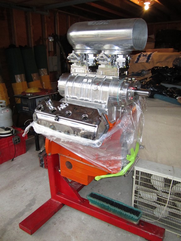

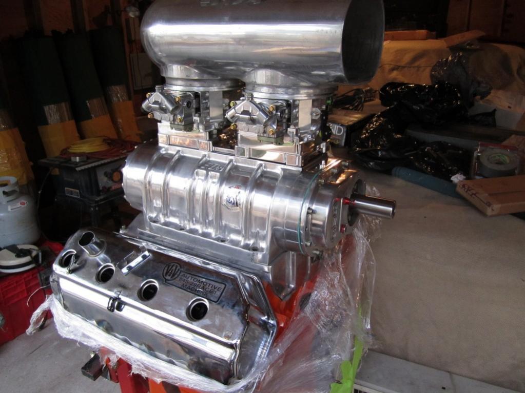

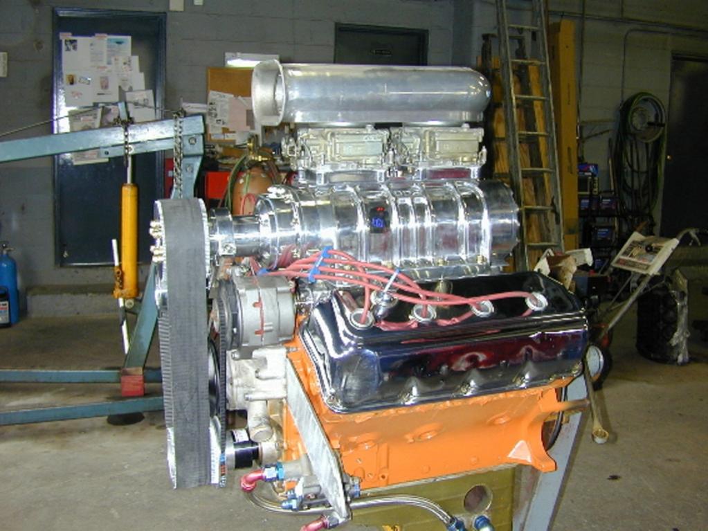

Long block has been done for awhile,finally got the blower back after a trip to the "SPA":munky2:Just had to stack everything for a looksy:toothy1::laughing7::th_krazy:Got wood??Whuttia think?:eek:s_dancing2::clapsarcastic:

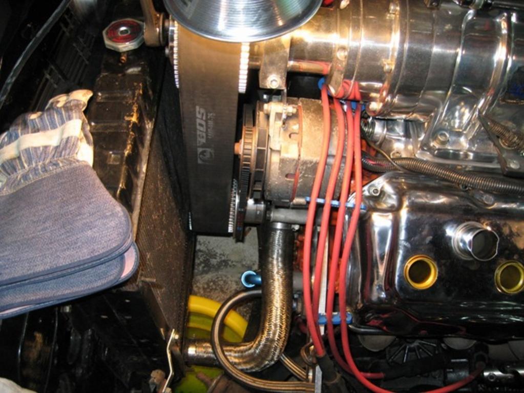

Looooking gooood !!!!!!!!!!!!!!!!!!!!!!!!!!!!!!!!!!!!!!!!!!!:notworthy:
Previous hub required a 1 inch spacer.

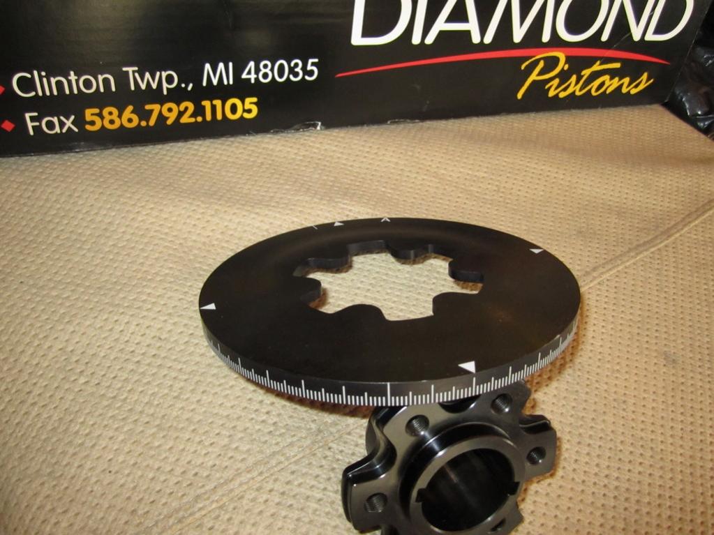

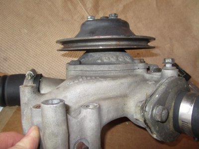

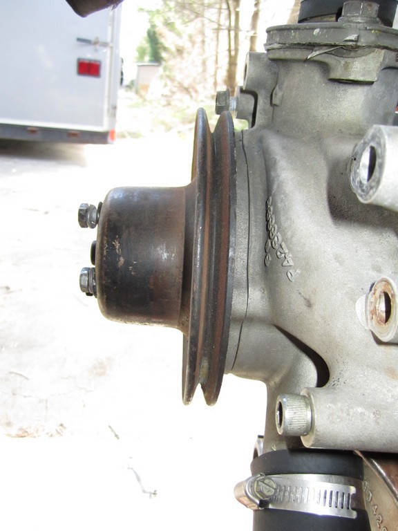

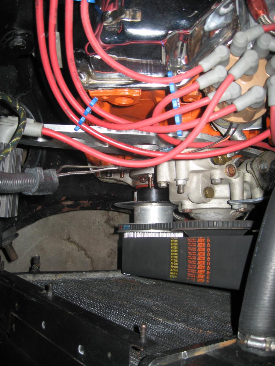

Well,I have finished my investigation:munky2:Need to shorten up the whole deal.Will stay with the stock style aluminum waterpump.Went through my parts bins and found a deeper pulley.:usa2:

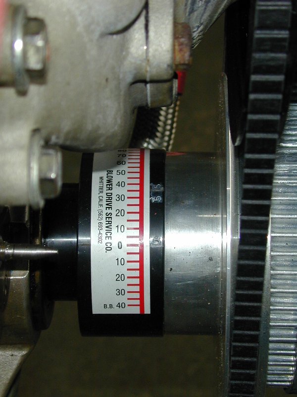

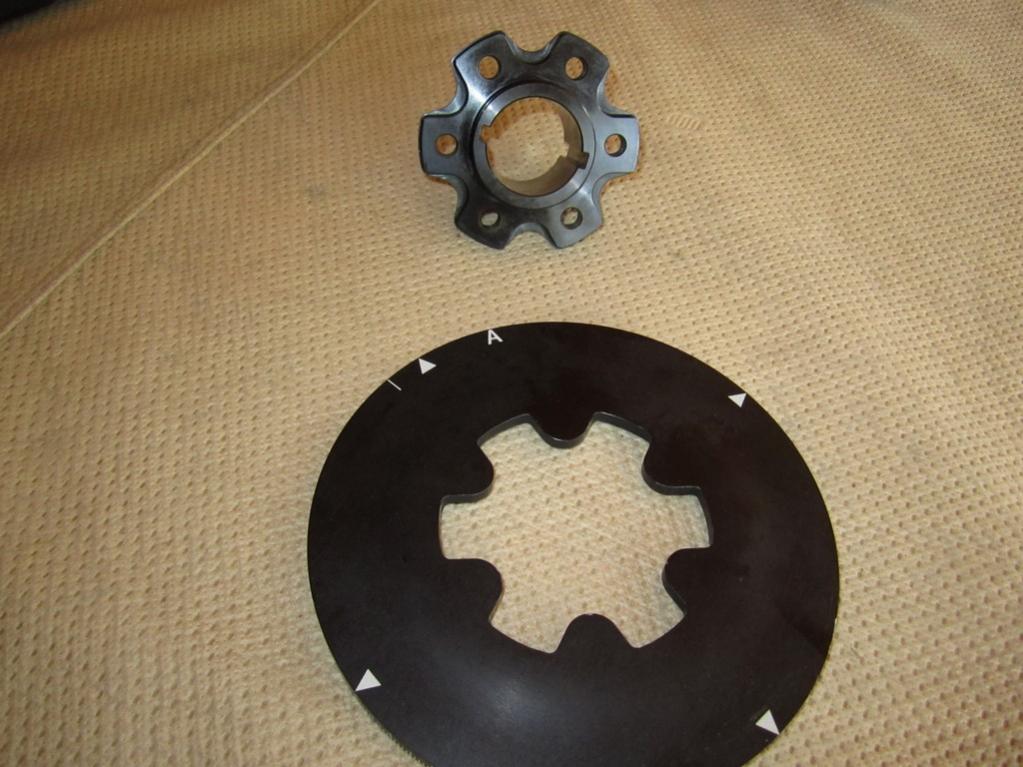

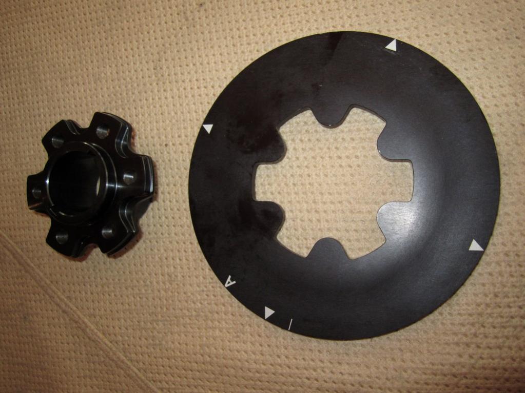

Will return the RCD crank hub and timing ring and get an ATI superdamper!

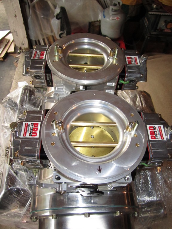

looks good. when you going to install it ? i would love to have a pair of them carbs for my motor.

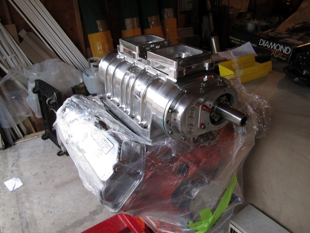

Thanks you guys:munky2:So now waiting for a new superdamper & shorter blower snout .I also need a smaller diameter waterpump pulley.It's always something:icon_hang:
I hear ya, Nothing and I mean Nothing is bolt on. It always seems there is something that needs to be tweeked.
I'm gonna be dreaming about that thing tonight! Crazy looking set-up. What kind of HP? What size Hemi?

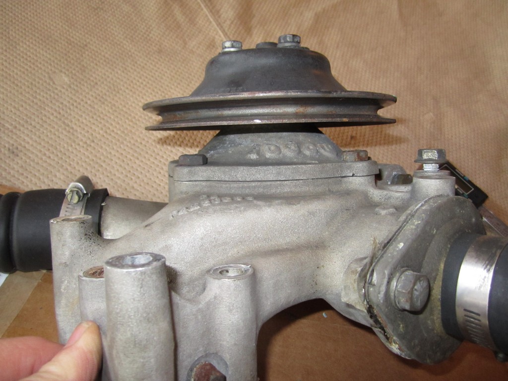

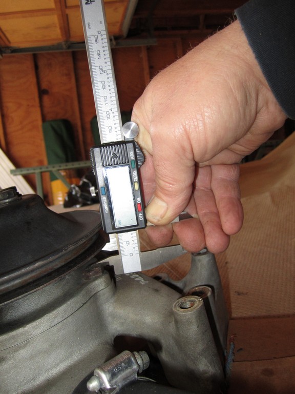

Picked up some button head bolts for the waterpump to housing.The smaller diameter pulley given to me by Special K hits the waterpump bolts,so the smaller/shallow-er button heads allow the pulley to be very close and need a minimal spacer.:sleepy2:
