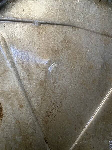

It sounds like a belt squeaking. Come about 1000 to 1100. Goes away at 2000. No belts on. Oil pressure is good. 65 70 on highway. 25 to 30 at 650 rpm idle. I’ve pulled all accessories. Alt water pump ps pump. Pulled the oil slinger out. Swapped the distributor. I’ve been driving it like this. Thought it was a belt. Seems in front. Middle to lower. I’ll look more in a bit. It was late yesterday afternoon when I started trying to find it. I really thought it was a belt squeal. No knocking. No exhaust noises. No air leaks that I can find. Even plugged the vacuum ports. No smoking. No misfires. Runs great. 130 to 140 compression

Found it. Cam bolt rubbing cover. A tiny bend in the cover. Probably from someone prying off the water pump housing.
