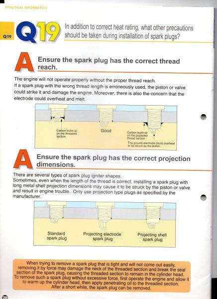

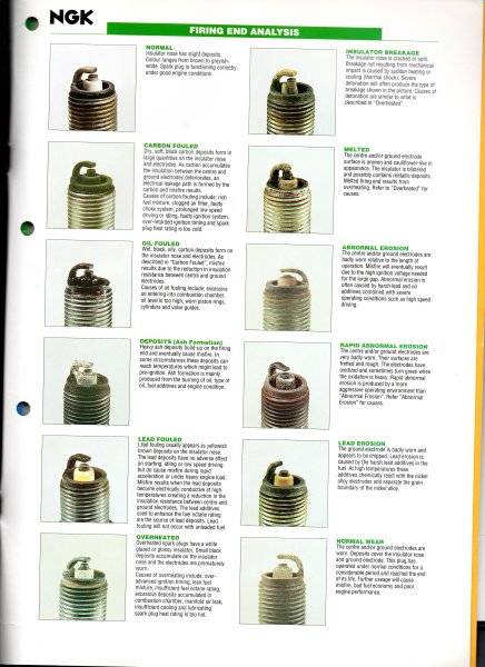

As I also pointed out in post #118, the position/threads of the spark plug will affect how the plug body heats up & how the GS temp is affected.
I have two or three NGK catalogs. None of them describe the GS colouration as a means of determining heat range. Nor have I seen any other plug manufacturers [ not mechanics ] use that description.
The colouring of the GS is dependant on a few factors/variables, as I described in post #118, making it unreliable.
From NGK catalog. I know the writing is small but the GS colour is not mentioned in any of the captions
Straight from the horses mouth....

The GS colouring is an 'opinion', not from NGK Japan direct, nor any other plug manufacturer. That is because GS colour is not a reliable way of determining heat range because of the variables that will affect it, as mentioned in post #118.
The correct way to check heat range is to look at the colour transition of the insulator on the centre electrode; nothing to do with the GS. It is the centre electrode that can be too cold...or too hot, not the GS.
Well known racer Steve Morris of SM racing engines has a 6 min video on plug reading. He claims the GS colouring is related to ign timing [ not correct either ] & has nothing to do with heat range.
You will get lots of opinions...& little fact.
Aron.
Your plugs are not too hot based on the pics. Colder plugs would be a retrograde step.
