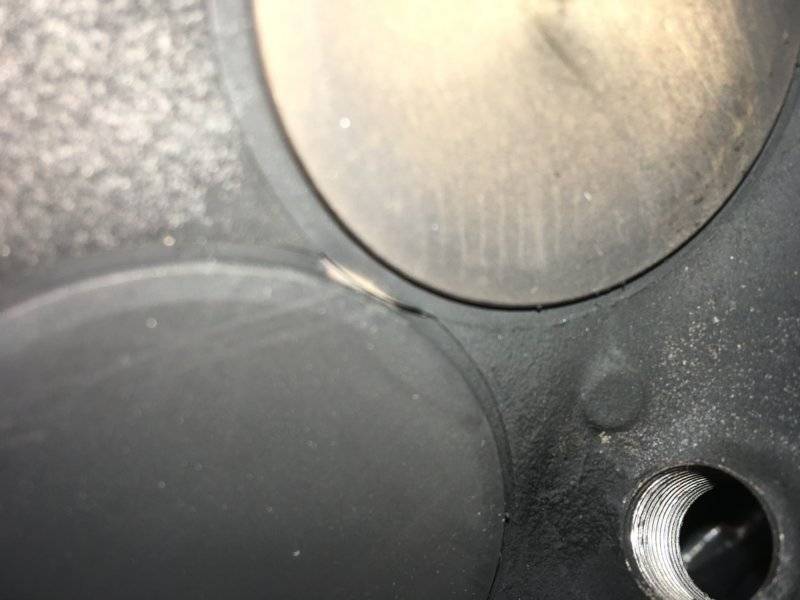

Here another issue I found I am addressing today. She has 20lb lower conpresssion in the suspect cylinder

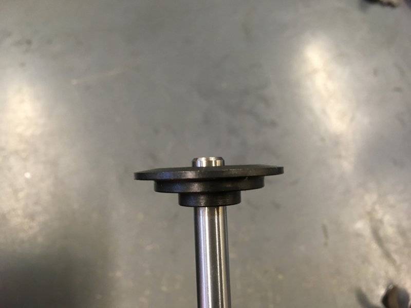

In this case, the OE retainers are 1.330” diameter, and the valve tip stands proud of the top of the retainer by .175”.
These are the parts the oe rockers were designed to work with.
The Stealth retainer is 1.500” diameter, and the valve tip only stands .100” proud of the top of the retainer.
Obviously, there will be less clearance between the Stealth retainers and the rockers than with the OE parts.
The easiest path forward is to replace the keepers with some Crane machined -.050 pieces(99096-1), however this will add about 12-15lbs spring load, both on the seat and open.

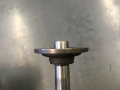

I suppose it’s possible the Stealth keepers have receded into the retainers some, and now your valves don’t sit as proud of the retainers as they used to.
I checked a few, and they were all right about .100 above the retainer.
I also checked how much difference there would be between the new stamped keepers that come on the Stealths vs some std height machined Crane pieces.
The Cranes pushed the retainer down about .010”(.110 tip height).
If yours have less tip height above the retainer than .100”-ish, maybe some std height Crane machined locks would get you enough clearance to work.
But, I’m not talking like .005-.010 less...... I mean like .015”+ less(.085” or less tip height).

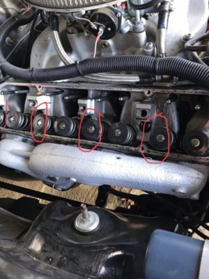

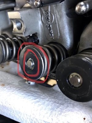

Here’s the circled points on the rockers/retainers
AD7F5F1B-9EB6-4613-95D6-7B57B289C9C2.jpeg A837F278-FDAB-48B1-9E6D-579C8D0FCB18.jpeg
The thing that I don’t understand is it’s every other valve and the drivers side is opposite of this pic of the passenger. But still every other one
Your keepers look to be sitting a little lower in the retainer than the new set of Stealths I have here.
If you have a dial caliper, measure down from the valve tip to the flat area of the retainer, just outside of the chamfer of the hole.
If it’s .085”-ish or less, some Crane machined locks will probably take care of it.

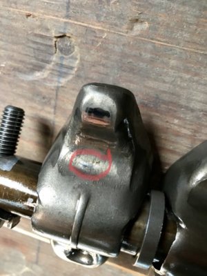

As for why it’s those particular rockers that are hitting those retainers........ it’s simple.
It’s the “left” rockers that are hitting.
There must be a slight variation in that area of the stampings between the rights and lefts.
The lefts are hitting...... the rights are not.

What you do know for sure is, the left rockers don’t have adequate clearance to the retainers.
I know how I would proceed to remedy that before I worried about anything else.
In my mind, there is no real mystery here.
The left rockers were probably barely touching the retainers on initial assembly, and now the keepers have been pulled into the retainer slightly(retainer is closer to valve tip)and as a result, there is a greater degree of contact now.
Move the retainer farther from the valve tip and the problem should be resolved.

I have the same exact issue, engine, heads, wear on the rockers, every other rocker.
Where the pushrod meets the rocker, some rockers have a circle wear pattern just outside the oil hole, some have a full wear pattern from the oil hole to the center, like the pushrod is drilling a hole thru the rocker.
The rockers that are contacting the retainers are the ones with the full wear pattern.
This is essentially drilling thru the rocker, lowering it on the pushrod, which makes it contact the retainer.
My understanding is eventually the pushrods will punch thru the rockers.

I’m glad I found someone else with the same issue, when I called 440 source and explained it they said they never heard of that issue. What I ended up doing was taking a set of my rockers and shaft up to local machine shop that originally built my engine and does all my machine work and got his opinion and he suggested outside of going the adjustable route just taking a small die grinder to the area where the rockers where hitting because it was such a small contact area, and it seemed to work; I had to do it twice as I was afraid the first time. I don’t really notice the push rod issue as much as you were describing nor did my engine builder, could be I didn’t pay much attention to it though. When I talked to him about it he basically said he believes that overtime as the valves wear it will raise the height and that’s probably why I didn’t notice it at first.
