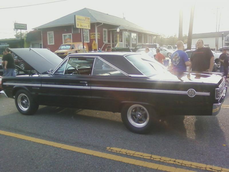

That's exactly what I'm looking for. Looks fantastic.
If I had to guess, that's at least 2.5 - 3" taller than stock.

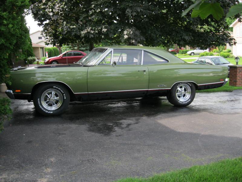

If you notice the fender lip is about 1 inch above the lip of the wheel. I used a taller tire on the rear to give the illusion of being lifted higher than it really is.
