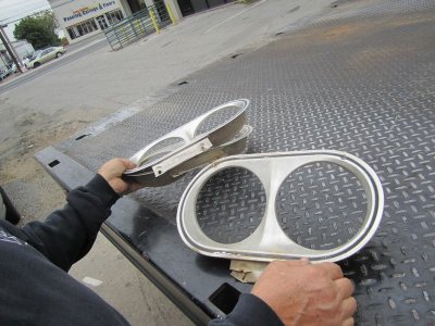

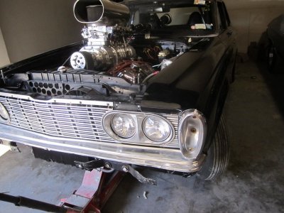

I purchased 2 fenders and a grille from a great gent in Tyler Texas.He sent me 2 super rust free fenders,2 grilles,3 headlight bezels and a front directional housing.Shipped through Fastenall [hardware store] store to store near me for $125.James did a fantastic job building a crate and wrapping everything perfect:hello2:

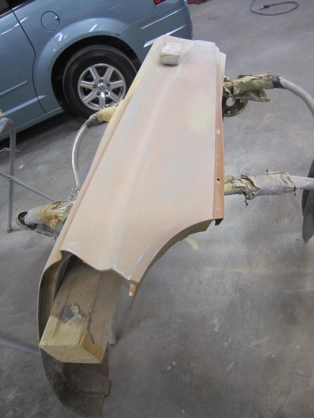

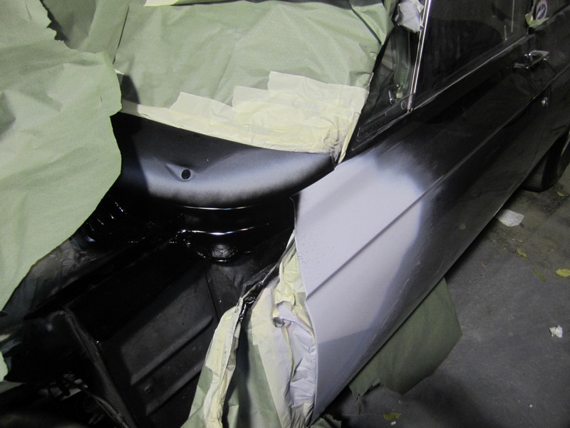

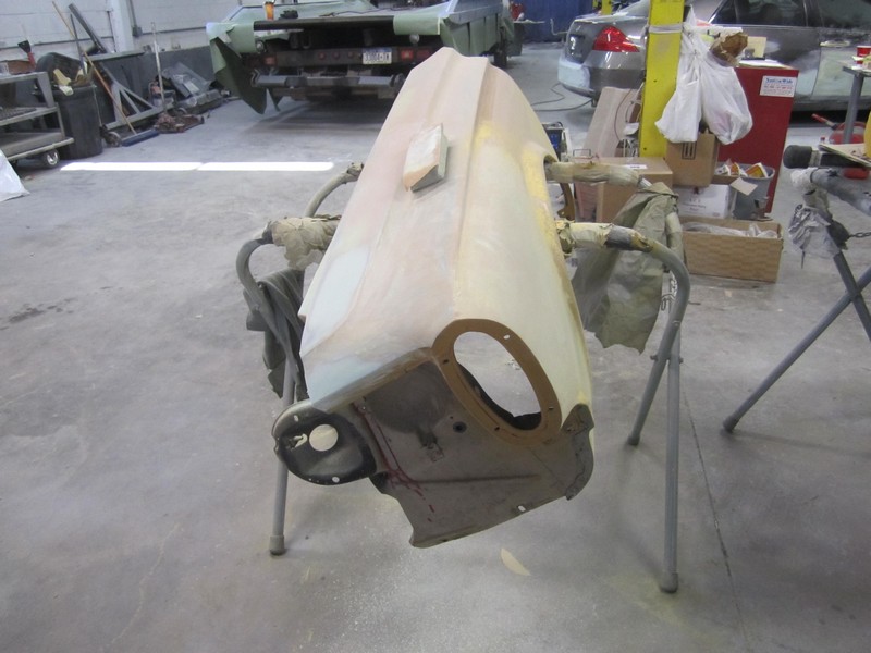

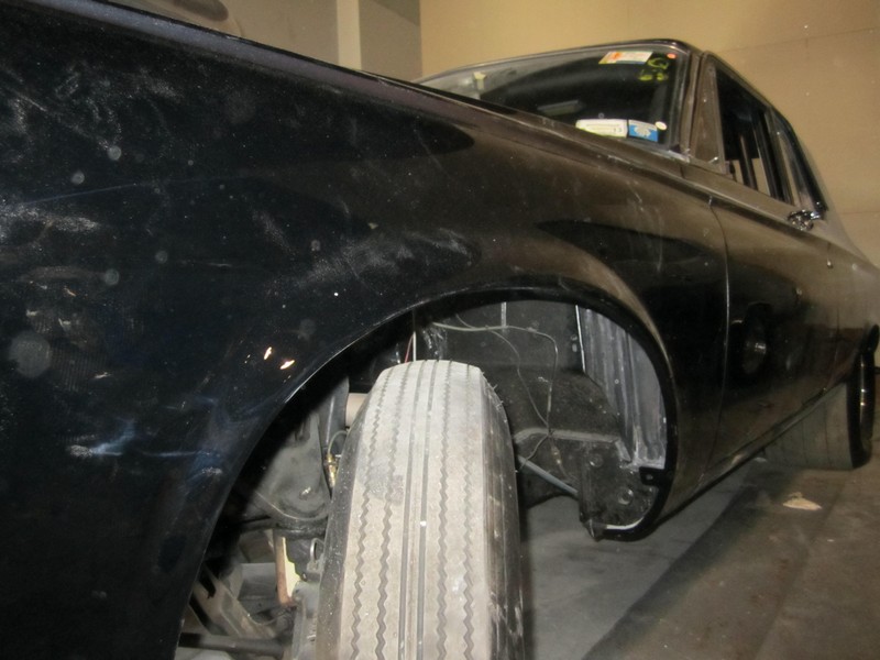

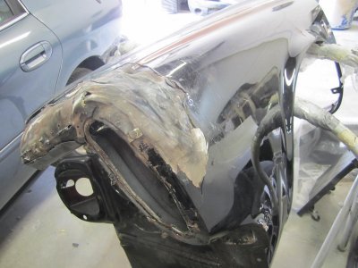

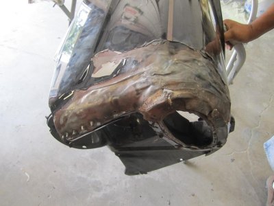

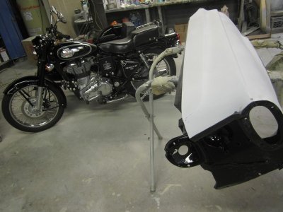

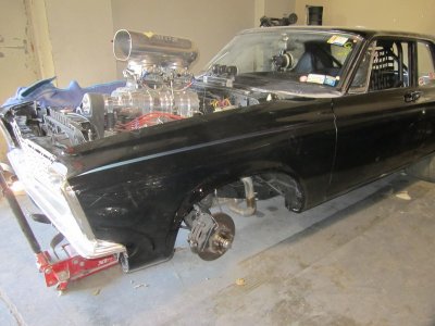

After spending about an hour on the damaged fender it was off the car in no time.They pulled it out to close od the original shape.Once I found fenders,they stopped working on the damaged fender 'till the new ones arrived.They pulled it back to the orininal shape,just had to hammer out some wrinklrs

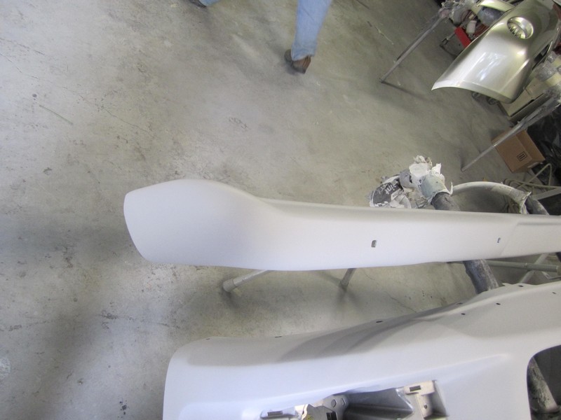

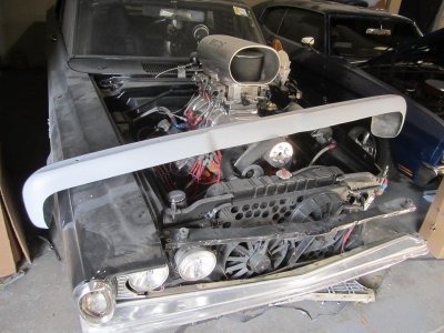

Both bumpers were repaired and prepped for paint.Still debating on bright silver or,,,,,,,,,,BLACK!

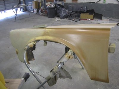

Next the trim hole in the side of the fender{fury fenders} had ti be welded closed and grinded down smooth.
Doors & fender

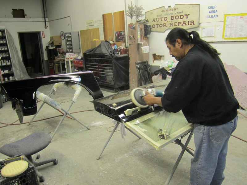

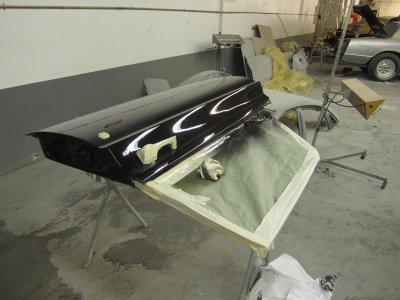

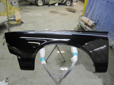

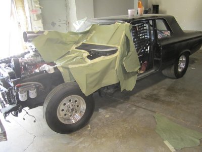

Doors and fender in paint with the custom flip flop stripe

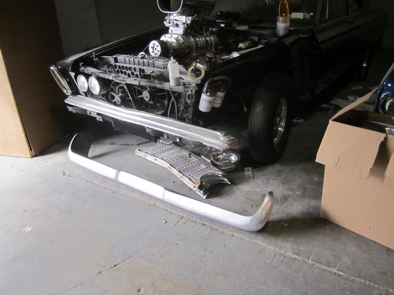

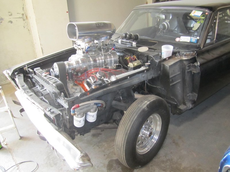

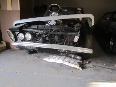

It is back again and back in my garage.Taking care of the direction housings and grille.After I survive X-mas,I'll get new tires and rims,new shocks and install the race pak data logging dash:toothy5:
Still have to paint the repaire fiberglas bumpers and paint the cowl.Then need to buy new rims and tires and paint the cowl:blob1:
:toothy5:Then it's time to install the Racepak dash with logging with all the sensors and install the new shocks all the around.:toothy5: Also want to instll "J" bars in the front.:eusa_think:

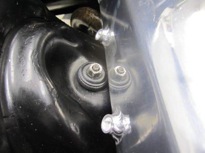

Cool beans!! And what is a 'J' bar? Don't think I've heard that term before. I also like to epoxy in my freeze plugs. Not going to let the motor ever freeze....
"J" bar goes from the front down bar,through the firewall,braced to the shocktower then bends down like a "J" and welded to the front framerail.I will do this in the fenderwell because there is NO room in the engine bay:blob1:
Also used "the right stuff" when I installed new freeze plug.Ran a bead around the plug,waited a little while and pressed it in.Then took the excess and ran my finger in circles around the plug where it meets the block.
