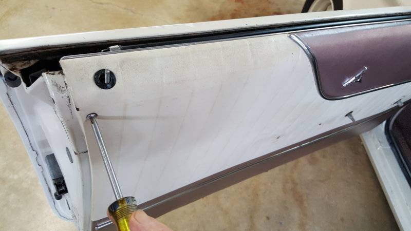

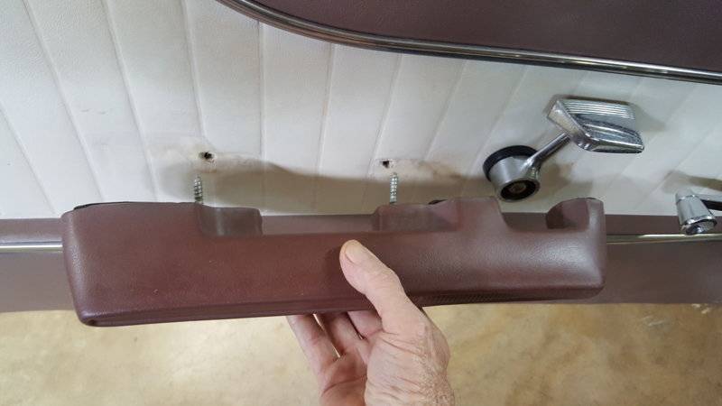

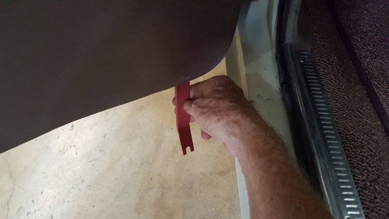

Well, I've been wanting to work on the door seals, whiskers, channels, change the locks for ones that I have a key for and some final adjustments of the door and window alignment.

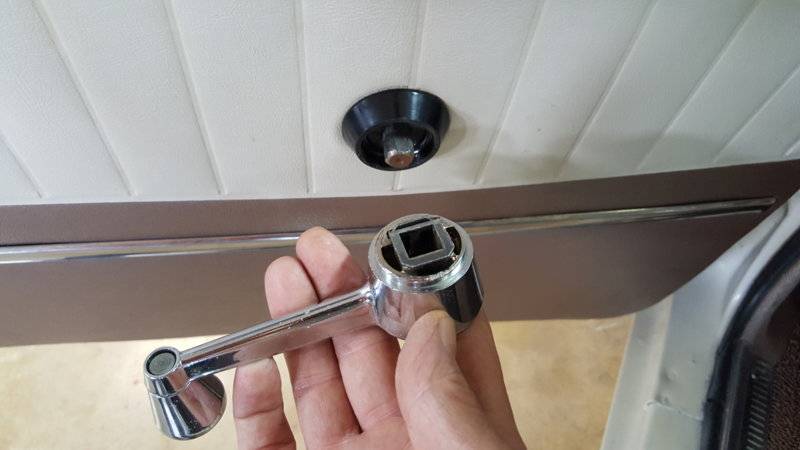

You can refer back to when I removed the rear panels for how the cranks are removed.
I've never seen so many clips on a panel before. The panels are in good shape. First time they have ever been removed.
Plastic vapor barrier is in good enough shape to reuse.

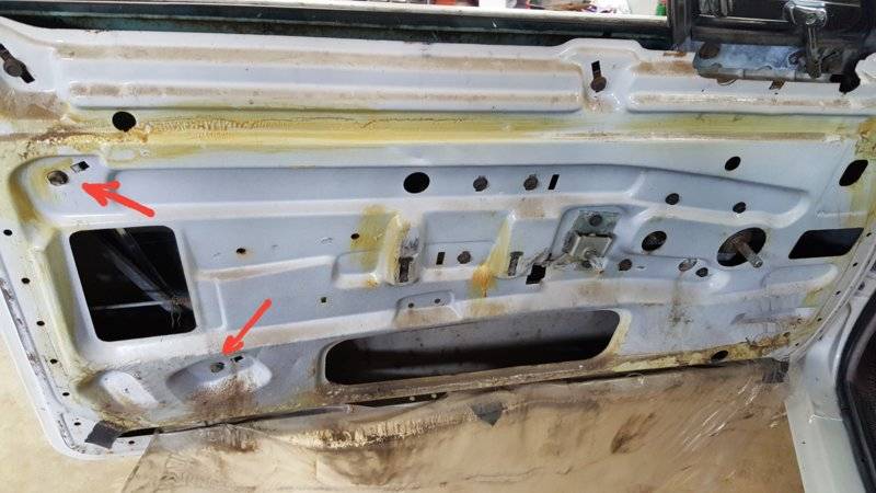

These are the two bolts that hold the rear track in place.

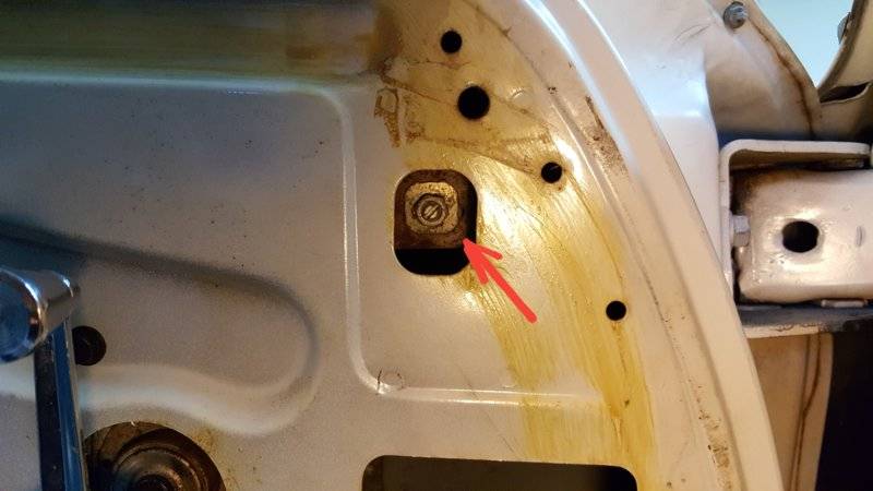

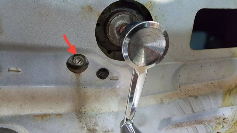

This is the adjuster/stop for how far the window rolls down. We will need this later.
This adjuster sets the wing/track in or out at the top.
These adjust the front track in or out at the bottom.
This bolt adjusts the rear track in or out at the top.

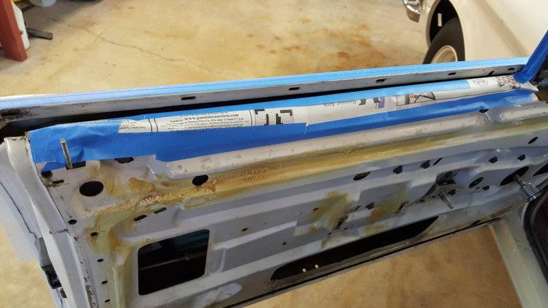

Ok, I'm jumping right to the "channel run", prep and material replacement. There were a couple requests on another thread on how it's done.
This is normally how you find the original one, in the bottom of the door. Squeak, squeak!
This side was still intact but badly worn. Scrape it out, sand and clean the inside.

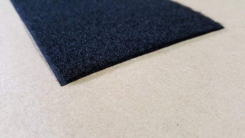

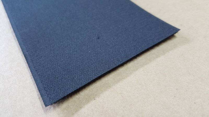

I found this material on EBay for $3.00 per foot. It measures 4" wide and is about 3/32" thick. I noticed that they advertise different thicknesses.

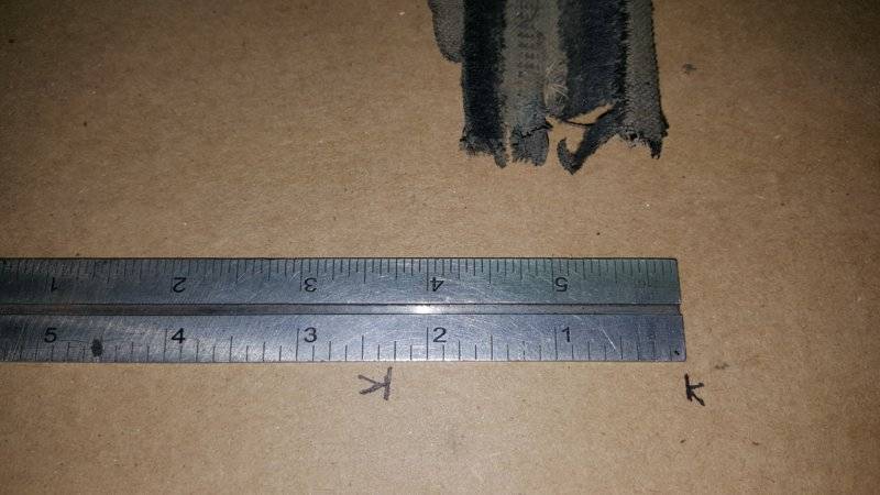

The original one was actually rapped over the edge but that's not going to happen with this material. It's too ridged. I flattened out a piece of it for a measurement.
I'm going with 2" wide.
I'm using the 3M weather strip adhesive. Just apply it in the bottom of the track and to the center of the material. You need to have the glue on both pieces for it to stick correctly.
You can see that I found a piece of wood that fits in the track to hold the material tight while the glue dries. A couple of clamps and go find something else to do for a couple of hours.
Now that the bottom has set up good, peal back the sides and apply glue to the metal track and the material. Re install the wood and re clamp.
It's too much to try and glue the whole piece all at once. The glue sets up too quick and you'll have a hard time getting things lined up.

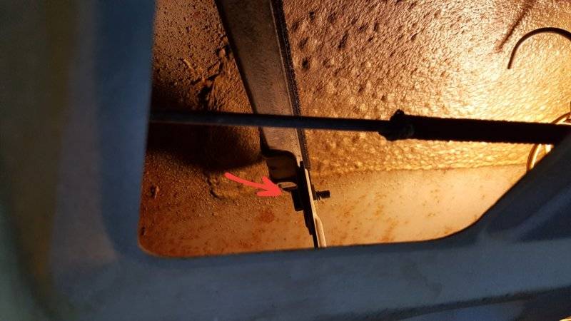

Replacing the old wiskers you'll need to drop the window down farther then it is now. Loosen the stop jam nut and turn the screw while moving the window crank. It's a cam/eccentric that you are turning.
Now that the window is below the top of the door you have the room to remove the old whisker. A screwdriver and awl works good.

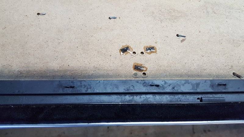

There is three little nibs that fasten the Polara emblem to the door panel. I found all the clips removing the panel. There isn't enough pin showing to get the clips to hold so I epoxied them.

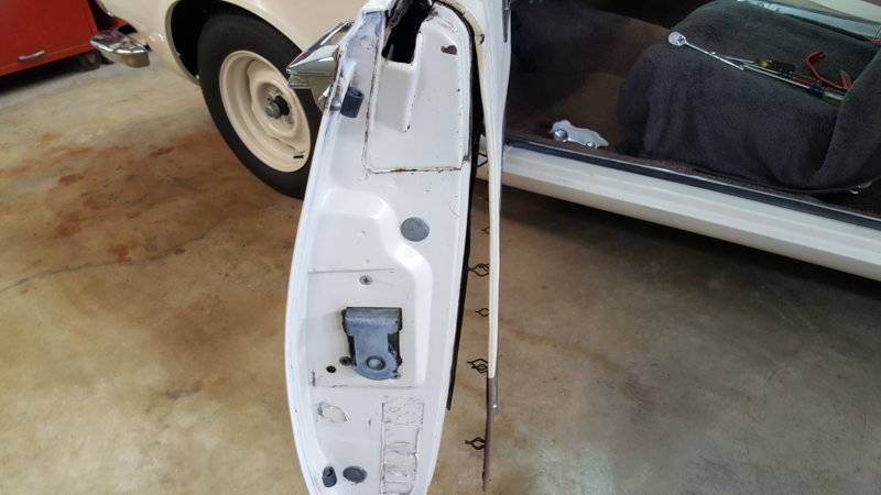

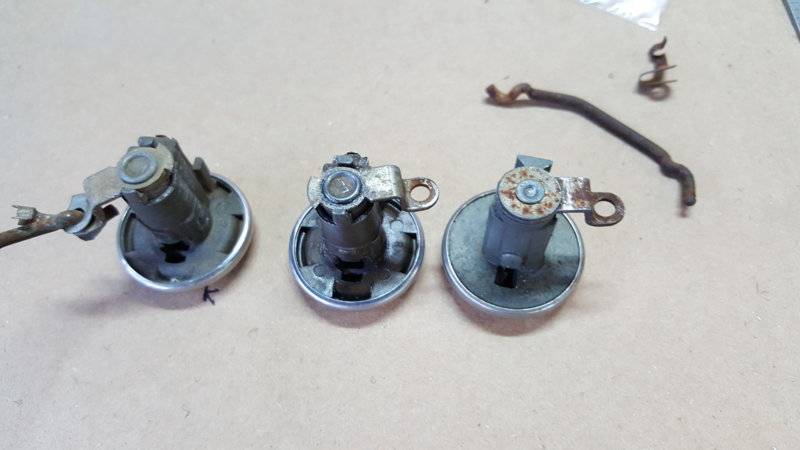

When I bought the car, someone had changed the ignition switch and that key wouldn't fit the door locks. So a fellow member sent me a set of locks and a ignition switch all keyed the same. I thought they were for a '65, not sure anymore. You can see that the leaver on the back is the same but the outer ring is a little bit different.
The one on the right is the original 1962.

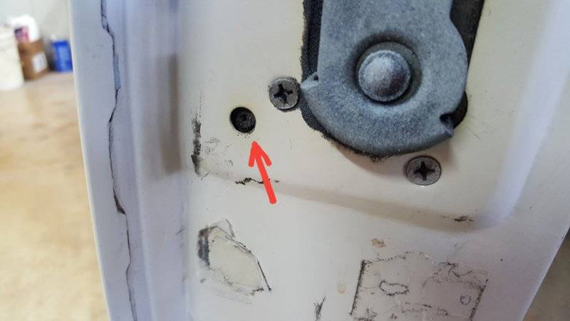

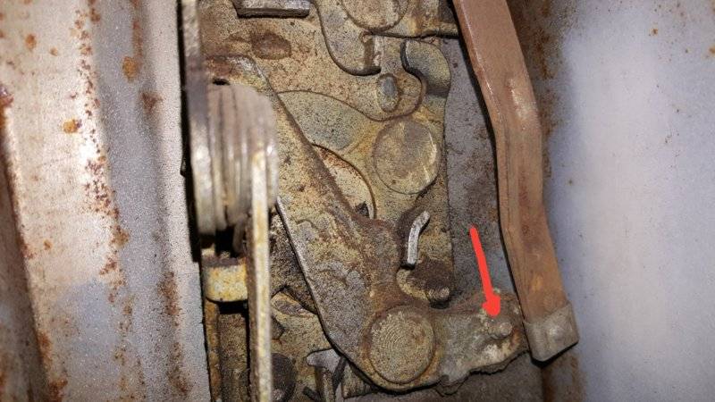

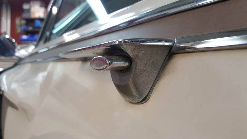

I've heard guys talking about their door button having too much play where you have to push it almost all the way in before the latch releases.
Here's the adjusting screw if this happens. It holds two pieces of linkage together and when loosened it lengthens or shortens the throw.
This is the screw from the backside.

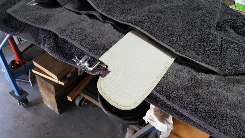

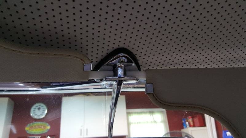

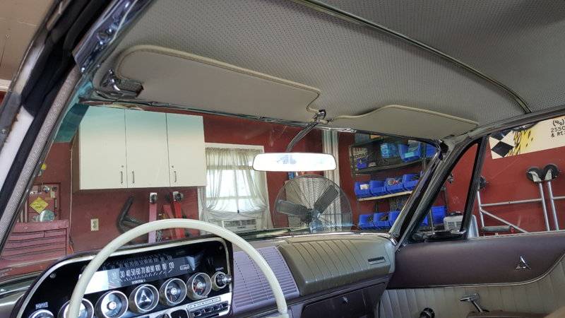

I found a couple of used sunvisors from a Chrysler. The material was in good shape for the exception of the stitching was worn through along the edge. So I took up sewing and replaced the stitching with new thread.
Then I removed the rods from my original, dry rotted visors.
The left one is part #2241939 also there's a "L"
The right one is part #2241938 also there's a "R"
Takes a little doing pushing the rod into the visor. I used a heavy towel to protect it. Push it in as far as it will go.
I was lucky enough to salvage the plastic insert, still pliable. I'm going to order the Delrin ones that Hemi Eddy sells on EBay. You push them in as far as they will go.
