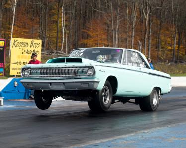

My 65 light blue dodge was supposed to have the upgraded front steel 5 pinion planetary but it didn't but with over 1000 hp, it stripped the aluminum right out of it.
1.24 60 foots with a 3400 lb. car doesn't help either.
yeah when you make that kind of power, using any brand of automatic trans
it will eventually find the weak link, that's for damn sure, Murphy's Law...LOL
