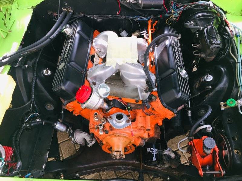

When i started removing stuff i realised this will become a massive pain in the butt to get the headers out without removing the engine.
I don't have access to a lift so to do all this stuff on the ground i not going to be a easy job.
So instead i bite the bullet and am preparing to remove the engine.
I will see how the rest of the header will look like, if this is the only one cracked and can be repaired properly i will reinstall it.
Otherwise i will have to break the bank and get some new headers.

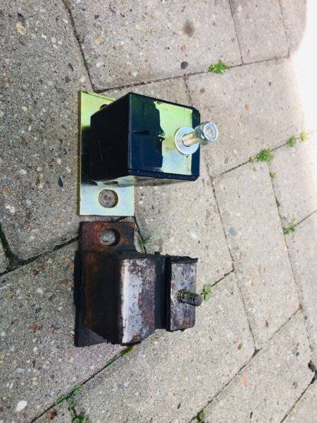

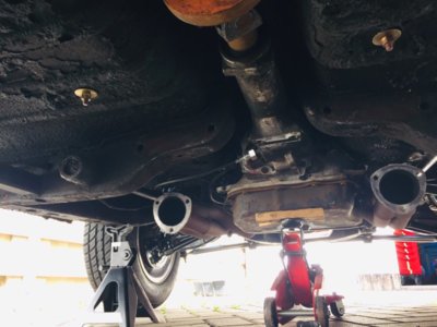

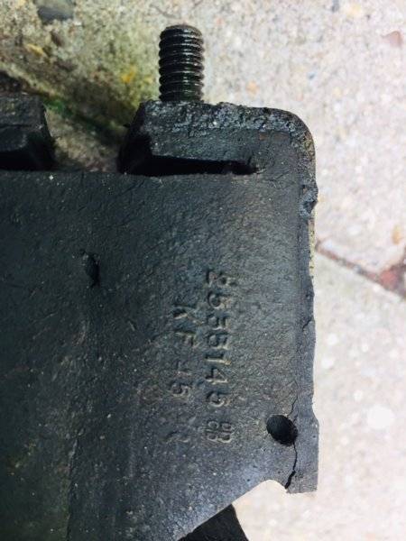

As I am waiting for some materials i've ordered, including a engine lifting plate, and while the exhausts are removed i went ahead and changed the transmission mount. I had a new one already for a long time but never got to it.
It looked like pretty old so a good thing i changed it.
