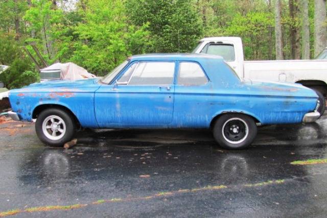

I know this one is off the cuff of devotion, but it sure is pretty .......and light. I can't remember what the older statesman told me, but it was light for its size. Stick shift and all and it was running in the 12's.
