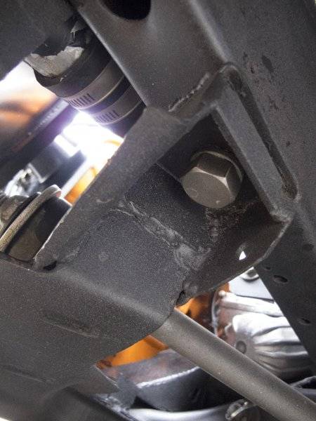

The stocker look alikes seem to be hard to get nowadays unless I've looked in the wrong places. That is why I purchased two pairs. The adjustable types are still available. I would think that they are a tad heavier.
Did you make your own cone washers? If so, how did you 'cone' them?
Yes, I made my own coned washers. I obviously used the same thickness aluminum. The aluminum should not be pure or it will be too soft. They could be 3003 alloy but not sure since it was so long ago now.
I used a hole saw a little bigger than the circumference of the washer to cut out the overall shape of the washer and give it room to shape down or otherwise it would have ended up too small.
The washer ended being a little larger than the strut bushing itself once it was finished just like the stockers.
Drilling out the middle hole first where the strut slips through enabled it to stretch just a bit to form into its cone shape.
Using a few types of body hammers, it was shaped over a domed piece of solid steel that was laying around. Sometimes odd shaped steel pieces found on the streets come to good usage as makeshift anvil's. Locking titanium nut is either from MetTec or McMasters. It could be from MetTec, but could have been old stock that was found at Apollo Trick Titanium.
Attached is bad picture of the washer on the upper left only because the focus was on the Titanium K-member bolts. The struts themselves were painted to look like cast steel with a light coat of transparent black over that and they now look like old blackened steel. All that work only to hide it in the interest of stealth.
Note the $h!tty factory bead welds on the K-member.

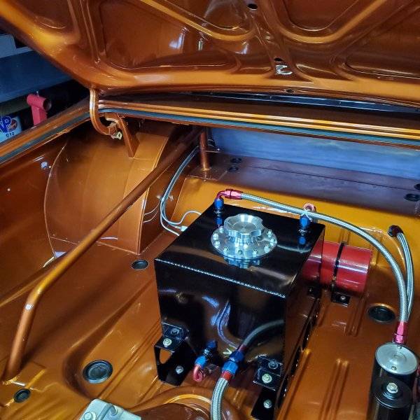

I’m interested to see how and where you locate the plates. I’ve got 120 lbs of lead that mounts ahead of the rear tail light panel but thinking about the underside.

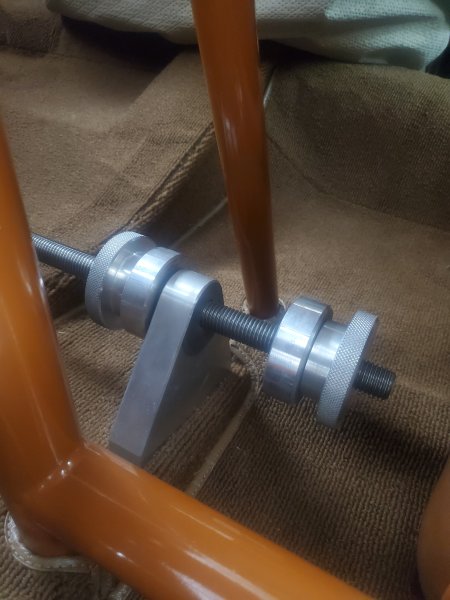

Note the two tabs off the cage above the rear shocks. They hold a lead filled 2x3 steel bar
Then the dumbell mounts use 3/4 threaded rod with home made knurled knobs. The new plates are offset drilled to slide on the rod. The bracket has 2 1/2" bolts threaded thru the 2x3 frame connector outrigger from the bottom.
Doug
Doug

I’d be afraid to put that much that far back. Not sure the wheelie bars are strong enough.
Doug

I bet that cavity between the rear floor and rear bumper is a real drag in the wind at top end. The back bumper here may be acting as a mini opened chute at all speeds. I've enclosed mine with a simple aluminum sheet with a slight 20% bend and trimming to fit in and clean up the airflow. It's held on to the bumper's bottom lip with small rivets, but then again, my bumper is steel.
Is there a problem with it Doug?
Mine would be on the bumper with what looks like 60lbs? that far back. We start a little over 300lbs nose heavy with the front shock rebound at times full tight. I wouldn’t trust mine without wheelie bars.
