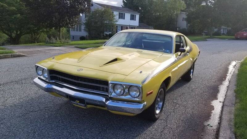

After reassembly, I took it out for a spin - this time with a hood!
I had lowered the front end some, but still need to lower it a bit more. Plus the alignment it still way off, so that is probably next on the list to do. There is also plenty more work on the car. The A/C, the big rust hole, other rust areas, some interior work, etc. But, the car (at least for now) will stay a "RoadKill" style car and a bit of a beater. No beautiful body like @Builderguy or @MoparJimT cars here!![]()
Thanks, yes I feel good that it is running and driving - that is a major accomplishment that helps keep me motivated to keep working on the other items that need attention.Looks pretty good from here Hawk. Congrats on getting it mobile. The rest is just fine tuning.

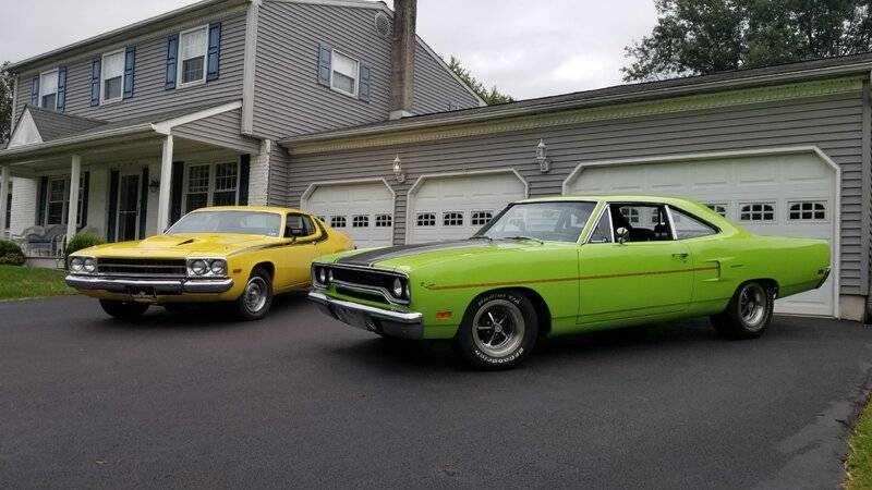

Took a couple of pictures of the two Road Runners today too! It was cloudy but what the heck!

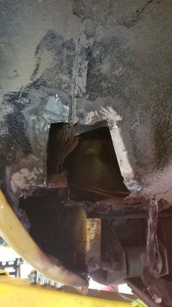

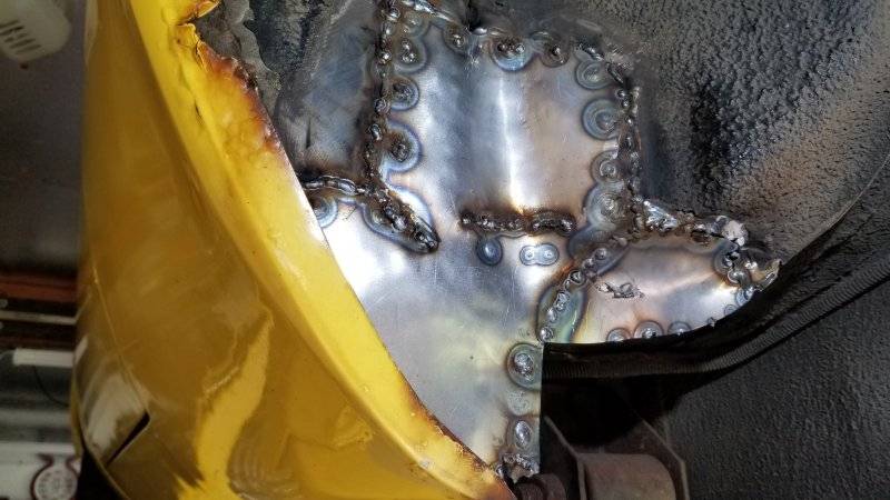

It's nice to have both of them running, although I still have more to do before I can really drive the 73. Most important now is the alignment - I will first try to do a better job myself, and then I need to bring it in and get the front end set properly. When that is done, I also need to get the big rust hole fixed in the driver side wheel well.

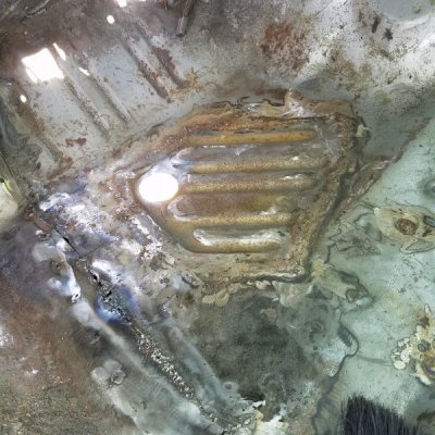

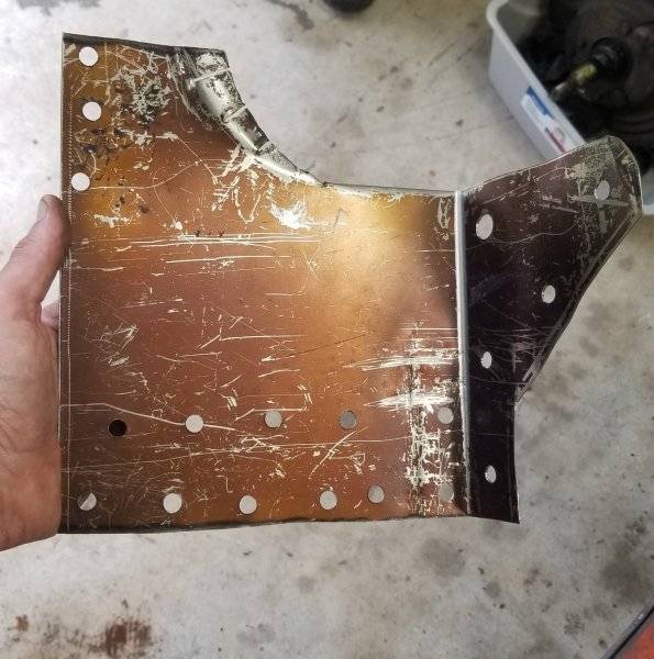

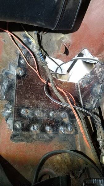

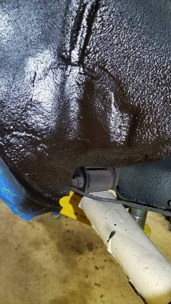

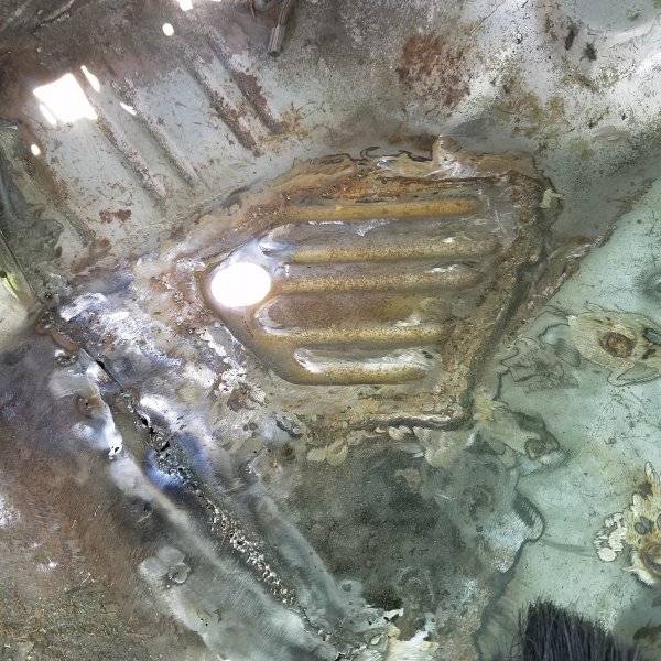

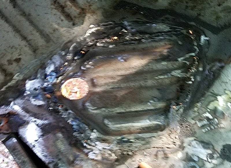

Thanks for the tips. You are another one blessed with the metalworking skill, and it has been really cool to watch your build thread on your 73! I figured this area is a great place to start, as the inside of the repair is hidden by the seat and the outside is under the car and in the wheel well, covered by undercoating.You are doing just fine, HAWK. We all have to learn sometime and you appear to be getting the hang of it. Low power, slow wire speed, and light touch goes a long way with old or rust thinned metal. Just be careful of what is behind and near the weld. Have started a few small fires in the past. Nothing a damp rag would not put out, but I fire that I was "sure" would not happen. There was a hole and now it is solid and that, Sir, is a plus.
... the next trick is how to bury it and fuggetaboutit
