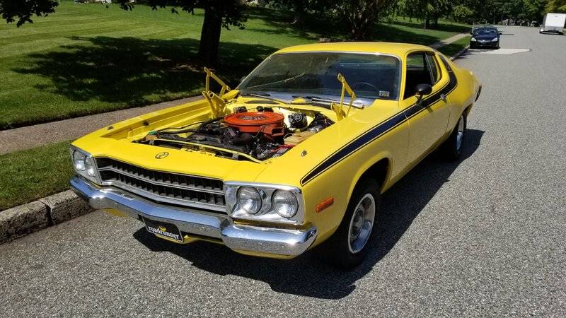

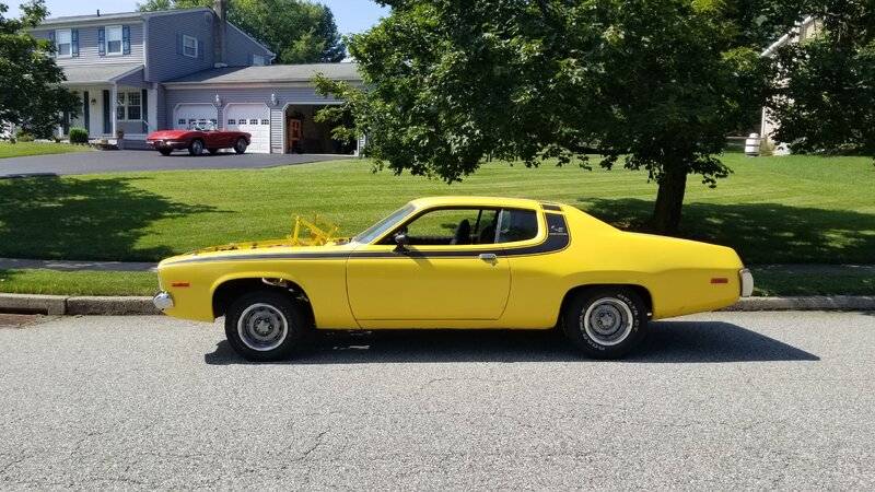

Here she is "out in the wild". I need to set the front end better, both to get the front wheel alignment better as well as lower it a bit, but I wanted to give it a chance to settle in an bit so I knew how much to adjust it.
Hard to see that little gem of an engine in there with that big air cleaner and A/C, but it's pulling hard when I put my foot in it! :D
It would have been a perfect first photo except for that C-C-C-Corvette in the background!
Yeah, that is my father-in-law's special car that he had for many, many years. 3 years ago, I became the new caretaker of it. It's a 340 horse 327, close ratio 4 speed and 4.11 rear. It is unrestored and runs and drives excellent. Yes, I'm a Mopar guy, but I'm OK having that in my stable too!

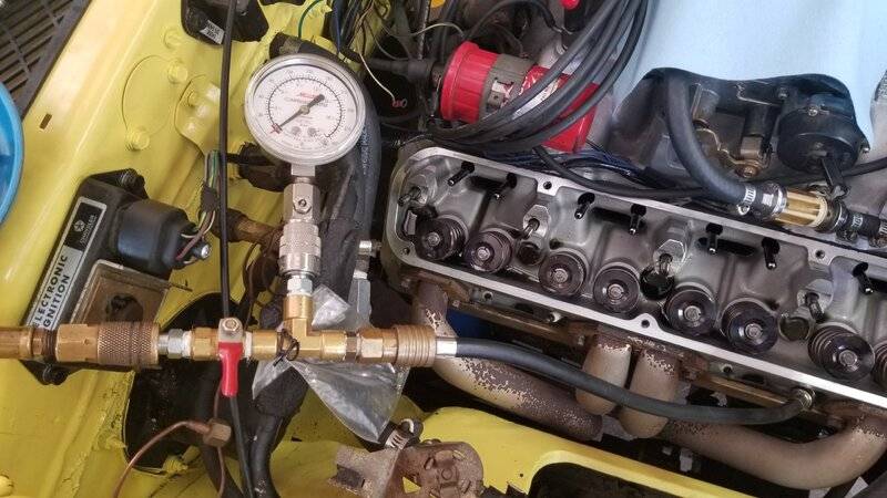

1st step is to remove the spark plug for the cylinder and put the piston at TDC. Then put compressed air into the cylinder to make sure the valves do not drop into the cylinder. The reason you want TDC is IF they do drop into the cylinder due to air failure, you can likely grab the stem and pull them back up. If they fall all the way into the cylinder life will suck and you need to remove the head to get them. An once of prevention....!

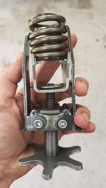

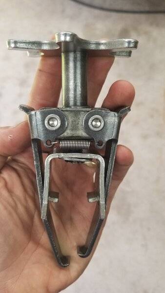

Here is the tool used to compress the spring so you can remove the keys.

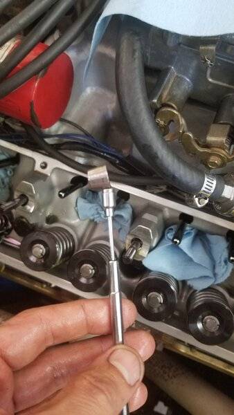

Once the spring has been compressed, pull off the keys. I HIGHLY suggest using a magnet as your big fat fingers are almost guaranteed to drop one!
Speaking of an ounce of prevention, stuff rags into the slots that go into the lifter valley. Again, life will suck if you drop a key into the lifter valley!
Tighten the tool (I like to pull up on it to lock the keys as I am tightening it). Then pull the keys off and pull off the spring.

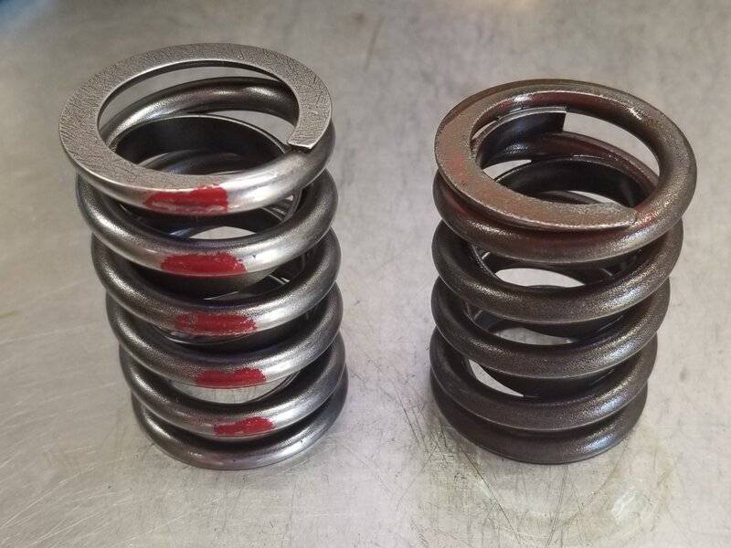

Here you can see the difference between the weak (short) and new springs:
Put the new spring on, and repeat 15 more times!
