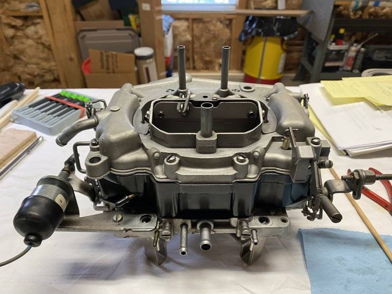

Here it is, done went together smoothly. Put it on the car Sunday. Thanks again for your advice and encouragement, much appreciated.

Hi Geoff,
Well it’s done, went together smoothly, all linkage good no binding anywhere. Hope to install Sunday.
Thanks again for all your help and encouragement much appreciated.
Ch,
I do not know if your particular carb has this, but at some point Carter changed the acc pump linkage to a two-stage design so that some pump shot was saved for when the secs opened. Very clever. Good luck!
