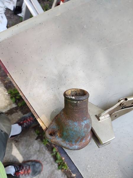

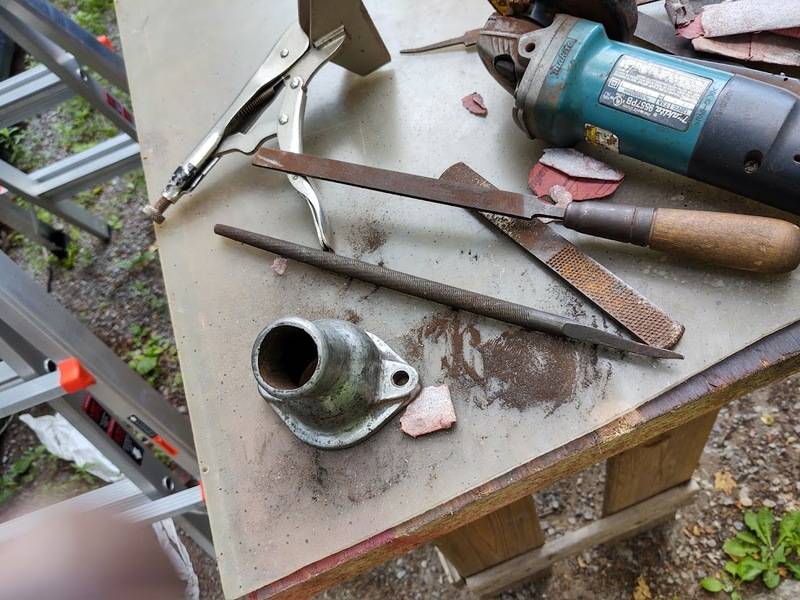

You can hit the top with a grinder and then a flap disc on the upper portion and it will look way better.

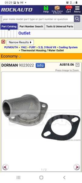

Personally, l like to use Permatex High Tak adhesive/sealant (brush on) on the hose ID. Although, i have used another Permatex profuct....windshield glass weather sealant....also known as "Gorilla snot"...its greenish gray....but remains pliable. I agree with the others....clean up your old t-stat housing and paint it....cast iron is rugged and durable.

A NOS thermostat housing would never be painted , I would expect a NOS one to be Bare. Please Correct me if i am wrong.
