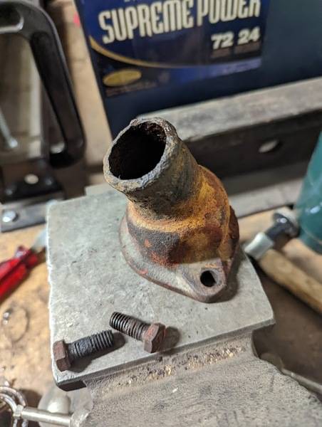

So I have a 66 Coronet with 318 Poly. This car had been sitting for awhile so I am going through the engine and replacing most of the gaskets (a lot of oil and water leaks). So I took my thermostat housing off and it's pretty corroded. Figured I'd just go on-line and buy a new one........... I can't seem to find any place that has the correct one. I find a bunch of the ones for A/C cars, but none like the one that I have, that is non A/C. Does anyone know of another part that will fit or will I need to hunt down an original? I attached a picture of what mine looks like. TIA.
Yours appear to be a '57-'60 unless yours is rusted through, or has badly pited sealing surfaces, you can clean it and reuse it. It all metal, not aluminum. Bone yards. I may even have one. Let me know. Ed

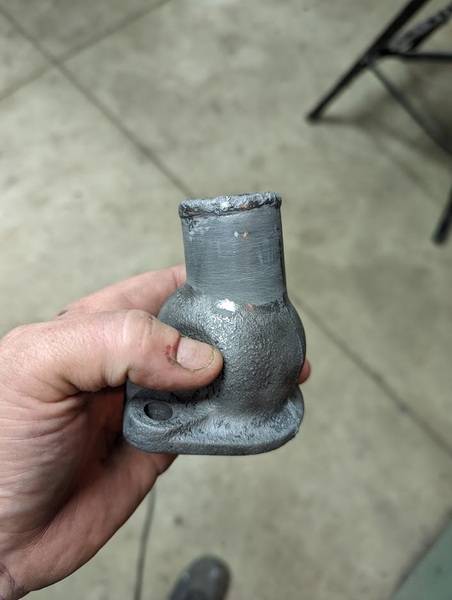

Well, whether it right or wrong, I blasted it and filled the pits with JB Weld and sanded it all down. The bottom surface was cleaned up and checked to make sure it was flat. I think I can get a good seal out of it now.
