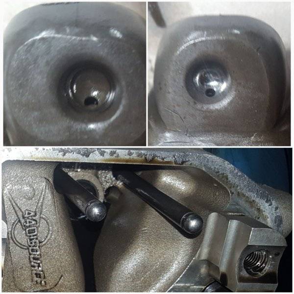

I'm not sure as there are different wear patterns, and this is new territory for me.
Some are worn on the top part of the ball, some have a ring worn at the top.

Where the pushrod meets the rocker, some rockers have a circle wear pattern just outside the oil hole, some have a full wear pattern from the oil hole to the center, like the pushrod is drilling a hole thru the rocker.
The rockers that are contacting the retainers are the ones with the full wear pattern.
This is essentially drilling thru the rocker, lowering it on the pushrod, which makes it contact the retainer.
My understanding is eventually the pushrods will punch thru the rockers.

Rocker arms are a long-winded subject. Many variations/designs, and such. Your two 'cup' photos, right side looks normal stock. Ball end of the push rod, fits into the cup, full surface, and rolls with the flow. (Yeah, I know, have my own way of saying things) Carries the load evenly.
Left photo, the cup isn't cut right, or the ball size is wrong, forming the 'ring' pattern. From what I've been seeing on parts, these days, not all are equal. One reason I refuse to use anything but stock, unless better is needed.
Remember that stock push rods are solid steel rods, with the ball end cut. Constant ball diameter.
If you question ball to cup fit, on rocker arms, you can always do a pattern check, using lubriplate, to see how it is. After-market stuff, is a toss up, you get what you get. And, it's all builder's choice!!
