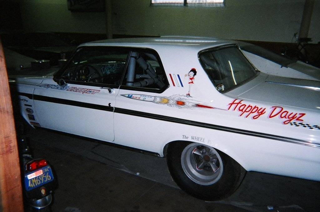

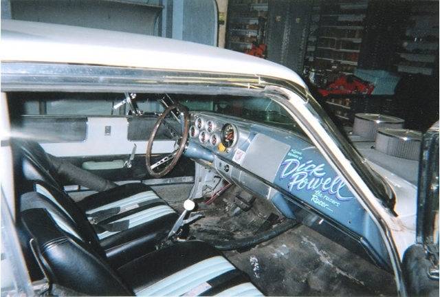

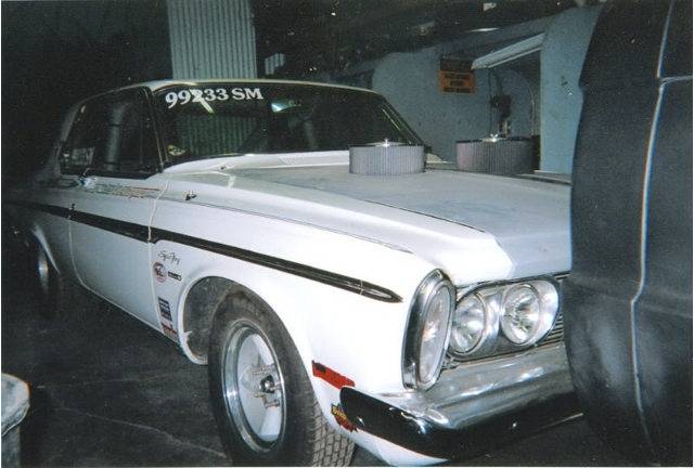

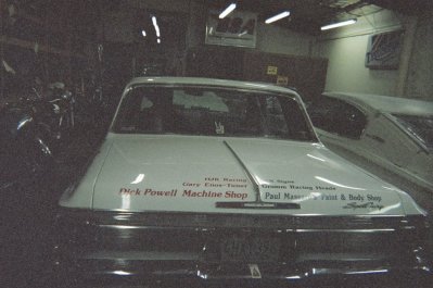

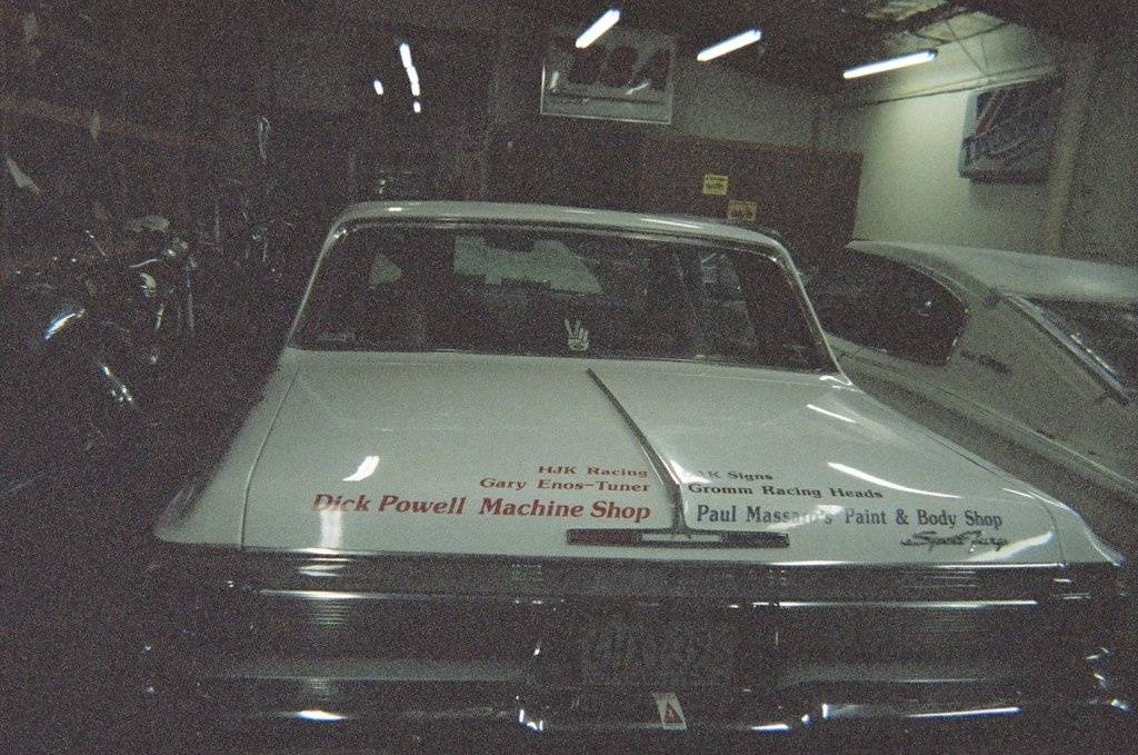

bud why not a bit of both , my 63 was all racer back when , now street strip , wippers not needed for a hotrod good weather car , charger system , battery were it is , lights with turn sig's , brake lights . muff'rs for the meek , and police , lol . street rubb'r . mine has drag radials on the rear for those rides that believe their quicker , runs 11.82 in this trim , on pump gas motor . oh ya lic plates , again just for the cops , lol .

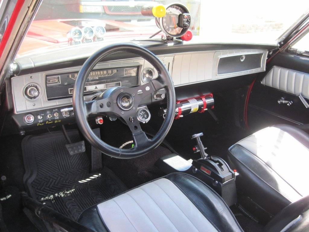

who said horn , that what the gas peddles for . put them behind you . lol . oh ya i don't take long trips in it , 4.56 8 3/4 lock'd . heater is the engine running and exhaust drop enough heat to want the windows down , there were stacked up . found some hotrod electric lifters . installed them , doors are cut up abit . it was a racer for years . switches are hard to see there black . right were the glass handles would have been .

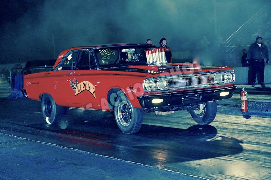

Definitely will have to replace the front Moroso skinnies and possibly the rear pie crust cheater slicks, those look great but not so good in the rain!
This is what it looked like when I bought it 2 years ago:

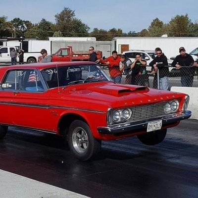

My 63 is street/strip car as its mostly street since I only race it about once a year. I have my battery in the trunk and I run an electric fuel pump as the electric pump is always a good idea to help fight vapor lock and fuel boiling with this cheap pump gas we have today. I also run a reverse manual valve body and I love it. Its a hotrod and I like shifting it myself. I do have wipers but I see many street cars that dont as they just put Rainex on their windshield's. The fuel cell is no problem on the street as many use them. Myself I still use my stock gas tank. I do agree with having a horn as its nice to have it when someone may be backing up and not see you as I made sure my car has a good working horn. Good luck to you , Ron
