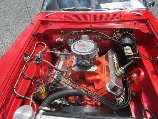

Myself I dont use a Victor or a single plane on my street/strip 493 as I use the Indy dual plane intake because I drive the street most of the time and my car weighs 3700 lbs. I am very happy how it drives and how it runs at the track. Would it be faster with the Victor or a single plane ?? Well I may try a single plane one day just to see how it does. Also the Victor is kinda tall and I know it wont fit under my hood. Here is the Indy dual plane I use as its kinda like the RPM but with larger volume in the ports. And you can see how its open underneath it so air gets under the intake. Ron
