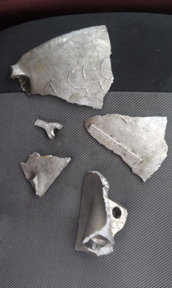

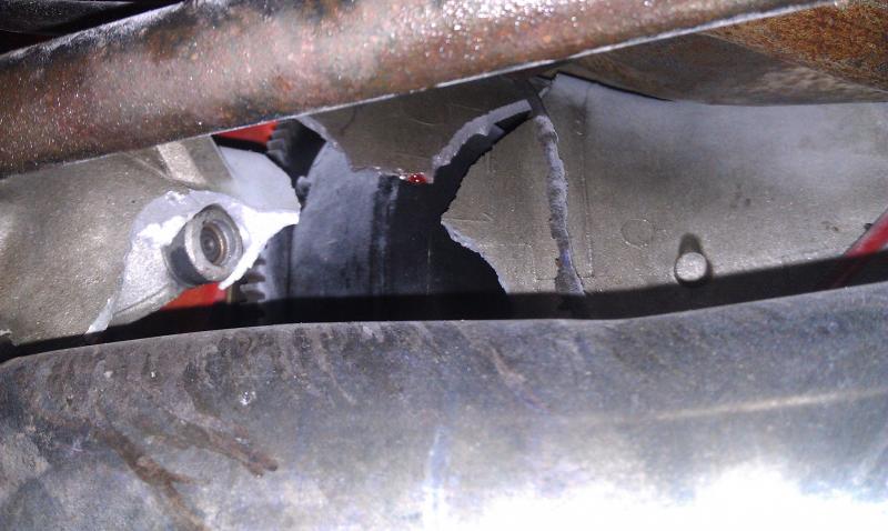

Preliminary pics
Here's a shot looking from the drivers side. You can see the starter lying on the header and the torque converter. The crack runs all the way around to the other side! The other pic is pieces that I picked up from the edge of the road.....:icon_scratch:

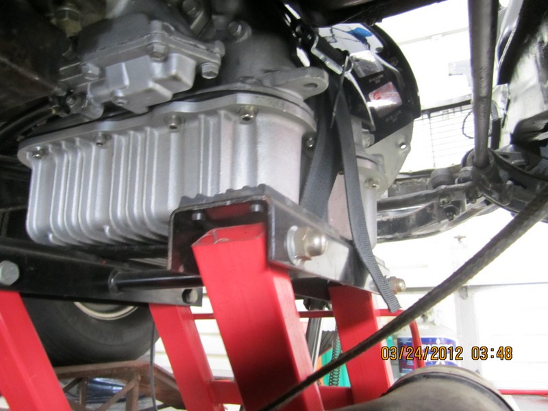

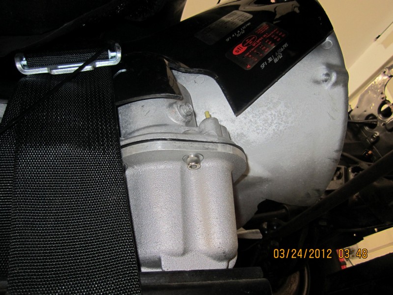

Yes,,, A scatter shield and driveshaft loop is completely in order! I used to use a trans blanket, but it was always kinda messy non form fitting.... I like the new type of shield that forms to the bellhousing and runs back behind the front pump. I think Hemi-itis uses this type as well in his car...
Gave the blanket to my friend Joe for his Nova.I just put the Engine & trans back in yesterday with the new CSI trans sheild:headbang:
