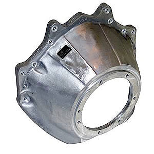

Here's a photo of the Ultra bell
JW Performance trans Ultra bell, I think

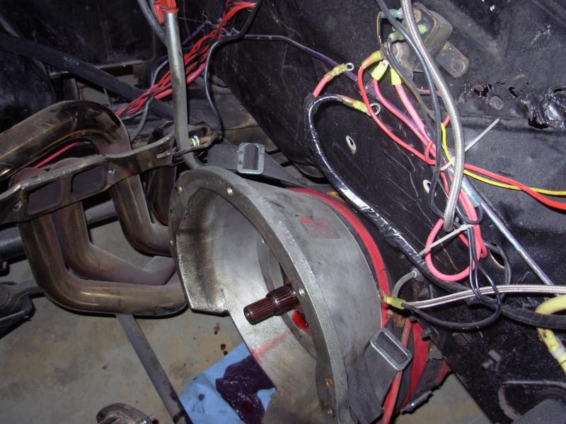

Well half the work for the JW bell housing conversion is done already!:rofl:

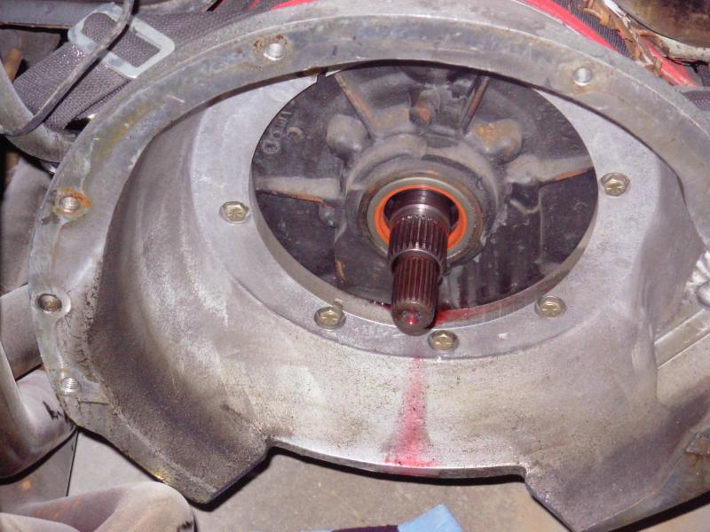

This is what the JW bell housing looks like.My son and I pulled the motor earlier.We got it down to two hours thirty minutes cleaned up.We got done,I looked at the clock and went holly **** that was fast.Any ways here are the pics.

I already told my wife the same thing when I came in from the garage... LOL!
I did find a few other suspicious things though.... I'm not sure if the were a result or the cause of the trans failure...
First on the list, The two bolts that hold the trans tail mount to the trans were missing. The tail was resting in its correct location, just no fasteners holding it in place!
Secondly, the front U-joint had a cap fly out of the yoke! I found the inside clip lying inside of the yoke / joint area kinda stuck in there... Not sure how a clip comes out, but it was not attached to the missing U-Joint cap!
That's all.... No other signs of failure anywhere else.
Perhaps the bolts came loose and worked there way out of the mount a while back and was never noticed. Then the failure of the U-Joint slinging the cap out caused a severe and immediate vibration cracking the bellhousing?
Maybe the U-Joint is completely un-related to the trans failure? It all happened in the snap of a finger! No vibrations or noise leading up to the big BANG!
I sure like the looks of that bellhousing! NICE!!!!!!
If I could find a used one somewhere that would be nice, but I doubt I ever would.
I think there almost 400 dollars new aren't they?
Hell with it! I'm going to look this thing over real close, and if I see nothing else damaged on the trans, I'm buying a new JW bellhousing by the weeks end!
Even if it doesnt work out with this trans, I have a real nice offer to purchase one CHEAP!
Missing tail shaft bolts is definately the cause of the carnage.Even the damaged ujoint.Pull the tailshaft housing and check the bushings and side play.The damaged ujoint will eat up the back half very quickly!!!!!
They were the trans mount bolts...... Not the tail housing bolts. Not sure if that's what you meant or not, but I thought I would make sure I was clear in the previous post.

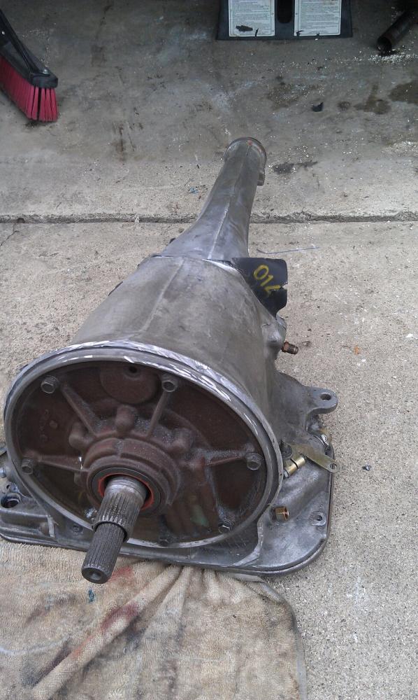

Well, it's ready for the new bellhousing....:hello2:

You are closer than you even know.A little fitting and grinding you are their!!!
You should go through that trans before you buy the superbell.Just make sure that case is in good shape,you never know untill you look.Last time my trans was redone,we found a few cracks:icon_sad:
I looked over the outside closely, and felt for play in the shafts.... It doesn't appear to have any damage that can be determined from outside checks. It was unused from trans shop when I put it in last summer.....
I think at this point, I would have to strip it down to see anything else, and a rebuild kit would cost more than the deal I was offered on a trans with low milage.

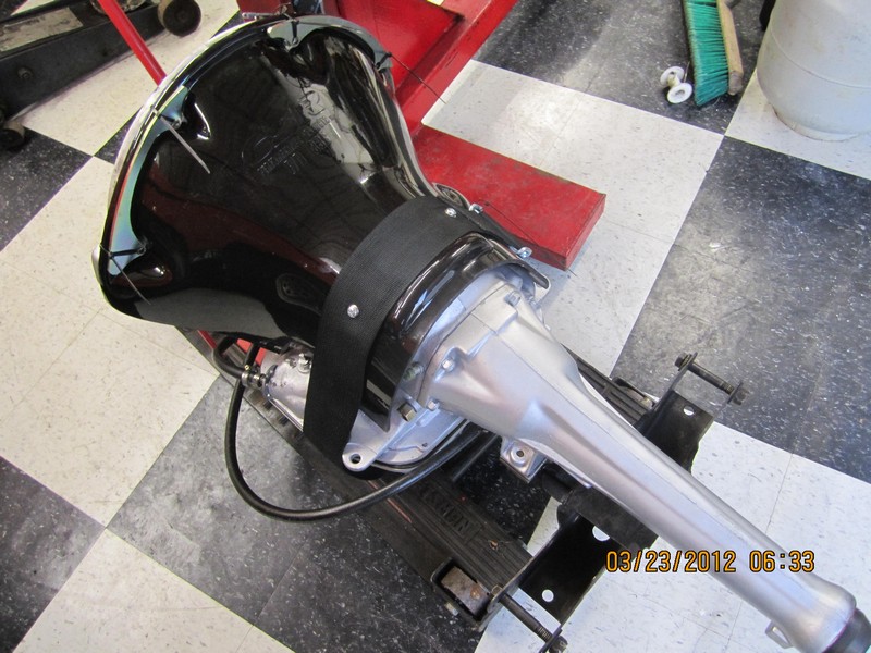

I can use the bellhousing on any trans I end up using and get the SFI cert without buying a trans shield.
You would still need a trans blanket to cover the trans.The CSI sheild covers the bell & trans:cat:
I priced the one you have "csr",,,,, costs about the same as the bellhousing! Very nice piece, but I think in my case, the bang for the buck goes to the JW ultra bell.
I found an unused blanket for 50.00 or best offer.
