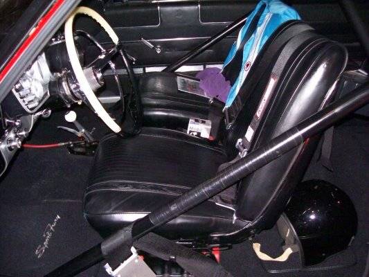

I have the B&M Quicksilver shifter mounted in the factory console of my 65 Sport Fury. Just mount it so the shifter lines up in the factory slot. I went with the Quicksilver as it looks like the factory shifter (sort of). If you go with an aftermarket shifter, do yourself a favor and insulate the shifter cable (no matter how you route it).
Not the best picture, but all I have at the moment...
