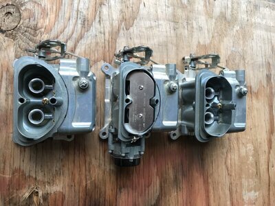

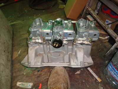

i just bought a barry grant six shooter setup for my driver 383 , these carbs are only 250 cfm each . should offer up good fuel mileage and good throttle response . its for my wifes cool driver . it will go into her 65 bel rag i bought her . she doesn't know about the buy . plan on surprising her with it . i've been hinting around about color and car nick names . but i have so much stuff going on . i still think it will be a surprise . what do you guys think , anyone used them ?

I dont know much about the six shooter setup, probably because i thought of it as a very expensive, small cfm setup for a small block chevy. I would guess the carbs would be similar to 2300 holleys. i dont know of any reason they couldn't be made to work. They might be a little small on a 440, or they might work great? I have seen tests of that setup on a 350 chevy but frankly, i dont remember any huge performance benefit, but i do remember a huge "suggested retail price". They struck me as almost three grand of eyewash for the ratrod crowd.
Edit: i do like the annular boosters, but that might be another reason the rated cfm is small.
in this setup i'm looking for look of course . but the wife doesn't need a racer . just a good driver , and fuel mileage is also a item on the list . the little center carb should get good wind speed for a good throttle response . and if she needs speed . well two 250 cfm carbs are right there to feed out 750 total cfm . thats plenty for a mild 383 . even my hotrod driver has a hot 383 and runs less cfm then these . can't see a down fall do to cfm . cost was not near retail on these .
Missil, for your stated purpose, it sounds like they should work great. Id love to know what you had to give for the carbs, but it's not any of my business so i wont ask.
Three 250 cfm 2 barrels dont equal 750 if you rate them the same way 4 barrels are calculated, your probably closer to 530 cfm
Edit
Sometime during the 1950’s, engineers found that a passenger engine with a four-barrel carburetor would not maintain a vacuum of 3 inches of mercury at wide-open throttle; and by some convention 1 ½ inches of mercury was chosen for rating 4-barrel carburetors. The ratings for 1-barrel and 2-barrel carburetors were left unchanged.
To convert from one system to another (with a very small percentage of error) is relatively simple. Simply use the square root of 2 (1.414). Thus to convert a two-barrel rating into a four-barrel rating, divide the two-barrel rating by 1.414. To convert the four-barrel rating to a two-barrel rating, multiply the four-barrel rating by 1.414.
