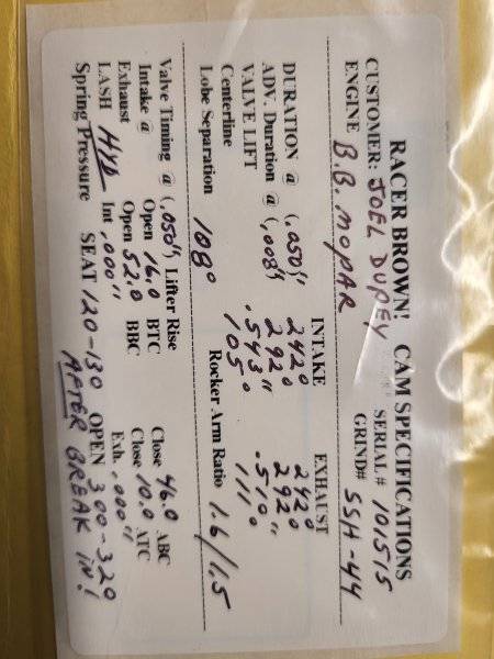

Hunt, what cam did you use? I think I saw on engine masters they had a 30-40hp difference between the 240s & stealths?
From post #5
I'd say your 451 is pretty good. My 440 has 9.9:1 solid roller 238/242 600 lift with the 1.6 HS rockers. 6bbl, it made about 550 tq & 590hp

I did. Everything was left the same on the motor except the head swap. It gained 29 hp and 9 ft.lbs. The compression ratio also went from 9.7:1 to 9.85:1 with the Trick Flows. The only variable in the whole deal was that I had a different shop do the head swap than first built the motor, so different dyno's. So in all honesty, there could have been more of an actual gain.
