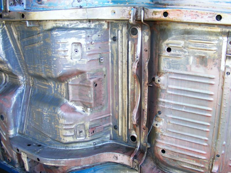

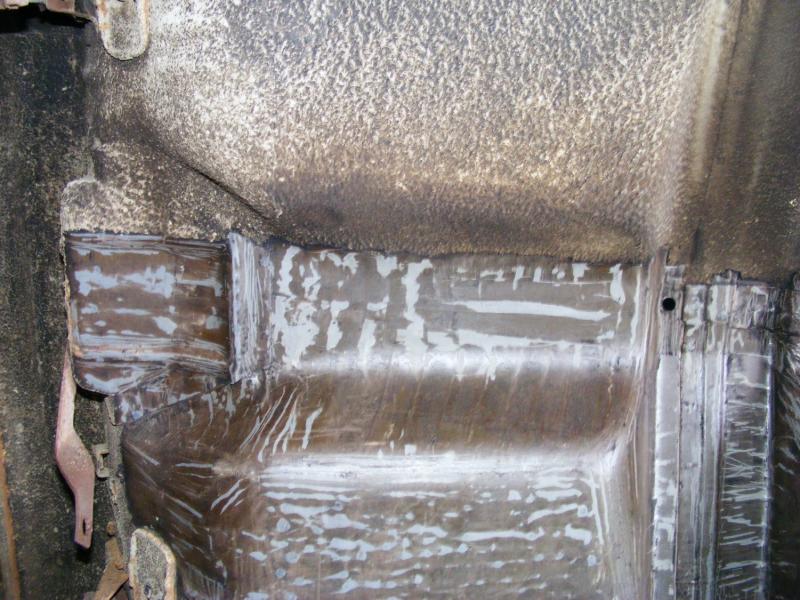

I researched and listened to everyone's advice and then put the car on my rotisserie and started. I bought a Wurth seam sealer remover with the round "Hooked" wire wheel and got a half-dozen propane cylinders and went to work. The undercoating around the transmission where the fluid leaked out and was slung onto the tunnel came off in a flash! Soaking in ATF for 44 years works! The large open areas came off alternately well with the 1" wide scraper and the Wurth air tool. The tool ran me about $350.00, but I needed it for other work anyway, so I wouldn't buy it for just this purpose. When all the undercoating was removed, I wet everything down with "Gunk" Engine degreaser and let it soak overnight and then pressure washed it. To finish, I sprayed the whole undercarriage with "Super Purple" degreaser from Menards and then pressure washed it again. Lots of work, but I'm glad the undercoating was on the car, or I'd be replacing the floor pans! Suck it-up and get to work. It'll be done before you know it! Check out the pics.

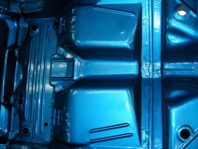

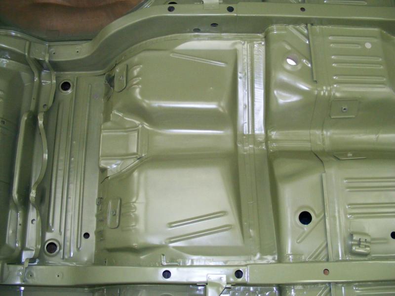

O.K., so it's all off now and I'm glad I don't have to mess with it anymore. I also had the whole bottom media blasted and I used a DuPont epoxy primer. Then I shot on the color immediately. I will own this car for a long time, and will be proud of the work I did to make it look better than it did when it rolled of the line at Lynch Road!
