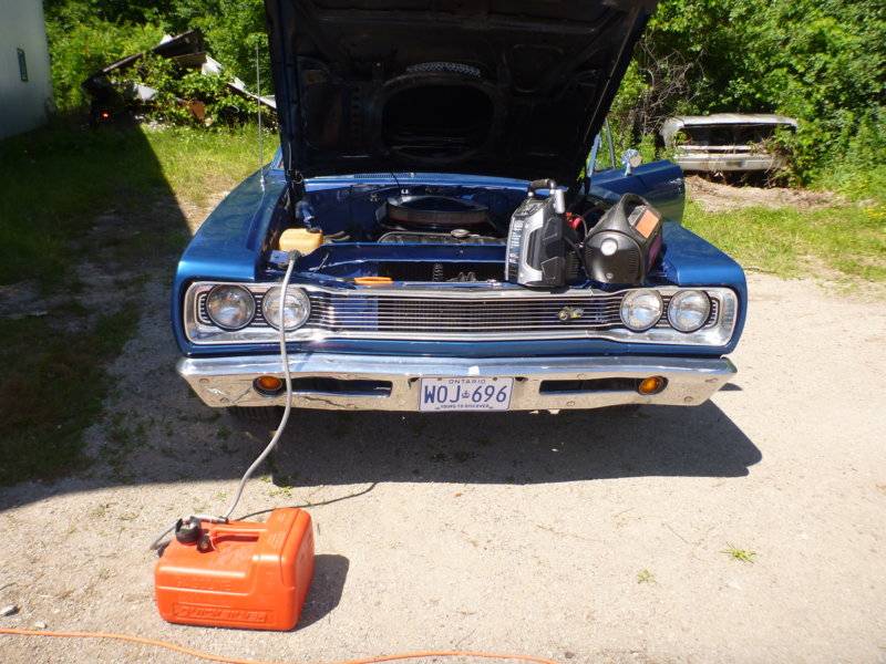

Had to deal with an old pickup once, that wouldn't start, and had old gas. Rigged a fuel hose from a gas can with fresh gas, to the pump, and it fired right off.
