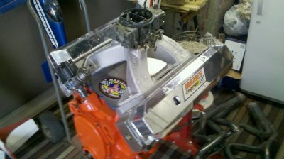

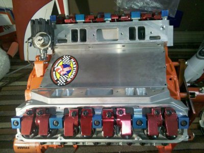

I agree the surging idle and lazy rough revs sounds like vac leak. The slow return to idle sounds like ign advance to high. I cant have it leaking to the lifter vallley though... I doesn't employ the valley pan type intake gasket. I use a valley cover, and two individual intake gaskets. I'll post a pic of it too.. I did however get the idle mixture to seem like it didn't need to go any richer. I could hit the acc pump arm and not have a rev up associated with this action. Only thing is, that I had to run the screws out around 5 full turns to get it this way!

im still banking on a lean condition. i had a intake gasket leak between intake runner and lifter valley. i have seen heads and or blocks surfaced so much that the intake doesnt set low enough for the passages to line up right. everything you talk about just sounds like a vacuum leak somewere to me. leaks at the intake manifold gasket are hard to locate with carb cleaner method. only takes a few minutes to pull the intake and look at gasket to see if its been fitting together ok.
