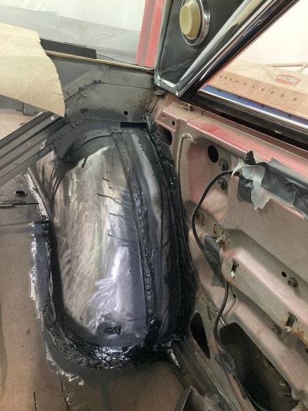

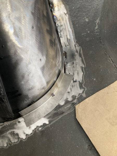

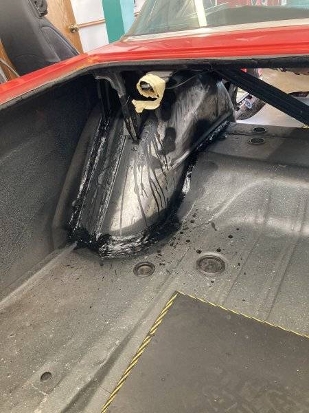

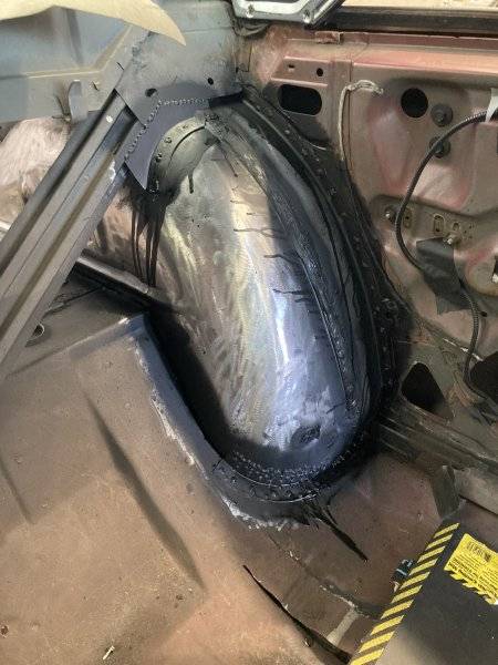

Last week I was able to get the trunk side of the tub secured to the floor. Added the USCT brace filler for the trunk hinge pillar, after I cut it in two and redid some of the bends to get it fitted better. Today I reset the brace I removed, goes between the diagonal floor to package tray stiffener. Also made up a couple of filler pieces to go between the floor and tub, got them welded in too. Once done with all of that, scrubbed the welded areas down with the stainless toothbrush and vacuumed the areas. After that, I hosed in some of the Eastwood inner frame protection to the welded areas for rust protection backup prior to tomorrows seam sealing. I took a picture of my modded Eastwood spray wand so you can see the change. The brass nozzle has multiple holes so it can do a 360* pattern. What I wanted was a jet to force the spray material into the seams. For that I used a 18-22ga butt connector that is partially squished down. Worked great.

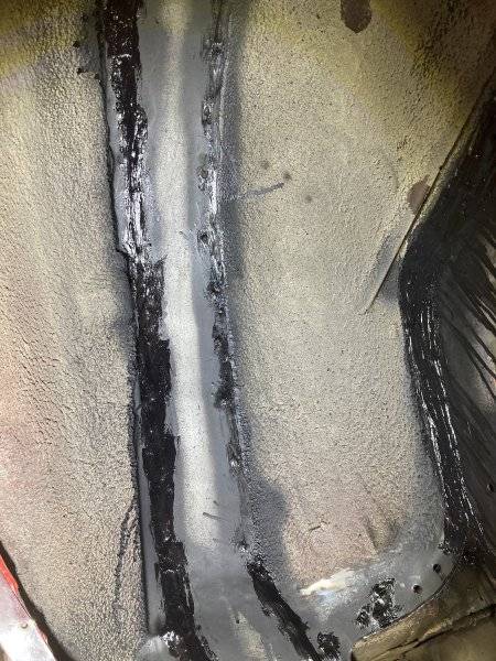

For some reason, my garage smells heavily of polymer paint materials. Wonder how that happened? Ha! I put the seam sealer on today. Used up a tube and a half. Coming soon, cleaning off parts for POR15 and other rust treatments application followed by loading springs/sway bar/diff in for good. Hopefully.

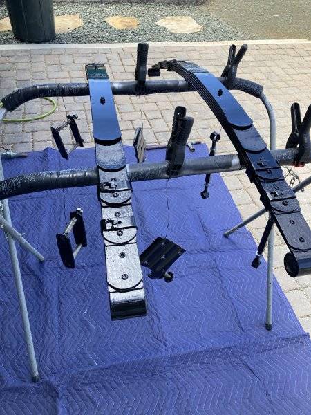

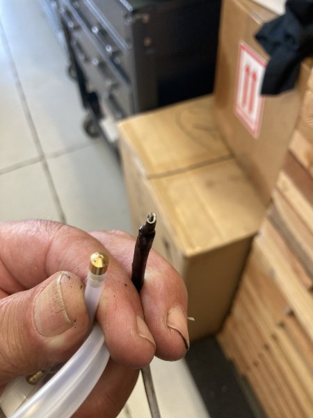

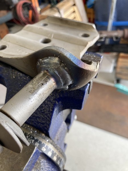

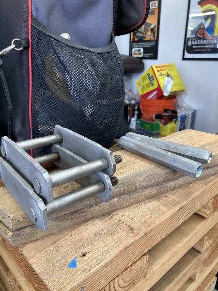

Today I did some blasting. After a couple of hiccups to deal with on the cabinet, pressure hose to gun popped/replaced it with a piece of 1/2" a/c barrier hose as thats all I had in that size that would take the pressure, then the hopper feed hose kept kinking. I pulled it out and found a spring that fit inside to stop the kink. Then the lh glove came undone from its holder, got it dealt with. Once housekeeping was in order, I blasted the spring/shock plates, shackles, rod ends and adjusters for the sway bar. After I got the plates cleaned off I had a look at the shock stud. The studs sometimes pop loose so I figured, what the heck and threw some welds on. One less thing to worry about down the road. Tomorrow I'll continue getting pieces cleaned off and ready for some paint.

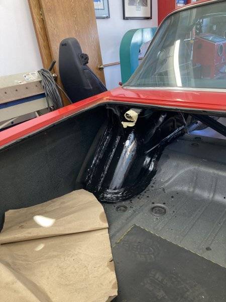

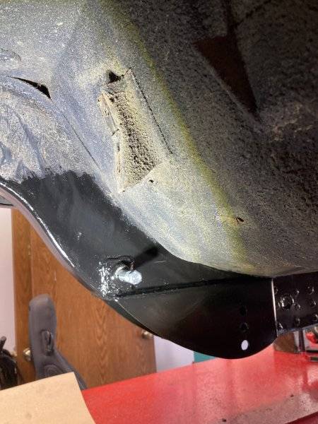

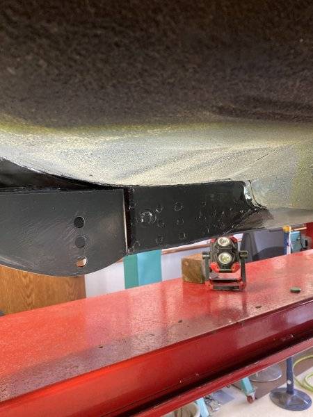

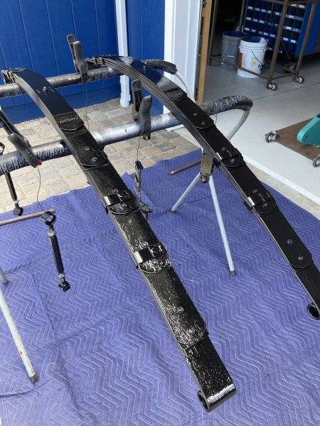

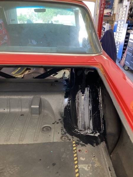

Getting some POR15 applied today. Just brushing it on, saves from overspray hassles. The material is fairly thin so if someone were to spray it, it's probably ready as is. I figured it would be thick but this works out. It does appear to be self leveling which is great.

It flowed out fine, was not sure if the brush strokes would show but its all good. I have about the same time in for parts as you. Just not much heavy unless you count Isuzu. Split between stores and dealers. To me, working at a store is like being a short order cook. Knock out stuff quick with a vast menu. Dealer parts is way more in depth, focused on a specific make unless it's a multiline dealer. The only domestic I have not done was Ford. Oriental did 80% of those and about the same on Euro. On an earlier post Greg mentioned flexing my Mopar muscles. I would check stuff out, on my between customer time, to see if I could use other parts for improvements on the cars. I would take in a tape measure or pair of dial calipers to check stuff out. While the vast majority of my co-workers were not car guys/gearheads, I couldn't get enough. When I worked at a Benz dealer in the mid 80's, I was starting to check out the trim clips MB used to see if they would fit my stuff.
On the POR15 not having any UV protection, you are correct Greg. For underneath or areas that are covered up, it will be fine. I will be using it in the engine compartment as my base protection before doing filler/primer/color.

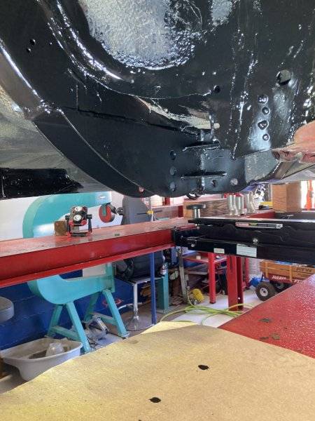

I applied the material to the topside of the springs then figured, what the heck. I scrubbed some of the underside where I've been working and got some 15 applied there too. Will do the second go around here in a bit. Tomorrow I'll jack up the back end of the car, just ahead of the springs, and pull the cribbing out of the back end. Its in the way of me getting 15 applied to the shackle area.

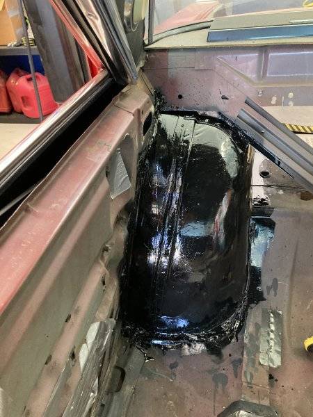

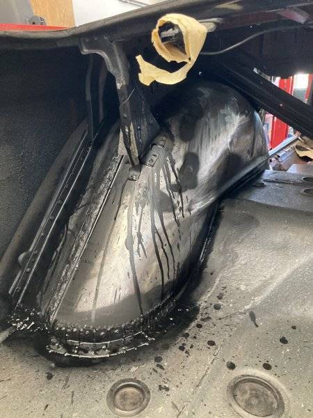

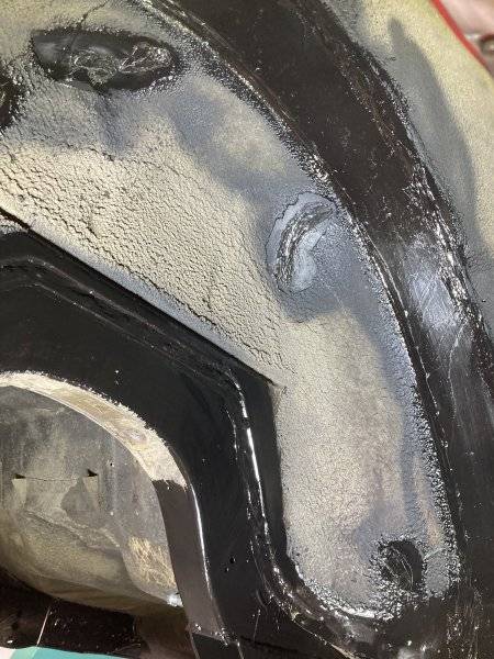

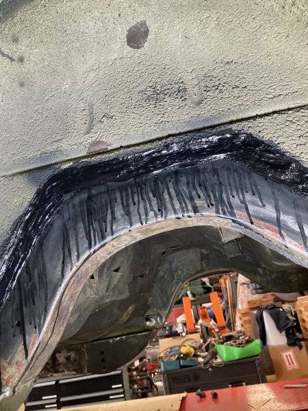

Before I removed the cribbing, I shot some undercoating onto the wheel side of the tub. Need to get more but at least the first load is on. After moving the cribbing I put the first load of 15 onto the shackle area, let the lift down, then hopped inside and applied some to the topside of the tubs. In a few hours I'll put the second coat on.

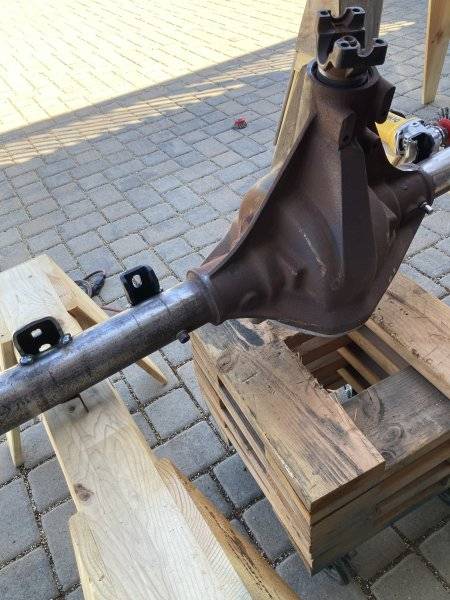

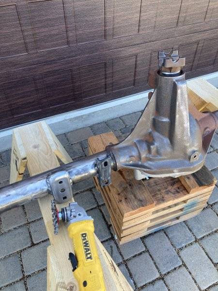

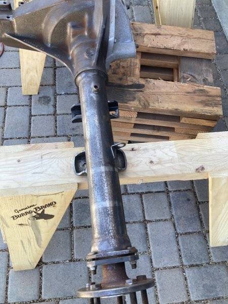

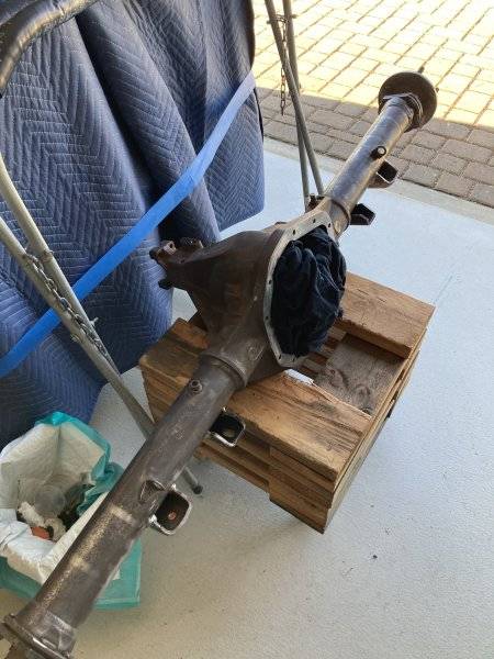

Today I put the new urethane bushings into the springs. Old ones had the 2" opening for the original springs, new HD units were 1.5". Will keep the old urethane units in reserve in case I need them for another project. From there I wrestled the diff outside to get as much of the rust off as possible prior to POR15 application.

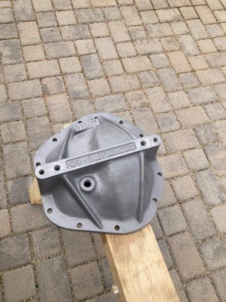

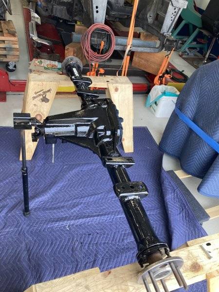

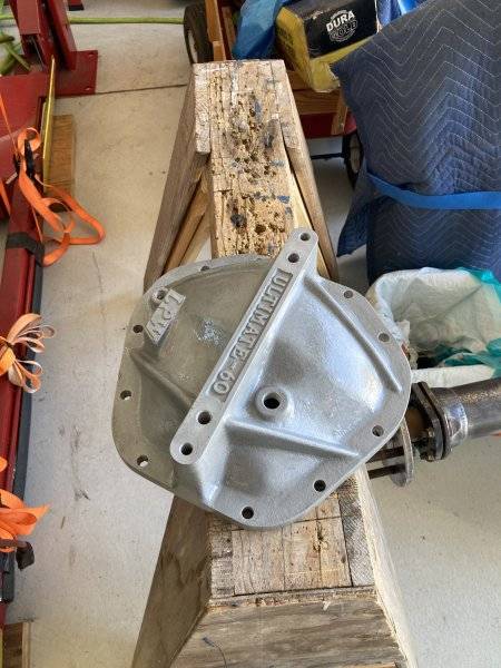

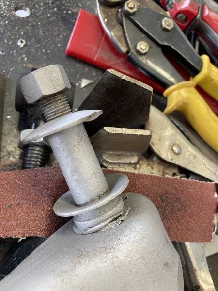

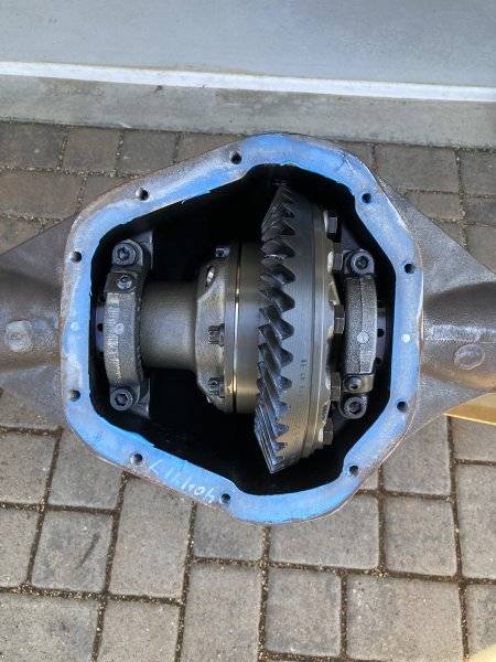

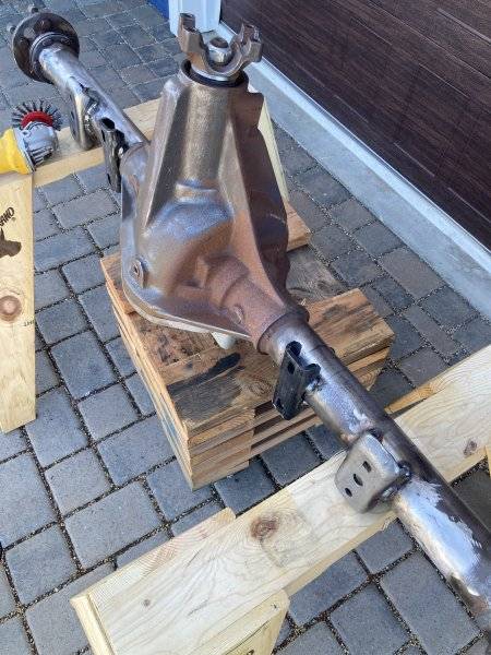

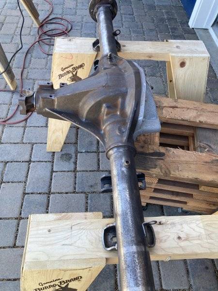

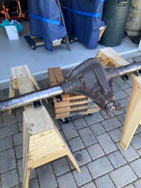

Yesterday I was able to finish scrubbing off any of the rust that could be gotten at without full disassembly of the unit. I took the wheel bolts[ these screw into the axle flange] out, used a hamburger wheel on the axle flange to clean off rust so when the rotor goes on, it's flat. Cleaned the threads of the bolts, put them back in with some red loctits. Removed the cover, cleaned off the sealing surfaces, blasted the cover, cleaned it off then coated it with Sharkhide for protection. Today I'm painting the diff with POR15.
