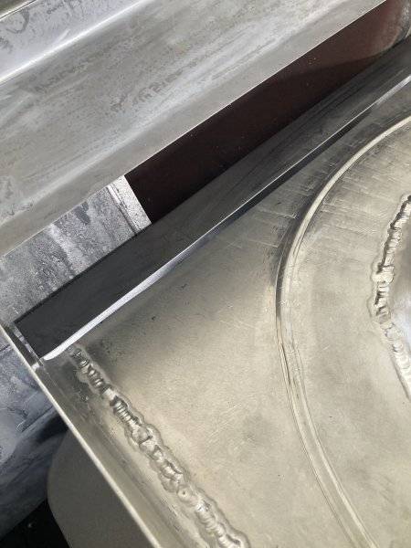

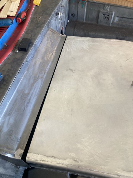

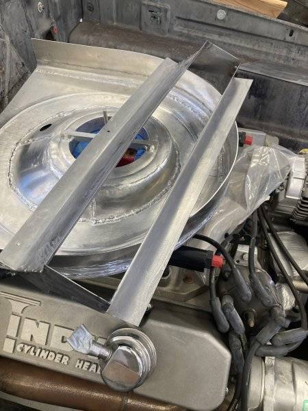

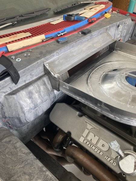

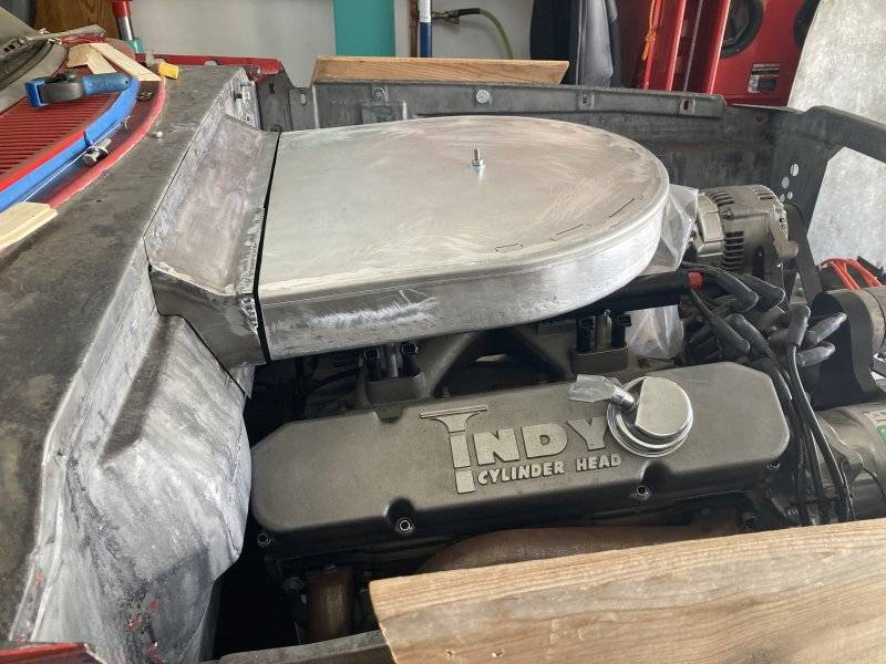

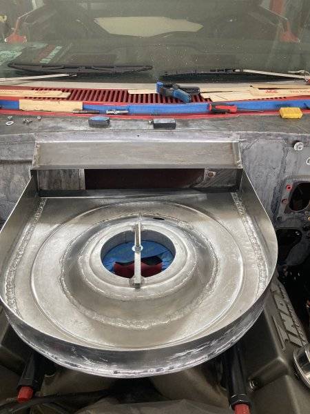

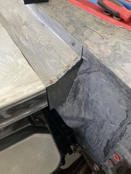

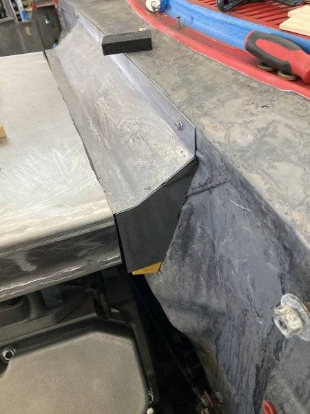

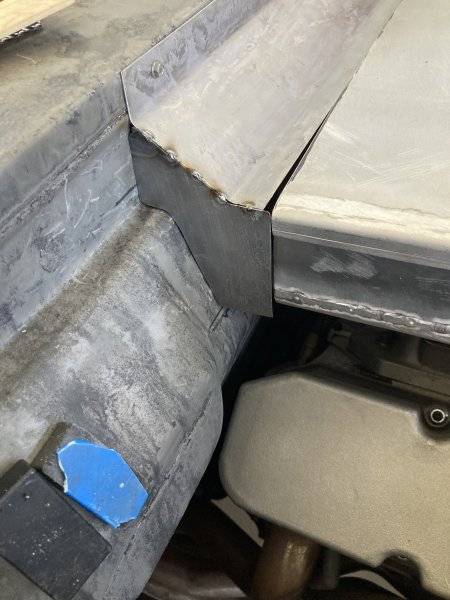

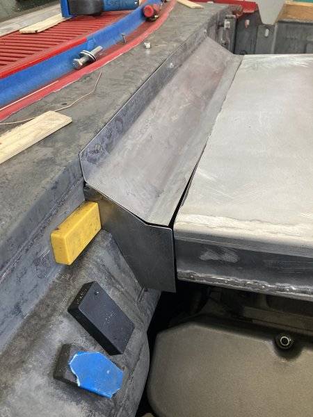

Put it on with screws and a seal. Once I determine where the screws will be, I'll put in some Nutserts. Paint the Nutsert with POR15 and crimp it in while wet. Not welding it will allow me to get some rust protection into the inner cowl area.

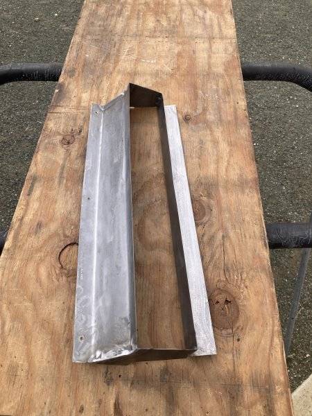

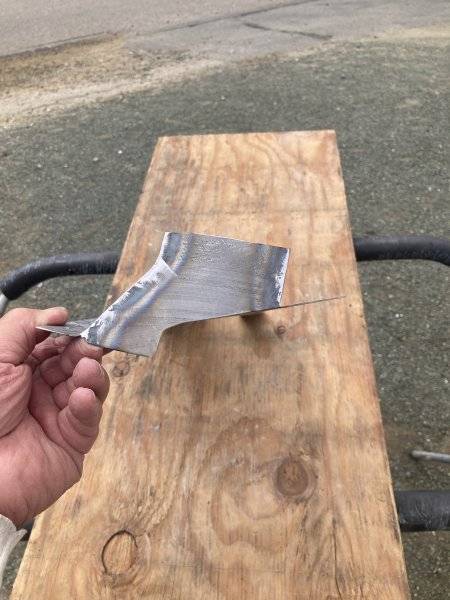

Today was successful. Got the firewall portion of the duct made.

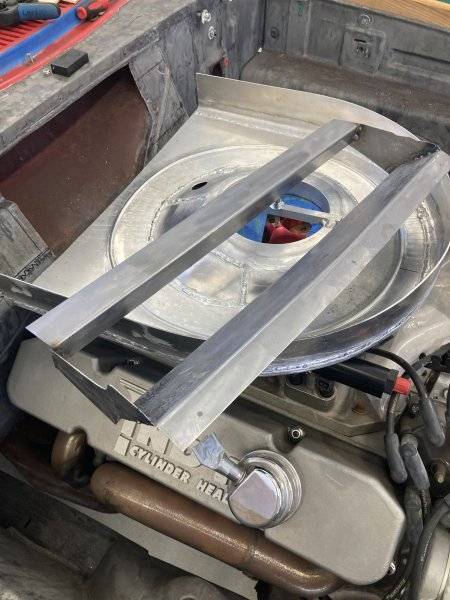

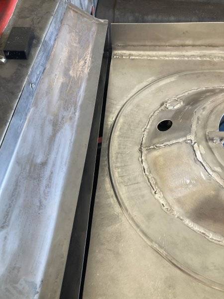

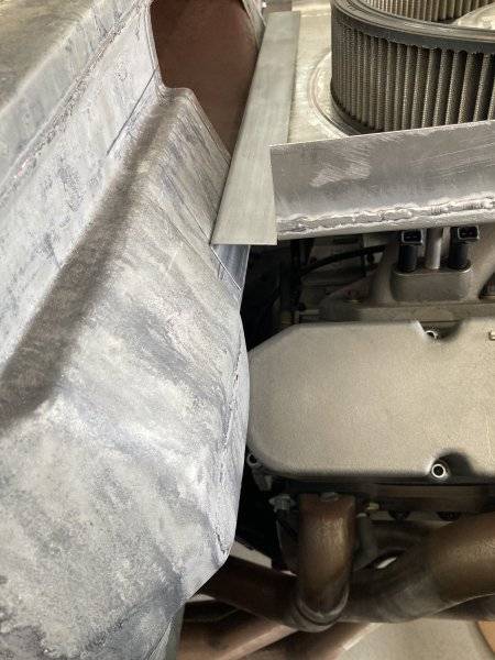

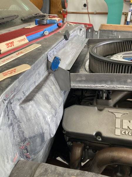

How will it handle engine vibration? You might want to leave a gap between the air cleaner and the cowl duct and bridge the gap with a rubber seal…
Going to have about 1/4" or so gap between after I trim the aluminum. I'll get ahold of an inner tube and cut a strip out, 2" wide or so and wrap that around for a seal. Tie the ends together with some sort of latch/buckle unit.
I wondered about that too. Any engine with any level of performance camshaft will vibrate at idle. Any hard shift will jerk the engine around too. This will result in chipped paint or broken welds if there isn't some sort of cushion somewhere.
Using a cloth tape, I got 42" for the wrap. Figure cut a 4' strip, 2" wide, so there is some material to wrap back around whatever I use to cinch the ends together.

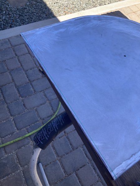

I marked and trimmed the aluminum housing so all is groovy now on gap.

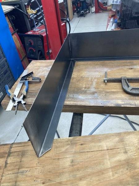

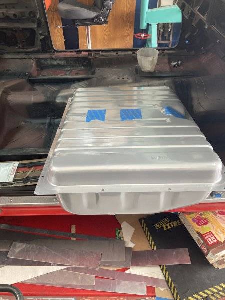

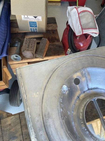

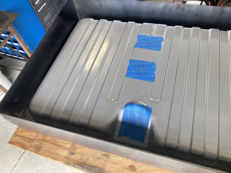

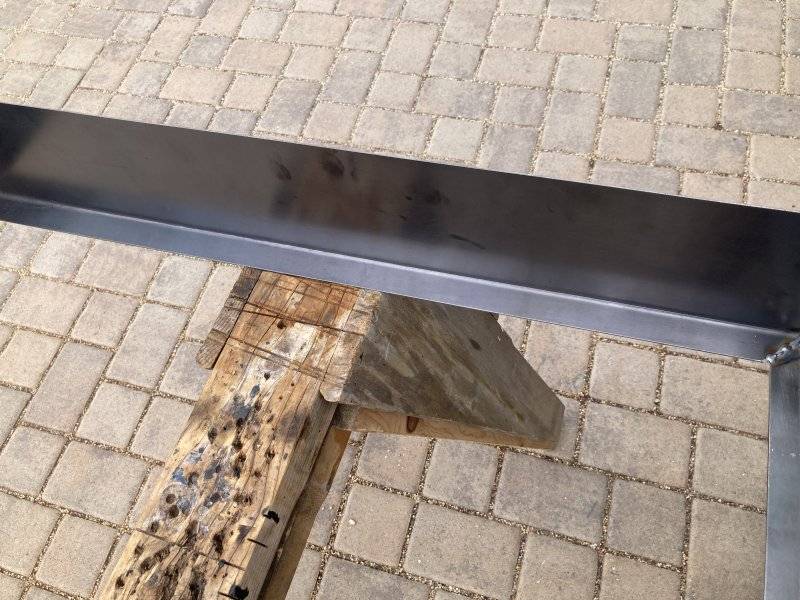

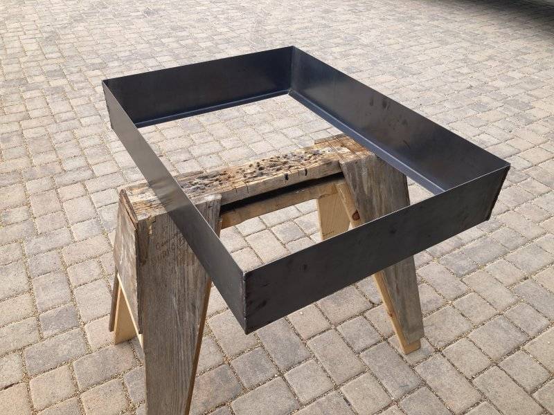

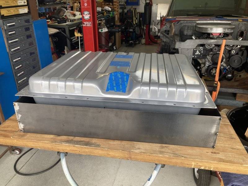

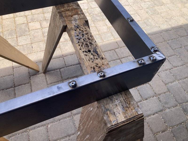

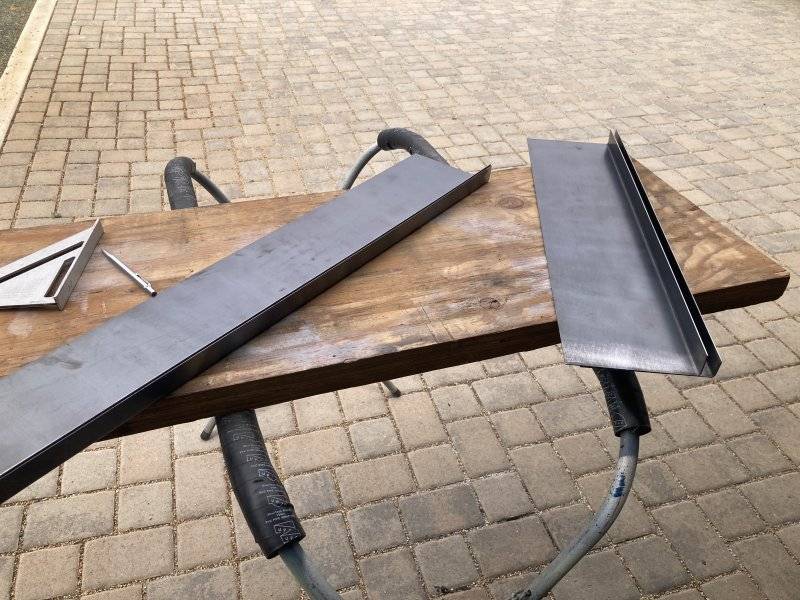

I wrapped up the air filter a couple of days ago. I'm going to wait on coating it until I put the fenders and hood on for a check fit. I should be ok but want to make sure. Had a b-day last week so I spent the gift funds I received on my fuel tank. Using an MU-2HT from Tanks Inc. Universal 22 gal, EFI ready early Mustang. I have test fitted a regular Mustang tank in the area last year so I know I'm fine, other than I need to modify the floor which was already planned anyway. It came in on Monday and looks fine, shipping wise. Yesterday I went to a local rod guy who has a stomp shear. I measured and marked out some 18ga hot rolled sheet material I have. Was initially thinking to use 16ga but didn't have enough and figured 20ga may be too light. I thought up a way to hold the tank which is what you'll see. The sides are long so there is enough material to trim if need be. After cleaning the cut pieces with Acetone to de-slime them, I roughed up the material with the carbide bristle drum on the SCT unit. From there I put each piece into the sheetmetal brake and bent a 90* flange 1.25" wide for the tank flange to rest on. Ground the welds on the outside down till it was time to knock off and feed the kids. Tomorrow I'll hit the welds on the inside corners to get them flattened out. After that I'll set the tank into the nest and mark holes to drill so I can weld 1/4" flange nuts on the bottom side for tank mounting. I was initially thinking to use nutserts but didn't want the possibility of one or more spinning in the hole at a later time. I'll make up a seal/cushion to put between the tank and nest to prevent rub through.
Damn that's a good idea for going EFI.. and i always liked how ford mounts their tanks
The engine I got from Indy is EFI from the get. I like the adjustability of multi port, sequential. Further on I'll make a lid to go over the top of the unit for protection and accessibility in case a pump/sender/gasket etc needs to be replaced. I'll most likely put some dimple died holes in the vertical wall of the nest to help vent out any potential fumes. I do plan on using a charcoal canister too for fumes.

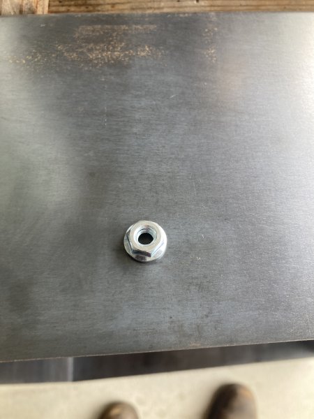

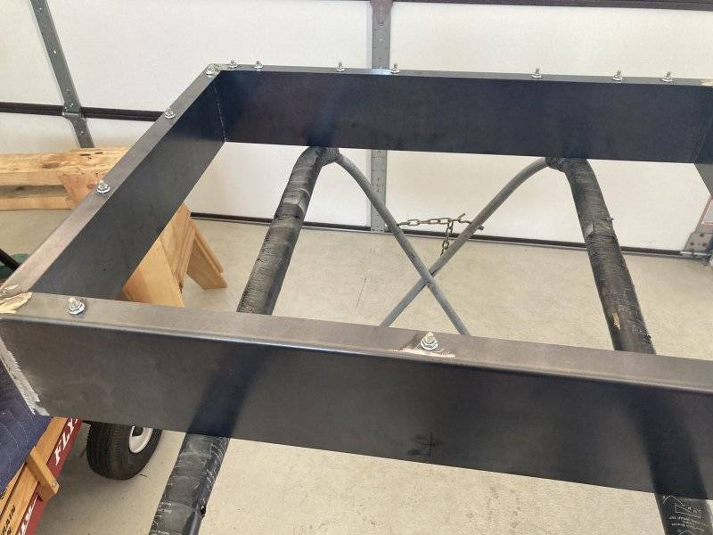

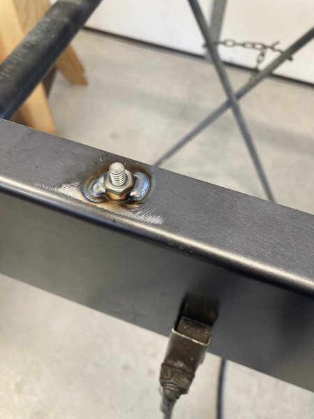

Today I marked out where the holes needed to be to bolt the tank to the nest. Drilled them out, ground off the burrs, ground the welds in the inner corners. Rustled up 15 1/4" bolts, got the flange nuts on, welded the nuts to the nest. Also here is a picture of the somewhat finished filter unit.
