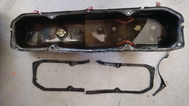

1971 383 brought to life after a 20+ year snooze. Engine has been idled for a max of 10 minutes across the past few days; 1 minute here, 2 minutes there.... oil pressure in the low 30s. Has started right up each time previously.
Ran the motor for 1 minute today, verified some gauges, shut off. Attempted a restart 10 minutes later and the right side valve cover gasket blew out explosively...sounded like a shotgun went off in the garage. Valve cover is physically bowed out from the pressure. Wife ran to garage to see if she was finally going to get some life insurance money.... is not impressed with my garage shenanigans. Removed valve cover gasket is (minimum) 20+ years old and in shabby condition. Oil breather is NOT clogged, flows freely. See pics.
Anybody ever experienced something like this? Valve cover is removed. Anything I should be checking/eyeballing before I throw new gaskets on and try another start?

I've seen valley pan gaskets do that from gas, gas/fumes in oil. When was the last time the oil was changed? Running it such a short period of time, it may not be getting up to temp to burn things off.
I'm gonna go out in left field on this one, so please excuse me! Once back in my race days
we blew the oil pan off the car and did the same thing to our valve covers because of a hole burned in the piston.
Gas could have gotten in the oil pan and combusted???? Something unusual made your valve covers "Explode"!

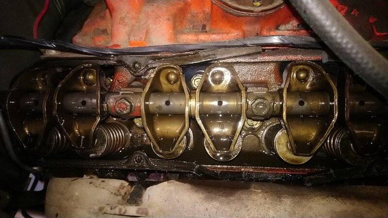

I blew out the valley pan and the valve covers from a hole in the piston. Sounded like a grenade! do a compression test. If theres a hole you will know right away. Maybe from sitting gas leaked into the pan? PS your rocker shafts are on upside down.
I'd do a compression check if ok change the oil. Don't do that minute a couple minutes here and there unless there's a reason you can't warm it up.

I'm surprised you had 30 psi oil pressure with the rocker shaft upside down, that's a lot of open area for pressure to be lost.
Oil flow is controlled at cam bearing so not open to drop pressure
