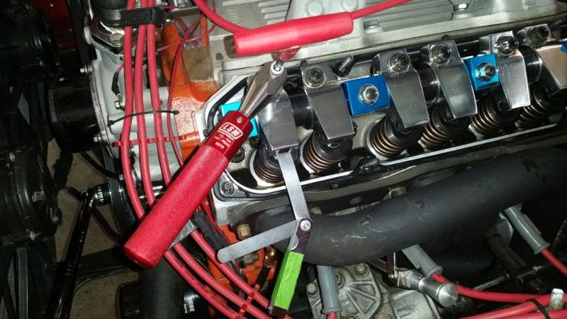

I have this LSM tool for setting valve lash.
It is a pint sized click-click torque wrench pre-set at 20lbs, which is pretty standard for the torque on your rocker arms.
It comes with various size t-handle allen wrenches which fit the different lock nuts.
It makes setting the valve lash easier and you know you have the right torque. I tighten the lock nut down until the tool "clicks" then give it about another 1/8 turn. Works great.
Summit and Jegs have it.
It is a pint sized click-click torque wrench pre-set at 20lbs, I tighten the lock nut down until the tool "clicks" then give it about another 1/8 turn. Works great.
Great tool. Once it clicks it's reached 20lb/ft. Anymore movement will over torque the adjuster.
Doug
So, Doug...are you saying I should just tighten until the wrench "clicks" and then NOT nudge it another 1/8 turn. Let me know, thanks, mike
Yes, it clicks at the preset torque.
Doug
I thought it was 22lbs? I have that tool as well and love it! I use it for tightening spark plugs on the hemi after lashing valves too. Made in USA. Its a quality piece of equipment.
TQ-100 Valve Lash Adjusting Torque Wrench and when to stop pulling: The tool will not make a "click" sound, but you will feel a "break" when pulled to the right torque. The tool is set to 22 ft/lbs, but because of the short handle it will feel a lot higher - just keep pulling. For practice you can put a bolt in a vice to get a feel of the "break". Just remember to make sure your socket is fully engaged so you do not strip the torque head. LSM Valve Lash Adjusting Wrenches
You are right...my LSM tool does NOT make a click sound...it does "break" when at the right torque.
