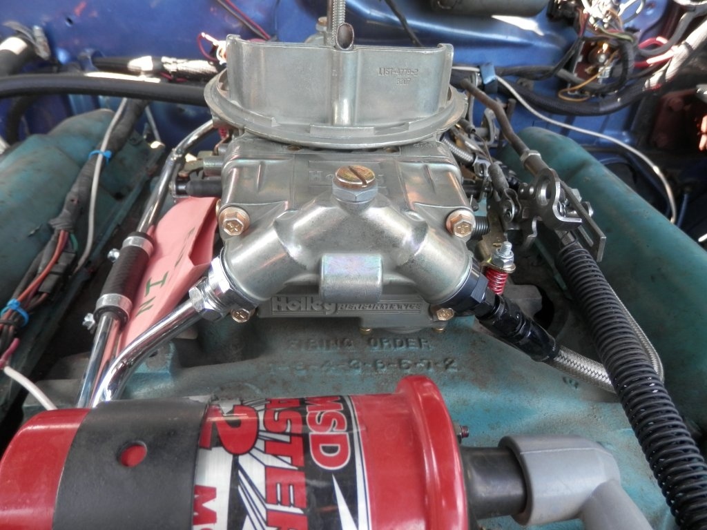

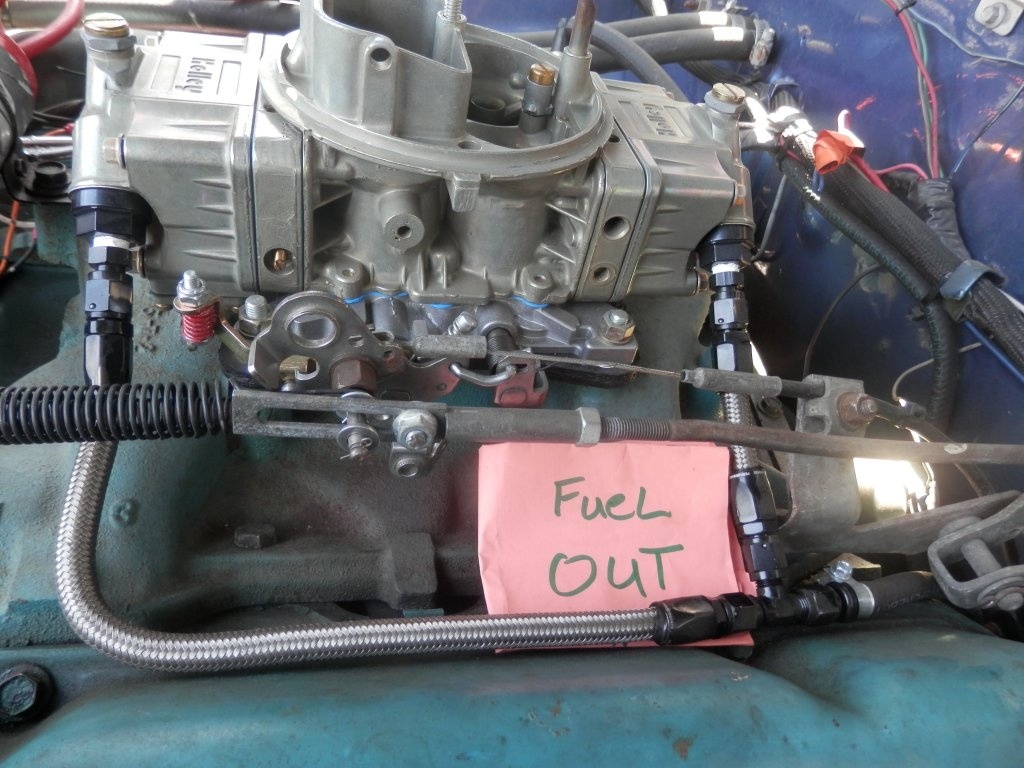

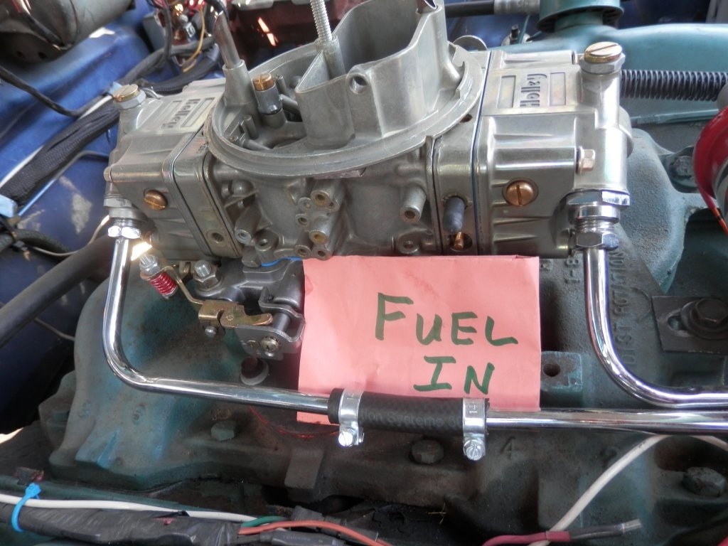

Same here, only issues at this point is some gas smell in garage and it's not that bad. Car never died on me or wouldn't start, the things I did are more precautionary, only thing left that I can do is block my heat risers.
Hawk is correct though, fuel injection with timing control is the way to go for best of everything drivability and a completely closed system.
