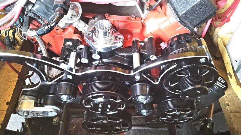

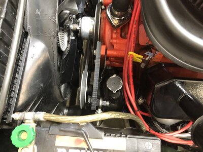

I like the way you put the compressor under the alternator. How hard was that and where do you get the brackets needed?
it took me 12 hr to fab the brackets. taking the compressor in and out many times i bought a chevy big block bracket kit from vintage air then made 2 new brackets with out the slide hole with 1 hole to keep in place then used cvf pulleys and brackets and idler pulley i got the idea from 5.7 hemi and his build .but the main bracket bolts up to where the fuel pump on block as i have the pro-flow 4 so i dont use the factory fuel pump. i have 650.00 in parts for this pulley system

there is a bracket to mount where the power steering pump would go . i have 1900.00 in the a/c kit plus the pulleys and extra brackets

the a/c mount for the power steering is from vintage air as well as the lower mount i used . look on there site under brackets they have a lot so look around there a lot there.
if you want to do what i did buy the chevy lower mount for long water pump. then install the main bracket to the fuel pump mount on the block. then take the bracket and lay it on a piece of 1/4 thick mettle [ same as the supplied bracket] then cut out 2 of the brackets . lay then on top of one another clamp them together and drill 2 of the mounting holes and drill them these are for the compressor side then for the block side it gets a litter tricky.

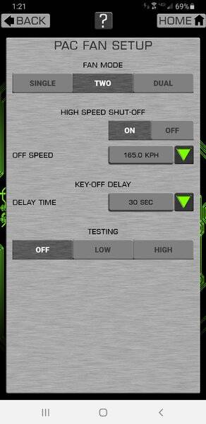

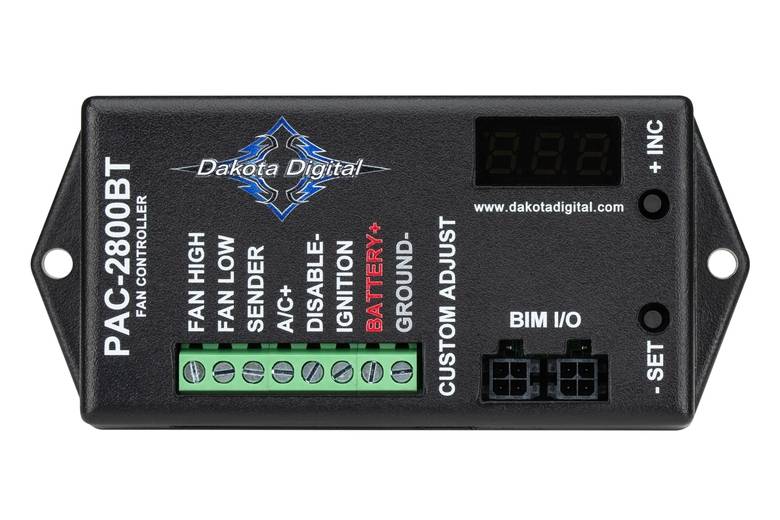

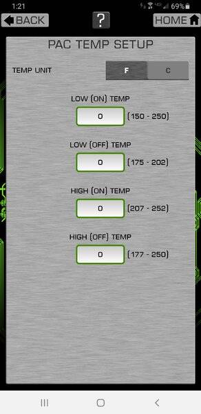

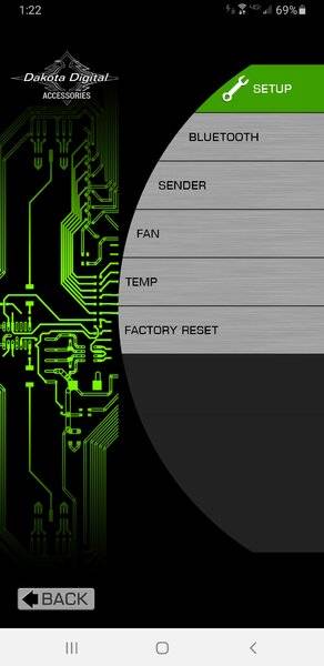

My installer says electric, and I'm ok with that. Radiator not in the car yet, but I don't think I'll have room for the clutch fan, which he and I originally wanted to use. I am fine with that, and I already ordered the Dakota Digital PAC-2800BT electronic fan(s) control module. It comes with a 70 amp relay, and I'm going to add a 2nd one so each fan has its own relay and power circuit.
The app for the module is pretty cool too.
https://www.dakotadigital.com/index...id=1207/category_id=403/mode=prod/prd1207.htm
