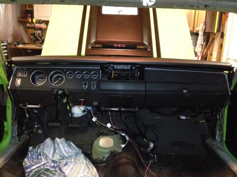

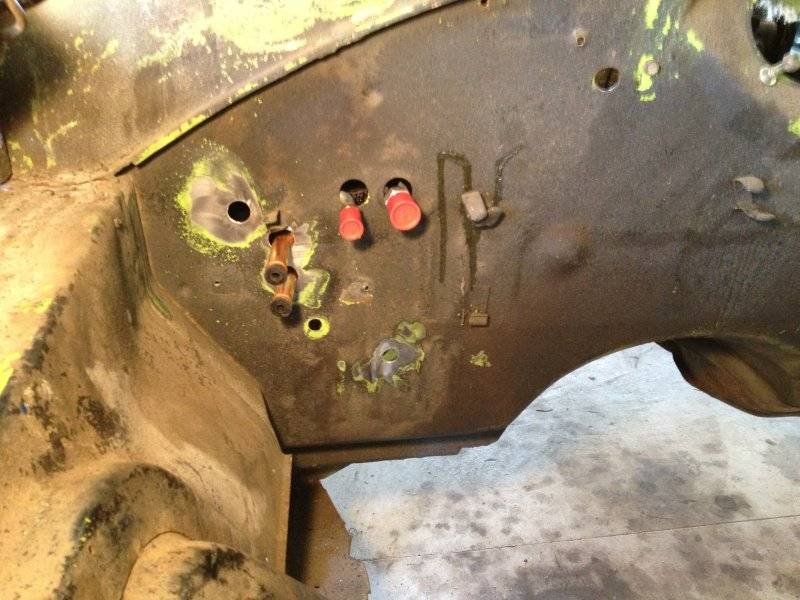

That's tight. I installed the Classic Air in the Coronet. The car was apart and the dash was out so it was an easy install.

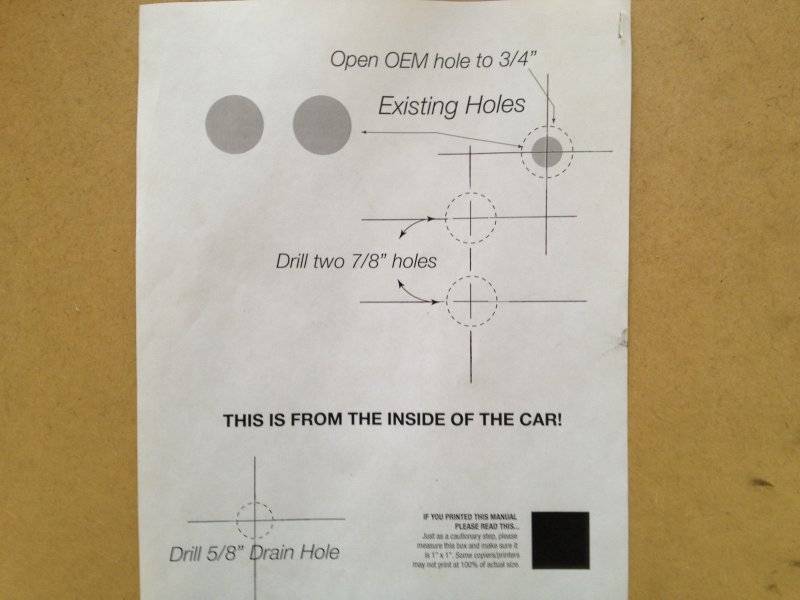

The CA came with a paper template that aligned with the OEM holes, to mark the new holes.
As you said, the tubes poked out of the firewall so it was just a matter of hooking up the lines. There's also a hole for the condensation hose.

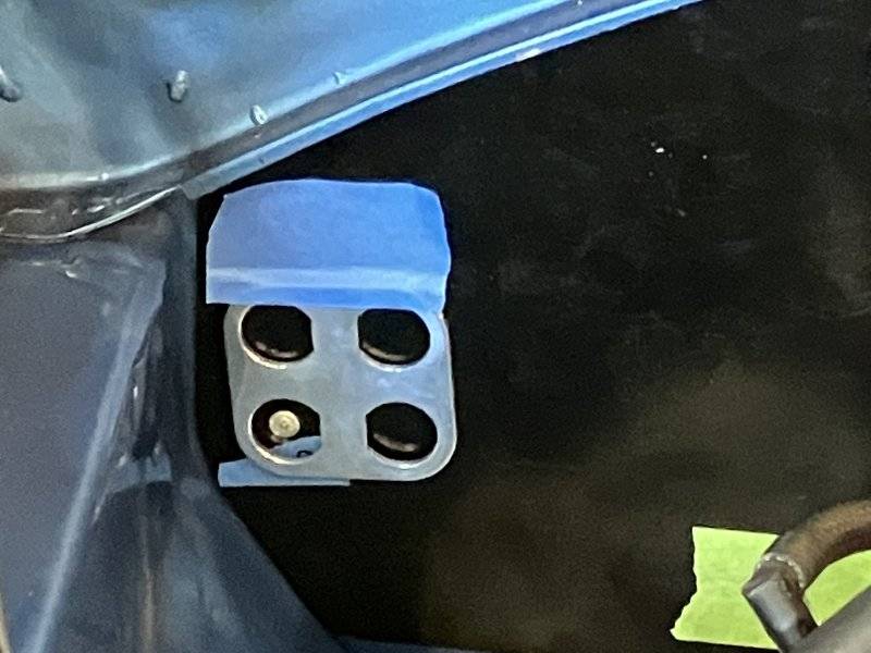

I get that, I've posed the option to the owner as well. The current plan is to use this plate but to paint it body color so it blends in. It could be left off, nothing is set in stone at this point. The advantage of using it is that it covers a few holes in the firewall including the original heater hose holes.

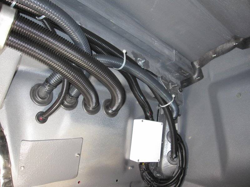

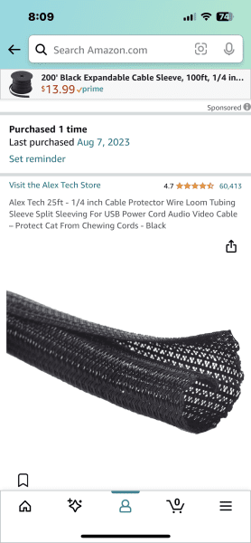

Yeah I put my sniper harness and vintage harness through my heater hose holes with these and plugged the rest and used some good wire loom to cover it.

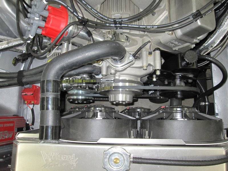

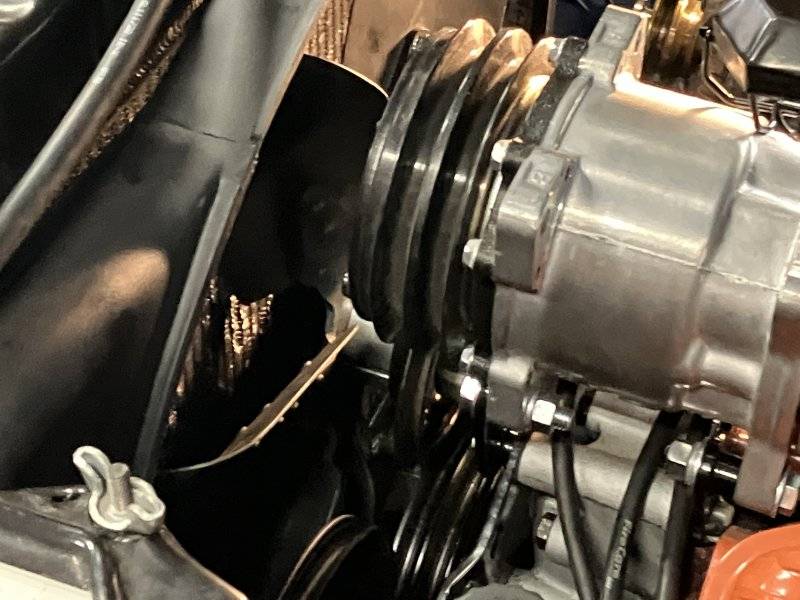

Vintage Air and Classic Auto Air both offer kits that put the A/C compressor in the stock location, allowing the use of stock length belts. One snag I found...Aluminum water pump housings place the thermostat housing slightly higher so the brackets to mount the compressor are slightly different. When ordering your kit make note of this. In my opinion, they should just default to the taller brackets so they fit every application. They may have a reason for having them different that I'm unaware of.
The compressor has four equally spaced mounting holes that allow the installer to clock the unit around to a favorable position and to aim the lines at 9:00, Noon or 3:00. For my car, I chose 9:00. I did the same here.

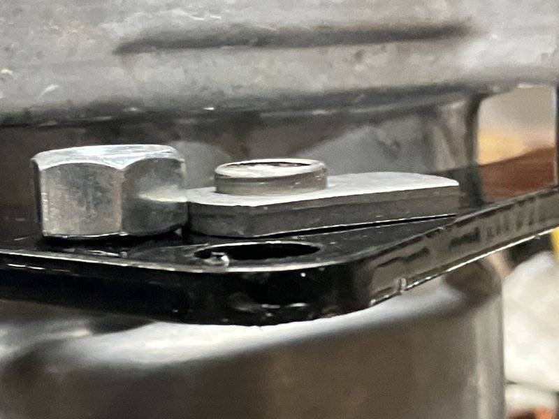

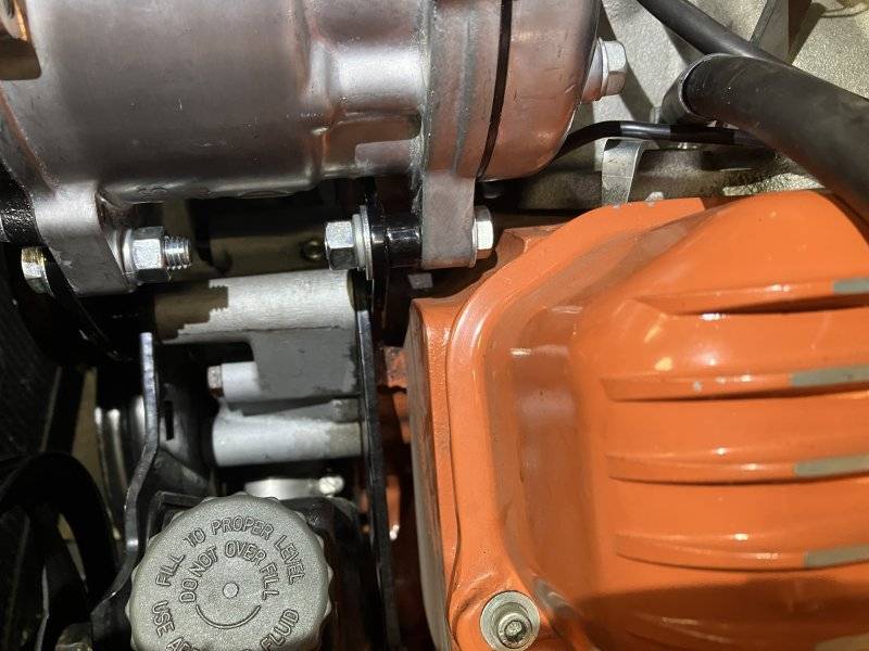

One snag that occurred in both installations. The mounting bolt that shares the bracket for the power steering pump normally threads into a welded on nut at the back of the P/S pump bracket. The A/C bracket needs to lie there so the welded nut comes off.

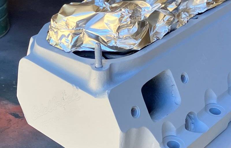

To secure the bolt, you'll need to finger in a 3/8" nut in a cramped space. Edelbrock heads have a thicker face here that crowds the area more than stock or 440 Source heads. To allow fitment and full bolt thread contact. On this head below, you can see a cut in the corner on the lower LEFT of the picture.

The kit includes the thin nut plate to the right but it didn't look like it would be good enough compared to the thicker stock nut to the left.

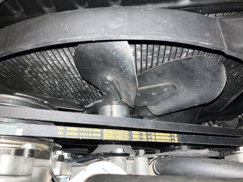

The owner wanted to keep his stock fixed blade fan.
...THEN on a test drive after switching to the A/C pulleys, the faster fan speed made a whooooosh sound that he didn't like. That whoooosh is the trememdous airflow the fan provides using the smaller diameter pulley but at what cost? I am not 100% sure but I suspect that most if not all original A/C cars had fan clutches. The owner wants to swap to the clutch as part of the swap, that is also in the works.

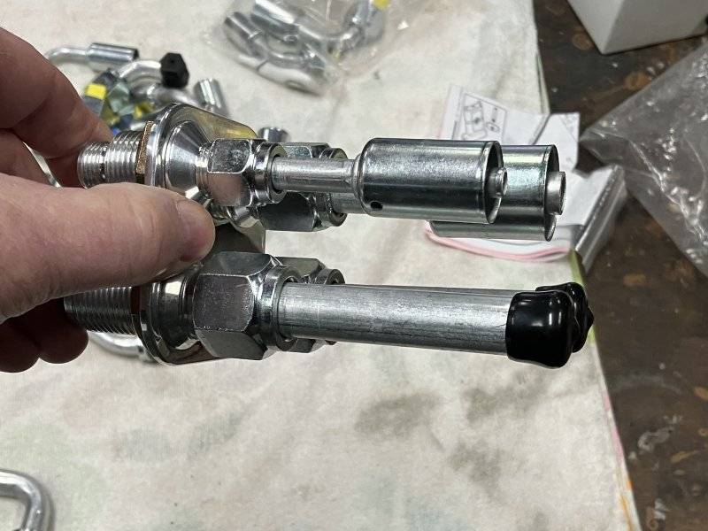

Trying to find fittings for this thing is difficult.
The small one is irrelevant for the moment. I've been trying to identify the thread size and pitch of the large three because I want to buy nipple/barbed fittings for the heater hoses on the interior. All I have is 4" long tubes straight and with a 90 degree elbow bend. They are all too long.
If I had a way to re-flare the fittings, I'd just cut them back and add a flare to the ends so the hoses don't slip off. So far I've only been able to determine that they are 5/8" flare. There are what,,,FOUR grades of pipe and threads now? What a mess.

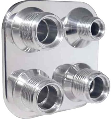

- install straight through firewall passenger side using billet 4 port bulkhead as planned and pictured above in Greg's posts
I've said I prefer to use the firewall buikhead, but no metal has been cut yet, so all options on the table.

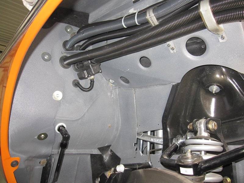

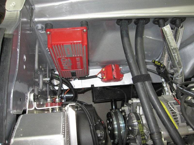

My 65 Belvedere system. I used wire loom for hose protection.
Mike

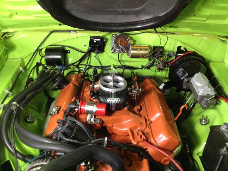

The goal of my car has always been to look as stock as possible while still incorporating a number of modern day touches to make it better.

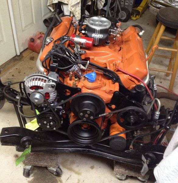

I chose to hide my A/C hoses in plain sight. My compressor sits low (below the alternator) and I simply routed the hoses up and let them "mingle" with the heater hoses. My dryer is mounted near the radiator so it doesn't add additional non-stock stuff under the hood. Below are a couple of pictures for you to evaluate how you like it.
Below is a picture of the engine, prior to installation, for a better idea of the compressor location.
I'm sure it will work great however you do it - good luck!

The low mount A/C compressor means NO mechanical fuel pump since they share the same space. Some, Bouchillon included, claim that the single belt arrangement is at much greater likelihood for slippage. I considered it for the Charger but I have a fuel system with a mechanical pump.

I can't say why it is oriented that way. I simply put the holes where they were needed based on the template Classic Air provided.
Here is the template

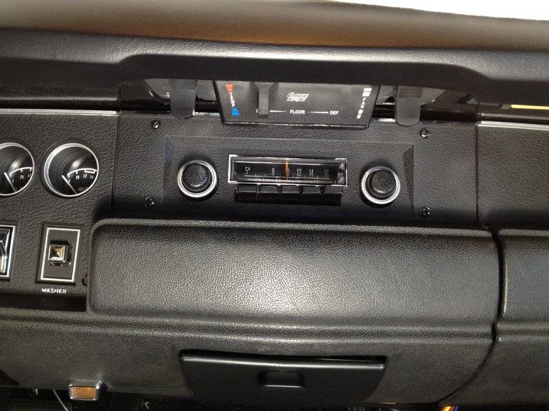

Here are a couple of the heater control box mocked up, inside and out.
Here is one during construction
Here is a closeup of the controls

As Greg said, putting the compressor there means you have to use an electric fuel pump as it sits in the spot where your fuel pump would be.
The belt arrangement sucks, and is a finicky pain in the butt. Once it is set, it seems to work acceptably, but it requires some tinkering to get it right.
